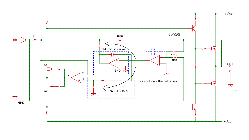

I have made a new amplifier.
So far, plus the following additional content to Prior art that expand the control error.
1.To extract the distortion, it splits into two signals. and, either is for DC servo, the other is Characteristically for distortion feedback.
Frequency characteristics,
When 8.2ohm load (1W) :350KHz.
When 2.2ohm load (3.6W) :200KHz.

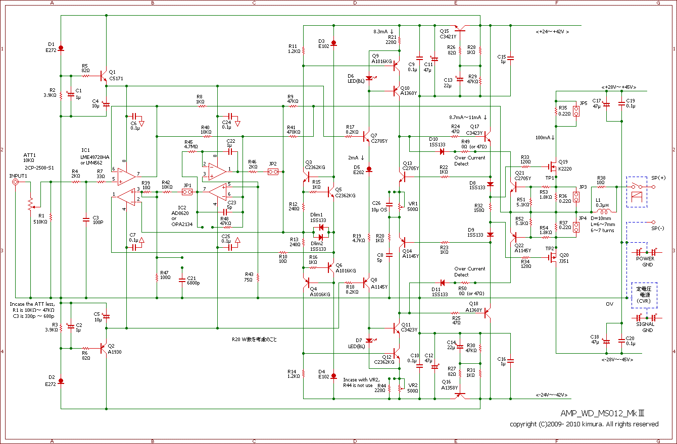

Thank you for your reply.
2SK2221/2SJ352 or 2SK2220/2SJ351 is an updated version of 2SK1058.
Reference URL is put on the following.(Sorry most part is written Japanese)
"http://homepage2.nifty.com/~mhitaste/audiotop/dcamp_parts/dc_ampparts015.html"
I have willingly used 2SK3497/2SJ618 and 2SK1529/2SJ200 that Gm is large up to now.
AMP Mk2_v2
And, they were used without the source resistance. The reason is that it was felt that it still influenced tone quality.
Then, K2220/J351 that the temperature property is negative was adopted. However, because Gm was small, feedback was devised.

Hi ! zeonrider
Hi ! zeonrider
Yes , I think too many parts,too.
It is because there is a purpose of the experiment as the hobby of the electric circuit, too. (I like experiment.....http://www.diyaudio.com/forums/images/smilies/wink.gif)
It is assumed 60W or less based on the radiator and the maximum rating of the electrolysis capacitor obtained easily now.
In the characteristic, the gain hardly falls also on the load 2.2Ω by 20KHz. Therefore, it is expected that a large speaker can be driven enough.
Regards

Nice project, but only 2 output TR-s,& too meny others!
What about otputput power?

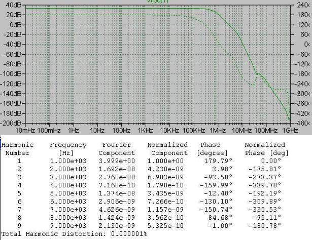

Measurement result postscript
Hi
Measurement result ,postscript
THD+N : 1KHz Less than 0.02% (Measuring limit of my equipment)
http://www2.plala.or.jp/puthoff/photo_mk3/MK3_hizumi.GIF
DF :360
(I think largeness in single PP of MOS FET. )
