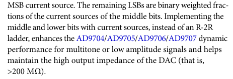

I just downloaded their preliminary datasheet and it puzzles me. Any of you DAC experts out there have an answer to this?
The architecture is R-2R ladder yet the output impedance is 400Mohm. I've never seen such a high output impedance from an R-2R part before. What are they doing differently?
The dynamic range figure of 125dB means they're achieving 13dB improvement over the PCM1704. Not to be sniffed at if it turns out to be real 🙂
mili Ohm maybe 🙂
Even my DC laboratory current sources didn't have that.
Let's see... +/- 15.5mA is 31mA swing at full scale. To obtain 400 MegOhm at FS would need a voltage of: 400 x 10e6 x 31 x 10e-3 =12400 x 10e3 Volts. 12.4MV. Something like a lighting bolt.
I think they are calculating something like 1 LSB swing...
No, their compliance voltage is +/-310mV (620mV) on maximum two 20 ohm (40 ohm) resistor... That's very good (on paper) and might give finally something to do brag about to the passive I/V fans 🙂
Of course was a joke. I know to calculate just the Full Scale output impedance.
The "dynamic performance" is similar with PMPO power - everybody claims it but no details on how is calculated.
Actually there are details on dynamic performance in the realm of communications. I posted up a link about a week ago on another thread (Sound quality vs measurements) to an article by a guy from ADI. In essence you need to test with a higher crest factor signal than a pure sinewave - multitone for example.
