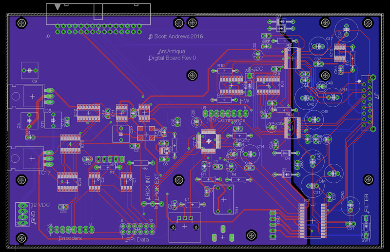

Hello everyone. It' been a while since I posted here. Been very busy on this project.
After reading through the various threads and white papers on digital attenuation, we decided to go with a digitally controlled external analog attenuator. For now we're using the TI PGA2310. I may experiment with the ESS 32 bit internal DAC at some point too, and maybe try a comparison. Doing the attenuator after the DAC prevents mucking up the dynamic range. We have 24 bits to work with, but I'd rather not be running that and a 16 or less bit equivalent for normal listening levels. Using the post-attenuator, we can load the DAC at 100%, and get all 24 bits of resolutions and then lose a little into the analog noise floor at high attenuation levels.
The PGA 2310 is an interesting device. It uses a 16 bit three-wire serial digital control. This is actually two series connected 8-bit controls, so you get 256 1/2 dB steps. The digital control words are clocked into the device serially, and then committed to the device (i.e. the attenuation value gets set) by a third line. The first 8 bits control the volume of one channel, and the second 8-bits control the other channel.
This approach also allows us to control the relative attenuation value for each channel independently, so we can use it for volume (all bits change by the same amount), L/R balance (offset A and B channels) or as an HF/LF balance adjustment.
I am using a PIC controller to read digital rotary (I-Q) encoders for volume, balance and EQ (and also source selection.. ). The changes to the encoder knobs get converted to four volume values in the PIC, and I can then offset them for balance, or shift them up and down to control volume. For each step of the encoder the PIC computes the new values and then clocks the new set of bits out to the attenuators.
Using this approach, I am also able to receive a volume request from the Raspberry Pi controller over I2C (I am using a PIC with an I2C interface), and provide a volume reading back to the RPI(for example to show the volume on a volume slide bard on a table or phone).
So, I can turn a knob on the box and change the volume, and that will show up on the RPi display, or I can change the volume by sliding the controller on the RPi display and the volume on the box changes. I also worked out a log step scheme so we can ramp the volume down to fade when changing sources, etc. Really liking how easy the PIC is to work with..once you get over the basic learning curve!
