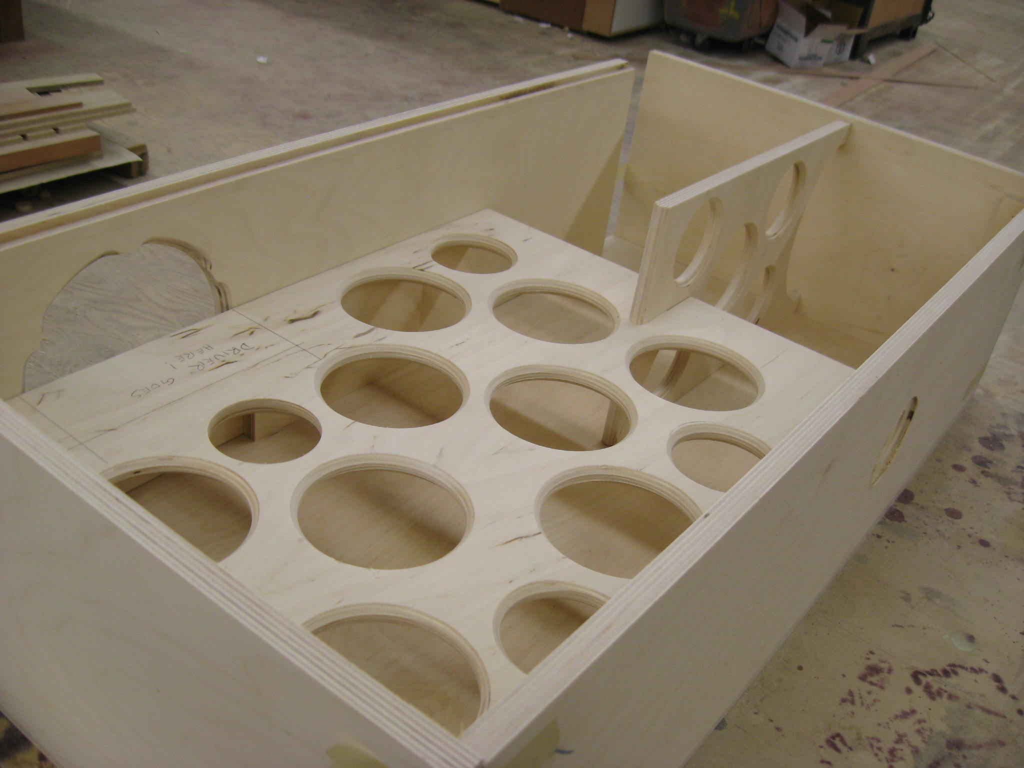

Earl - air enough - in the case of vented motor assemblies (not all are), any longitudinal bracing member is either offset or notched to prevent blocking the vent. Attached is a photo of early parts dry fit stage of a build for an 8" full range unit. Note the markings indicating "driver goes here". In this particular case, the rear panel was later set on cleats to be removable for adjusting of internal damping material fill levels by ear.
Your parts don't look damped at all to me. I don't see how you could do that. To me damping is more important than stiffness. My bracing probably doesn't stiffen the panels very much, but it damps like crazy.

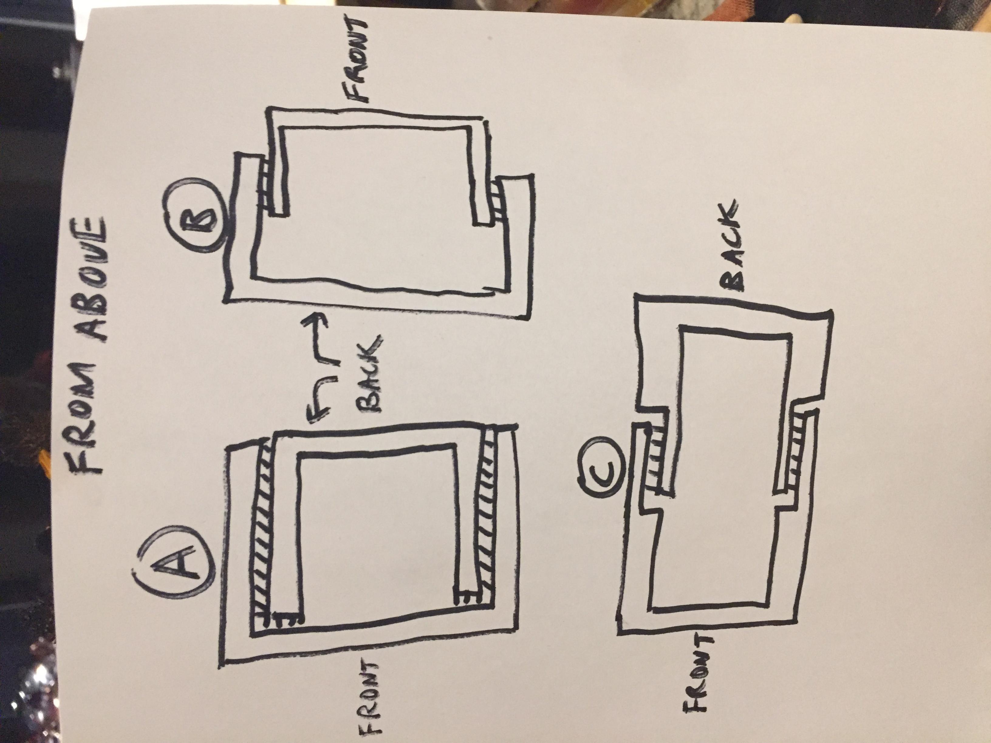

Earl, have you tried making cabinet walls using your method? For example, could side panels be made up of two full pieces that overalp? One piece of the side panel
could be attached to the front panel, and the other part of the side panel could be connected to the rear panel. The top and bottom panels could be attached to the rear and front panels, or the side panels. There are a number of possibilities for attaching overlapping panels. I don't think it would require full panel overlap to have it work. Also, I don't think you would need to do all the panels.
As you say, there are a number of possibilities and only a drawing would clearly outline what you mean.
In my CLD the inner boards basically float. They are not attached to anything, just glued on pieces that damp in shear.
A. This is the general idea, as seen from above the cabinet and not showing the top. The damping layer is sandwiched between the two pieces that make up the side panels of the cabinet.
B. I think that something like this would be enough.
C. Another way of doing it.
Here are before and after drawings....
First it is important to understand what it is one is trying to do. I try and dampen the cabinet walls with CLD and damped cross bracing. The two largest panels, the front and back, are the biggest concern since they have the largest area, so I use CLD on those. My cross bracing is meant to dampen the side walls and the front to back motion of the largest panels. The top panel is too small to be of much concern and the bottom is ridged from placement. Your designs do not dampen either of the front/back panels, so they would not suite my needs. They will dampen the side panels well, but those are of a lessor concern.
The way its shown the cabinet would actually grow and shrink under the internal pressure. This is usually not a good thing since now the cabinet is radiating sound as a monopole, which is very efficient. This effect would be very well damped however so it might not be a major issue. I would expect it to act like a box larger than it really is that would increase the driver Q.
