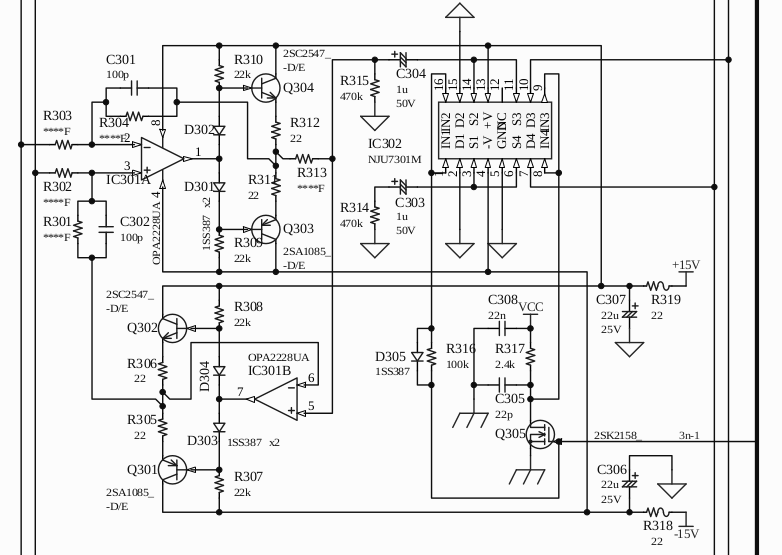

Isn't this just a sort of discrete current switching DAC??
Jan
Yes, but apparently with a transadmittance amplifier for each switch, so switch resistance variations with signal cause even less distortion than in a normal multiplying DAC loaded by a virtual ground. Unfortunately the schematics in the patent and in the brochure don't provide any information about those amplifiers other than that they exist.

You can search the schematic of Accuphase C2810 Preamp to see the implementation of this circuit. Just Google Accuphase C-2810 service manual and you can see it, don't need to guess
You are surely not expecting me to believe that some high-end audio deliberately degrades performance in order to enhance marketing?

I don't know where you are, I can't get to that service manual. Do you have a specific link please?

Thanks! It's another model, but with the same kind of volume control.
One unit transadmittance amplifier is shown in the attachment. They use a low-offset low-bias-current op-amp to force the signal voltage across R313. Whatever offset current there still may be is conducted to ground via R315 and C304 conducts the signal current to the switch.
That answers the questions I had: the AC coupling eliminates the offset, there is no bias current source noise added to the output signal with this topology and the fact that R315 reduces the impedance that drives the switch is taken for granted.
