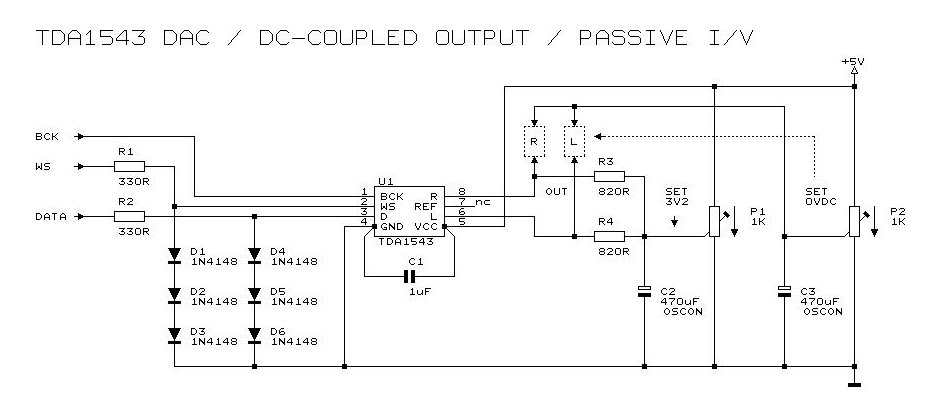

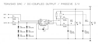

With 16 parallel dacs at 2.3mA p-p the total current is 36.8mA p-p, with 150 ohms i/v resistor you have slightly over 2Vrms.
Another option is the attached schematic from John (ECDesigns) which can be modified for 16 chips in parallel.
It lacks a low jitter clocking scheme. But what the heck, the transformers and case are almost worth the price?
Alexandre, what would the best option of modifying the schematics from #11 to connect paralleled chips? Just by connecting them in parallel but divide R3 and R4 values by number of used chips?
