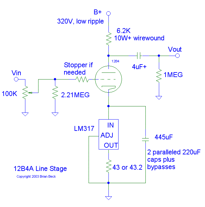

I want to build a 12B4. Since I am a college student without a steady income, I need to keep the costs down, which I was assured was possible in another thread I started.I have read through a lot of a thread started by Mark A. Gulbrandsen called "Yet another 12B4 line stage, or is the 12B4 better than the Grounded Grid." After my reading I emerged more confused.
I am uncertain about a couple of things to start with, namely the favored schematic. I read that Brian Beck's is a definite upgrade over the original, but that there were some electrolytic caps that needed to be bypassed by decent filmcaps for a preamp application. Along with the schematic comes the need for a PS schematic. Since I am new at all this, I am not really sure how to make a schematic out of all the instructions people give, so I am wondering if there are schematics out there for what I am looking for.

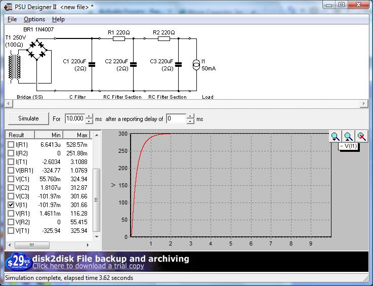

Hi, I would suggest you use 2 x VR150 voltage regulator tubes to give you 300V. I'm not sure how expensive those are in your area, but they're cheap here where I am. They also give you a nice purple glow, and that's a conversation piece. This is very simple to implement compared to that circuit you posted.
I'd use SS rectifiers and a couple of 450V (CRCRC) capacitors before the VR150, to keep costs down.
I can make you a schematic for this.
We will need to know how you'd be operating you 12B4, so that we can determine the current requirements for the PSU.
If you're leaning towards Brian's LM317 CCS cathode configuration, you can use decent Illinois film capacitors to bypass the electrolytic. Illinois caps are not that expensive.

Thanks for the reply. I would love to see a schematic since I don't really understand the operation of these tubes. Also, I have seen the notation CRCRC before, but I am not 100% clear on what this refers to. I have dealt with RLC circuits in my analysis course, so I am assuming it is a network of caps and resistors of some sort, but it would be great to learn more about what these different configurations refer to.

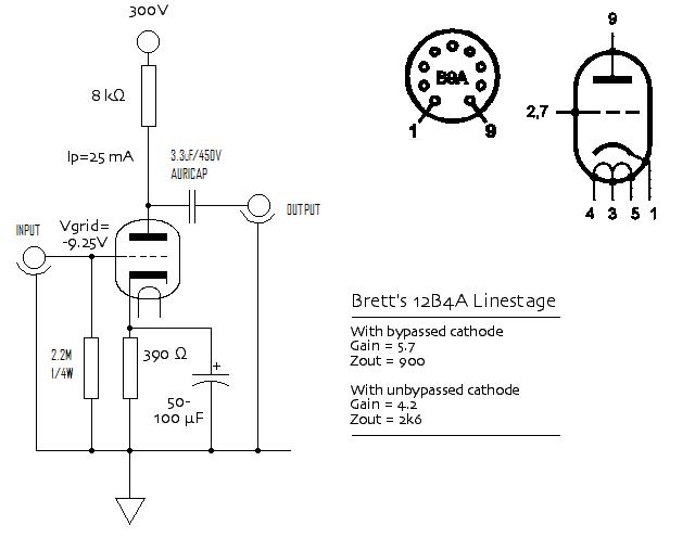

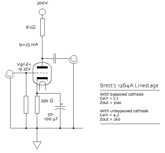

planet10,
Thanks for the schematic (the first one). It raises a couple of questions for me:
1. There is one unlabeled resistor and one unlabeled capacitor, what the required values for these components?
2. I assume I am getting ahead of myself here, but what is the pin configuration of the 12B4? How does that correspond to this diagram?
3. I am assuming that the open/closed circles on the right and left upper corners are refering to inputs/outputs, if so, which is which?
Thanks!
Colin
The second is very much clearer to me, but I still have a couple of questions now. A previous poster mentioned using two VR150s to acheive 300V while giving a cool purple glow effect (which is very appealing to me 🙂 ). I notice that Brian's schematic requires 320V in, so is there a way that I could create 320V using these neat purple-glowing-tubes while keeping the cost at a minimum? Or am I already getting too far ahead of myself and should I just get back to a more simple SS power supply for my first try?
Also, when you say bypass the electrolytics does that mean to just altogether leave them out and use a film cap in their place? What is the purpose of this?
Bypassing the elecrolytics does not mean to leave them out, it means to place a small valued film cap in parallel. Higher value caps tend not to work as well at higher frequencies so the lower value film caps are used to improve performance.
A small value bypass cap across a 220uF power supply cap will help to eliminate high frequency noise from the rectifier or wall supply. Similarly there can be high frequency noise generated by a CCS which can be eliminated with a bypass cap.
Generally a cap a couple of orders of magnitude less than the initial capacitance can be used, probably a 1uF film cap would be appropriate for 100uF or 220uF electrolytics.
Some diy'ers swear by multiple bypass caps, i.e. 100uF bypassed by 1uF bypassed by 10nF for example. Never tried it to that degree myself though.

Yup, start with Brett's version. You can't go wrong.

I suggest that you look up the Duncan Amps web page. Download the PSUD program (it's the one Arnoldc used for the power supply schematic). It's free, easy to use, and an excellent introduction to circuit simulation tools. On the Duncan Amp pages, you will also find a link to the TDSL, or Tube Data Sheet Locator. There you will find the data sheets for all the common tubes and many uncommon ones too.
Regarding components, I wouldn't worry about it at this point, as you are operating on a limited budget. Get a decent power supply transformer (not undersized) - it won't be expensive. If you have an electronics surplus store in your area, you can probably find the capacitors and resistors you need. Do a good job on the chassis layout and leave plenty of room and organize your parts neatly. That way, it's easy to play with upgraded components at any future time, including subustituting the current source for the cathode resistor.
