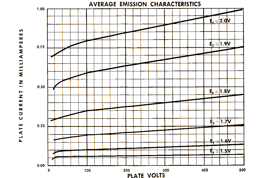

A mystery device
Guess, what it is?

Guess, what it is? ........Looks like some typical sweep tube curves with positive g1 voltages.
It would be a really bad sweep tube if the current only gets to 1 ma with hundreds of volts across the tube.
Unless Wavebourne is screwing with us by changing the names of the terms it looks like the variable here (Vf) is filament voltage. If it can drop 300 volts at 1mA in normal operation without complaints from the user it must operate at a high voltage. My guess is a HV rectifier tube from a TV set. Something like a 1B3 or 3A3 or if we believe the Vf curves a 2X2.
Similar to a GE10/CV5109, a saturated diode? The GE10/CV5109 data sheet has a graph very similar to the one that was posted in the first post.
Didn't Sch3mat1c identify it as such in post #3?
From GE10 / CV5109 : "This is a directly heated tungsten filament diode intended for operation with temperature limited emission. The large change in anode current resulting from a small change in filament voltage together with the stability of the valve make it suitable for use as a control in stabiliser circuits."
As for its purpose, I don't know for sure but I’d guess that it could be used to derive a control signal used to stabilize B+ against variations in heater supply????
drj759 won!
Actually, it is a 2AS15A diode that was used in voltage regulators of measurement instruments. It sensed filament voltage and controlled power tube's grid voltage; power tube controlled magnetic amplifier (like a choke with additional winding to control saturation) to control primary voltage on the transformer. As the result, all voltages were stabilized.
