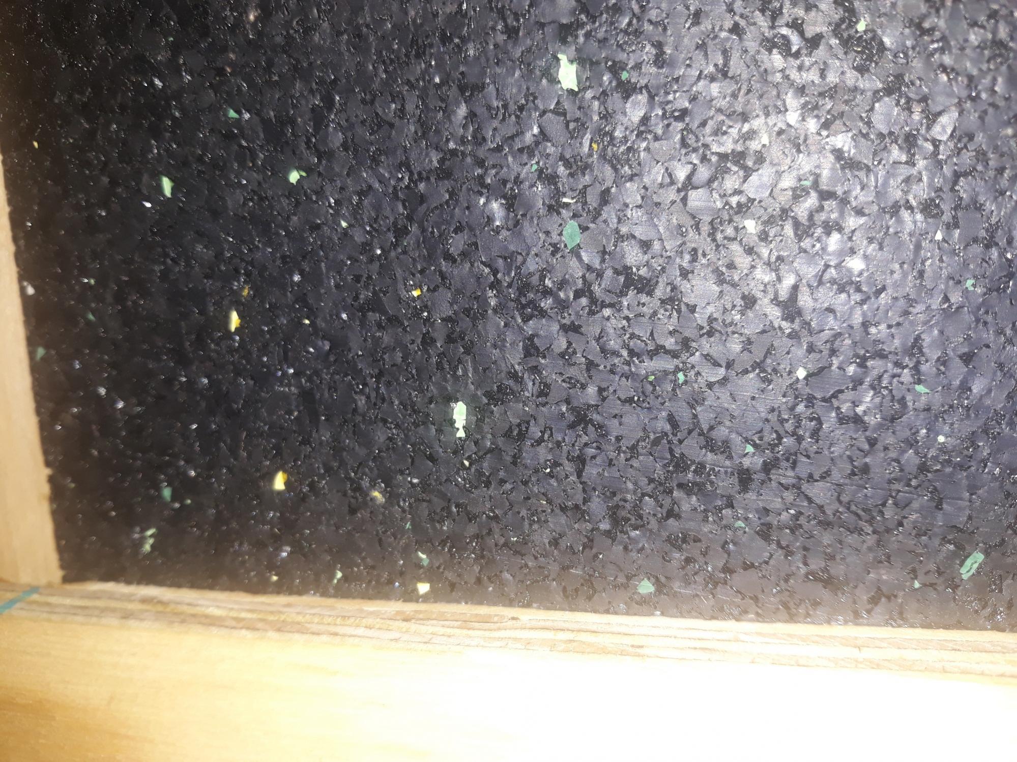

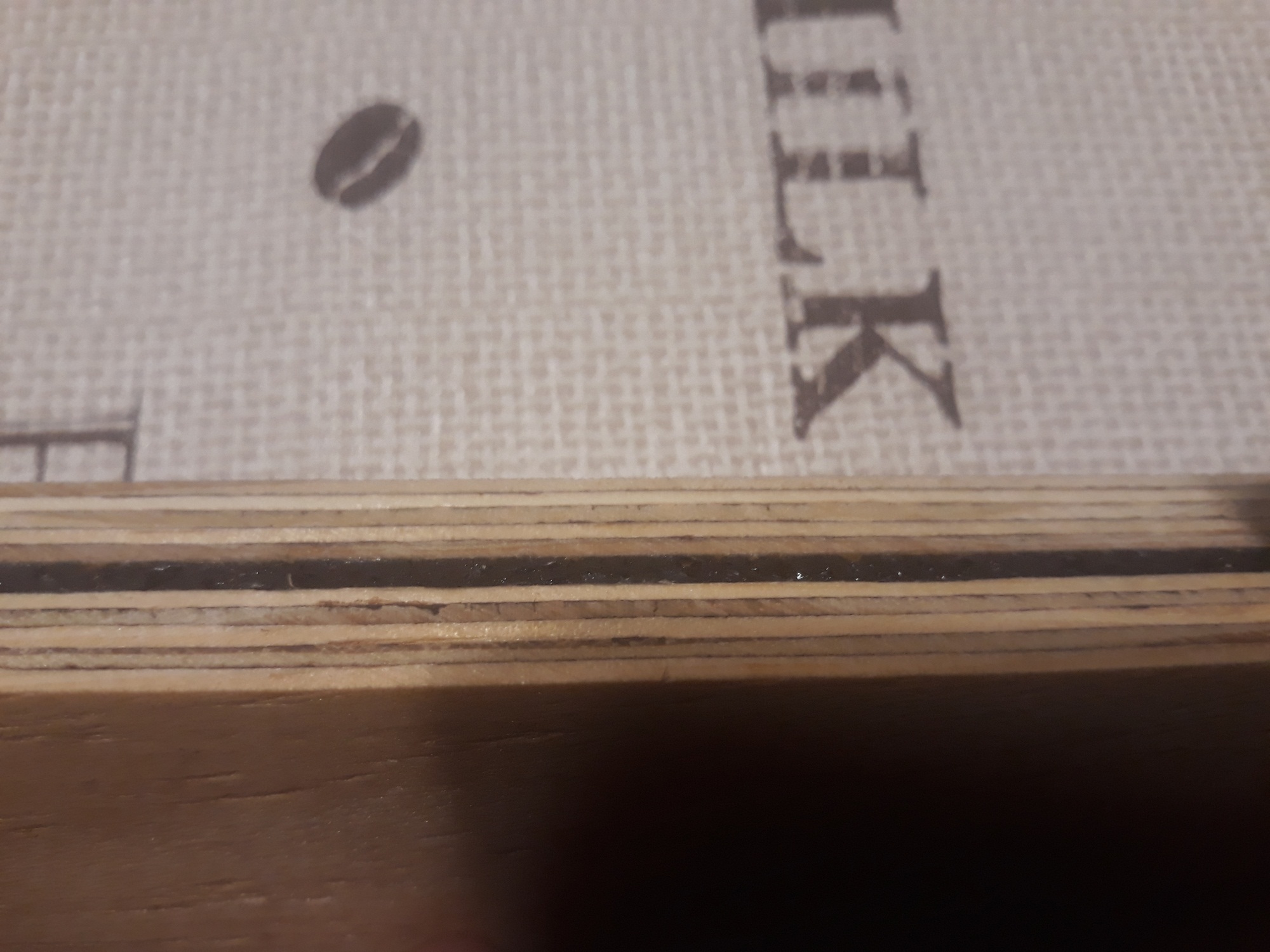

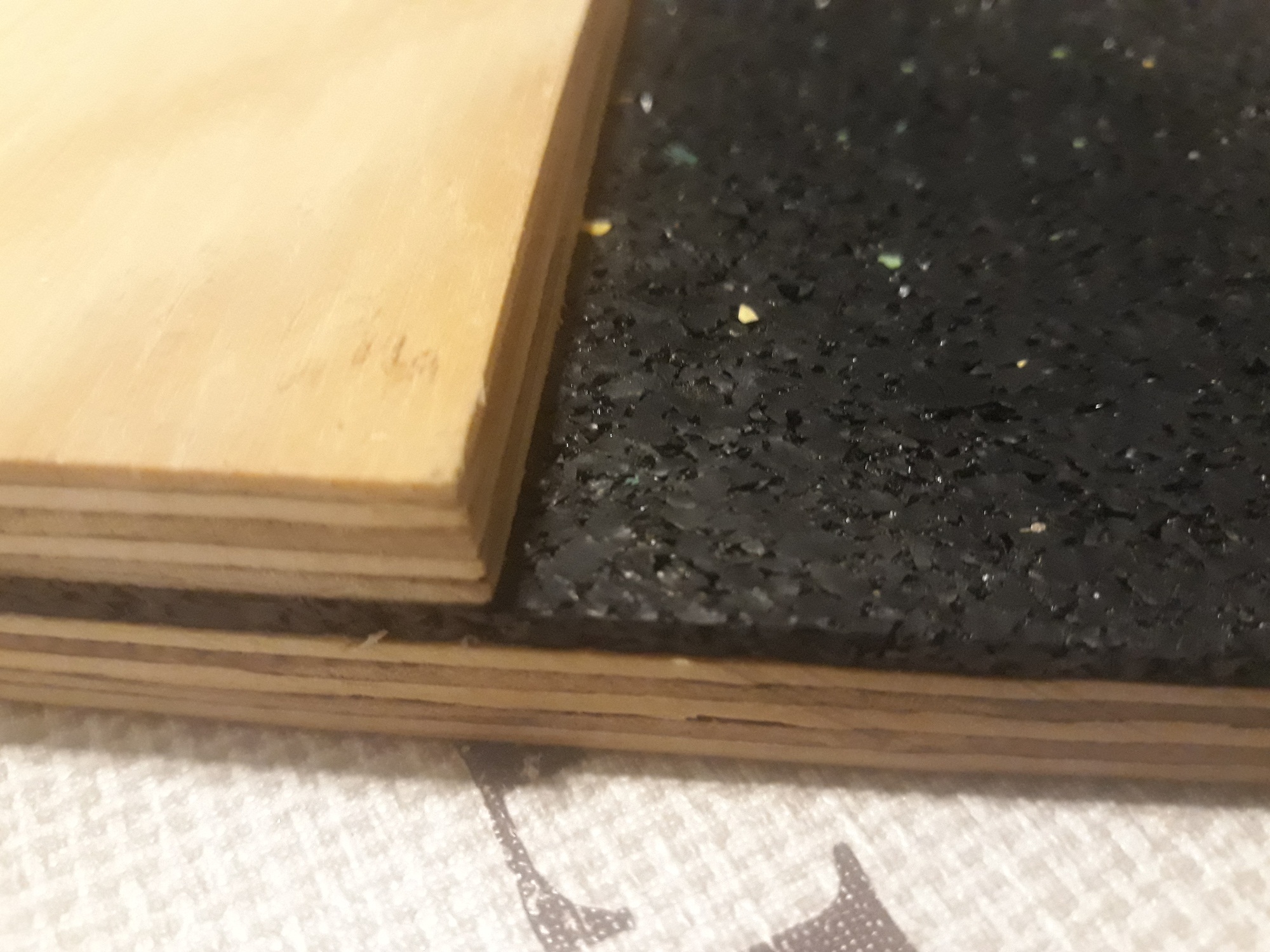

Sheets made of recycled rubber could be tryed. I see its used for sound insulation for floor. I have few sheets and glued them in sandwich to ply. Gluing to ply its easy with wood glue. (waterproof D3)
When I knock on CLD panel made of them, its obviuos that HF content is attenuated.
I found sheets about 3mm thick, dont know is that thinkness widely available.
Sorry, no data 🙂

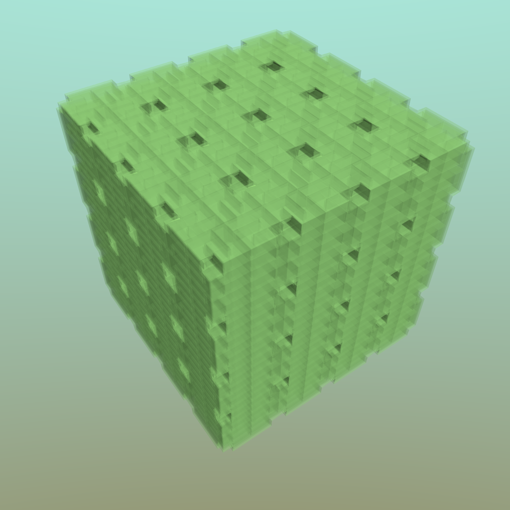

I did a bit of a literature review on broad band acoustic metamaterials and came across some that could be 3d printed pretty easily. The one that seemed most promising to me is (PDF) Three-dimensional labyrinthine acoustic metamaterials It has a simple periodicity and broad band application. The Kef one is tuned to their driver and specific frequency bands, I don't expect to land on that from a quick reading, but maybe some testing of the broadband metamaterials could be interesting?
I think they would have to be on the back wall or suspended in the middle of the cabinet instead of on the driver as the back wave isn't controlled for most drivers in the same way as the Kef modified one. I threw together a 3d model of the one in the literature. 4 of these together could fit behind a 6.5-8" driver and still fit through the driver opening ~140mm.
Had to upload to google drive, 12MB LabiyrinthineAcousticMetamaterial.stl - Google Drive
A lot out there for me still to digest with tapered channels meant to impedance match, band gaps for fractal methods etc.

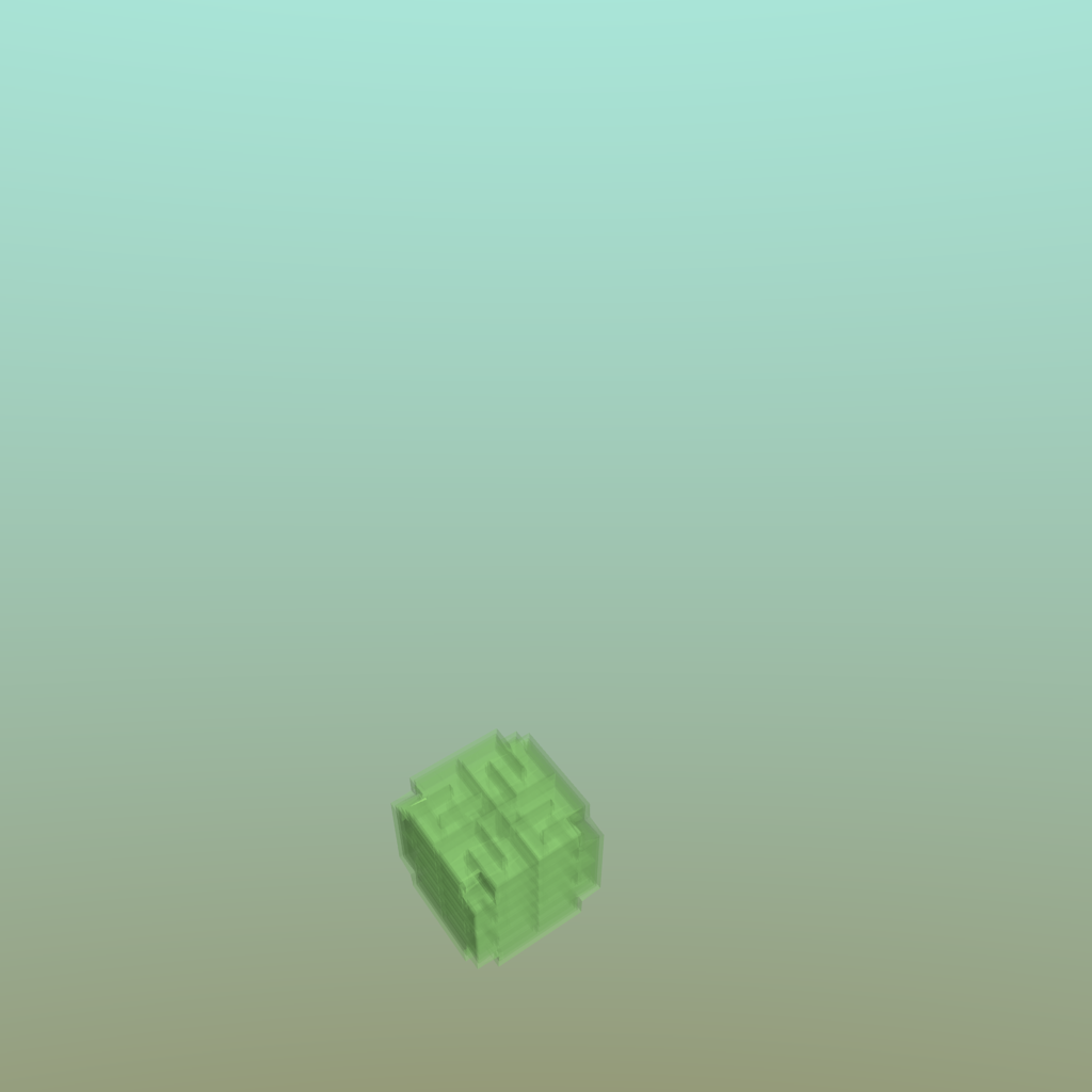

Could you make a large block so I could "slice" a piece out in CAD for whatever size cabinet I might be building?
I sliced the last STL and it would have been a 2+ day print, so cut it down to make it easier. I have a test 1x1x1 unit so you can dial in supports and bridging on a 1 hour print. I would suggest PLA given the amount of bridging unless you have another material dialed in.
LabiyrinthineAcousticMetamaterial_1x1x1.stl - Google Drive
The next one is a 4x4x1 set that should fit through a ~100mm cutout and have a print time of ~14 hours and ~100g. It could be stacked to form a larger surface. The 4x4x4 will require custom supports on the corners and the literature showed a 1-2 unit thick should be adequate.
LabiyrinthineAcousticMetamaterial_4x4x1.stl - Google Drive
As a reference the walls are 0.8mm thick, which typical FDM will be only 2 walls. So If you want to stitch it together you could do it with that offset to merge walls, all of these files are fine to join on any edge. If you are having issues printing at this scale, up-size by 50% should be OK, but will lower filtering frequencies probably.
As to the application if you note in the literature meta-materials are generally placed between the source and a mic. I think it should be spaced away from the back wall. So could do something like Wall|Foam/Polyfill|Metamaterial|Foam/Polyfill or Wall|AirGape|Metamaterial|Faom/Polyfill.
I saw your comment about a bigger one, so made a 16x16x1 sheet that will fill a standard 200x200mm buildplate, another 2+ day print.
LabiyrinthineAcousticMetamaterial_16x16x1.stl - Google Drive
