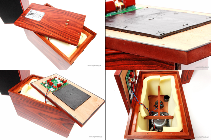

Basotect for damping BR-cabinet?!

How about cork? You can get it at walmart in sheets from 1/4"-1" in thickness. This is all gonna cost augerpro some cash though fellas. How bout we start a little fund to help finance this endeavor?

cork with rubber has one of the best Young Modulus for damping but not structural hardness enough for a bafle or a cabinet, however why not as the external layer of a front baflre. We are off topic, augerpro can not test all,

Rigid with high damping is the ideal cabinet spec. Good to test different ply, MDF, and other rigid cabinet materials. Then structural damping in the form of CLD, such as sikabond, sikabond + microspheres, and other viscoelastic materials. Then internal wave damping like fiberglass, cotton, rockwool, etc.
