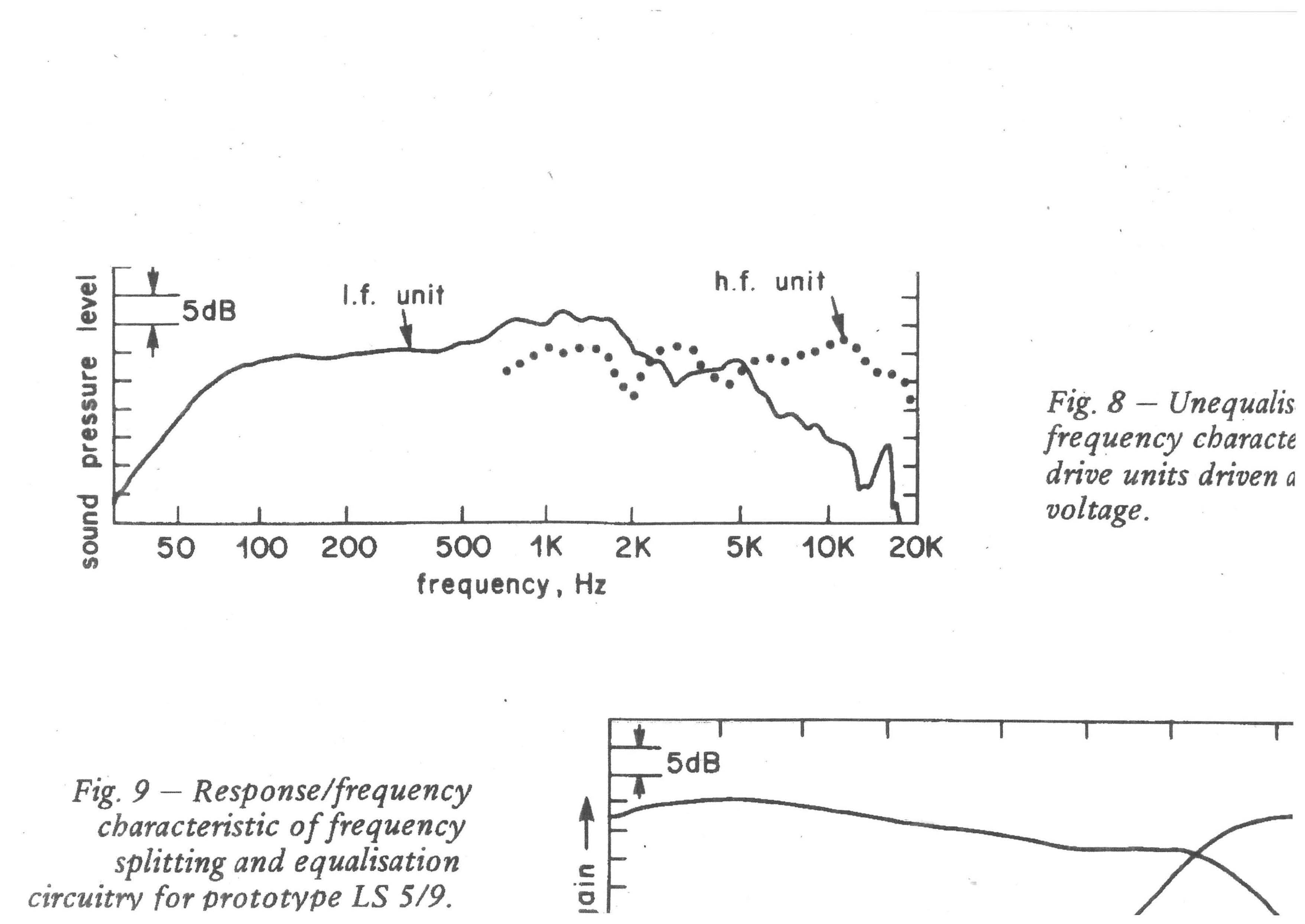

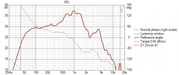

The most challenging part of the design is the baffle step compensation, which looks like gentle slope/shelf from 100Hz to 1000 Hz. The rest, the real LP/HP at approx 2.4kHz, should be a piece of cake. But first of all must I work my way through the BBC document.

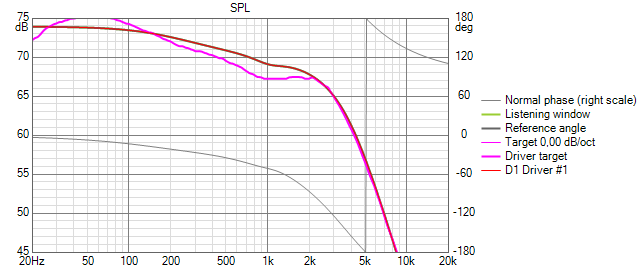

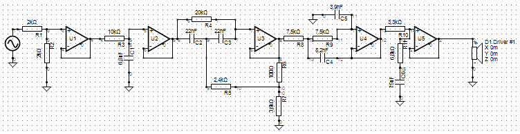

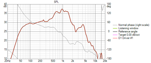

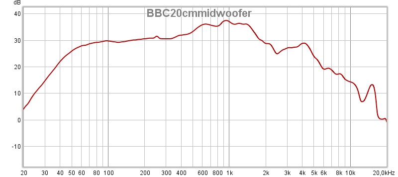

I took the liberty to draw the schematic in Vituixcad. Then I used the Vituixcad SPL tracing tool to check what the transfer function looked like when traced from the BBC picture.
Then I overlaid both the transfer function of Patricks design and the traced BBC curve.

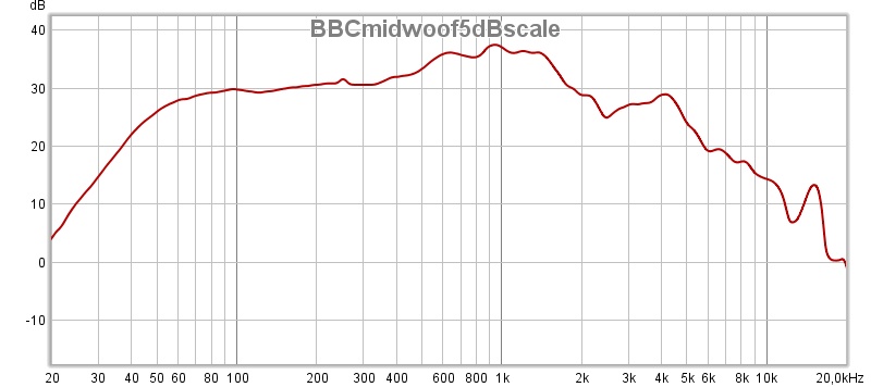

Both from the BBC picture and its tracing, it looks as if the original slope is somewhat steeper than in Patricks emulation of the LS5/9 lowpass. The BBC picture uses a 5dB/div scale, so from 0 dB to 50db max.

Forgot to upload
Well, you can either do 2nd, 3rd, or 4th order, not ?
Or you know how to do 3.5 ?
The LS5/8 was second order with a lower crossover frequency.
The article did mention that the crossover was modified from the LS5/8.
And I read somewhere that LS5/9 was 3rd order.

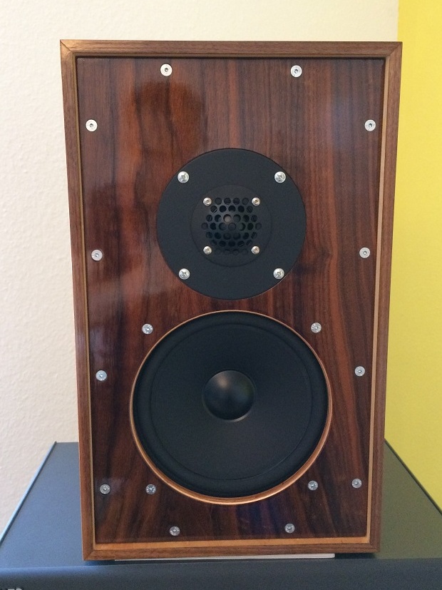

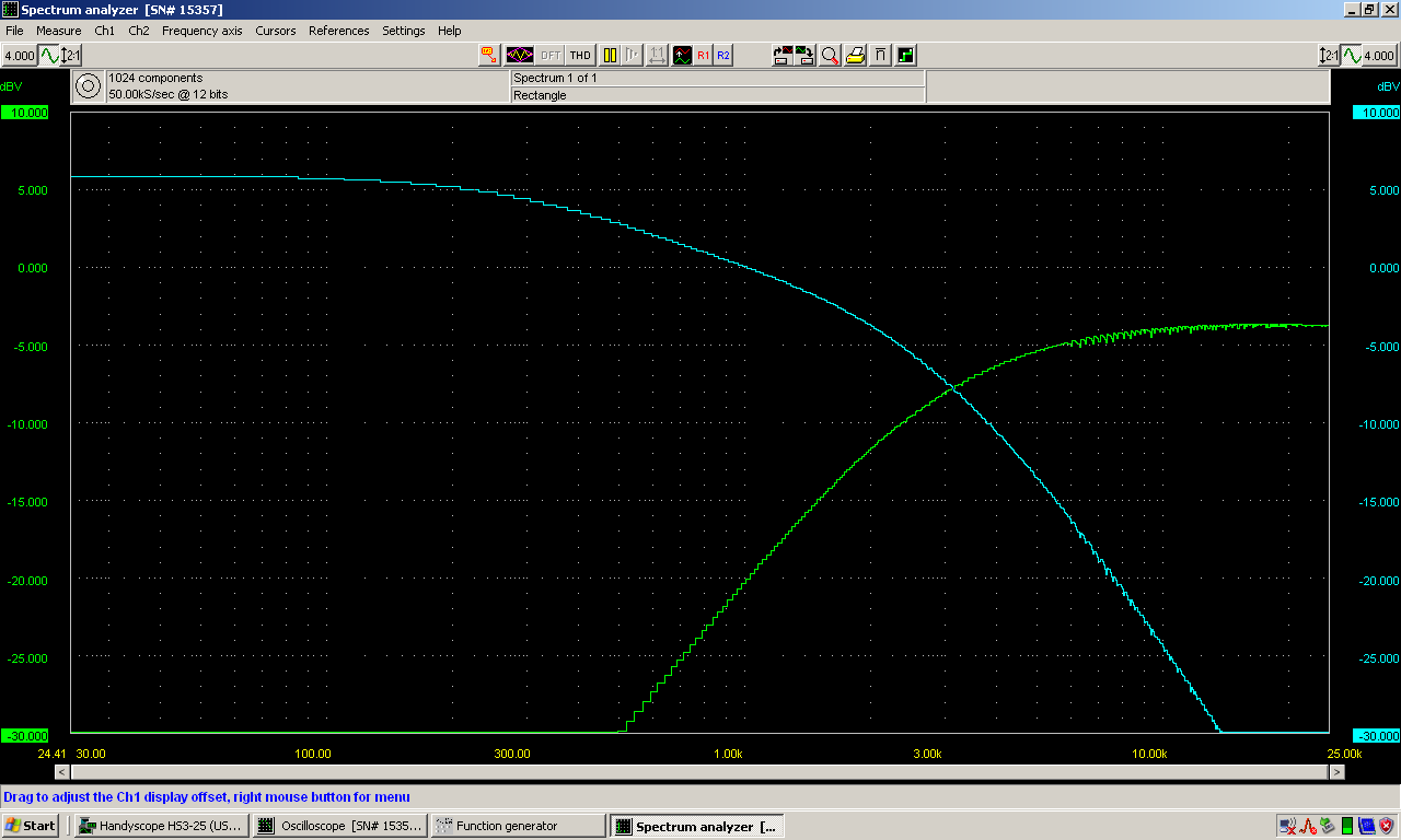

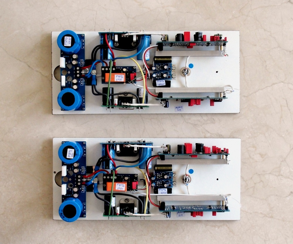

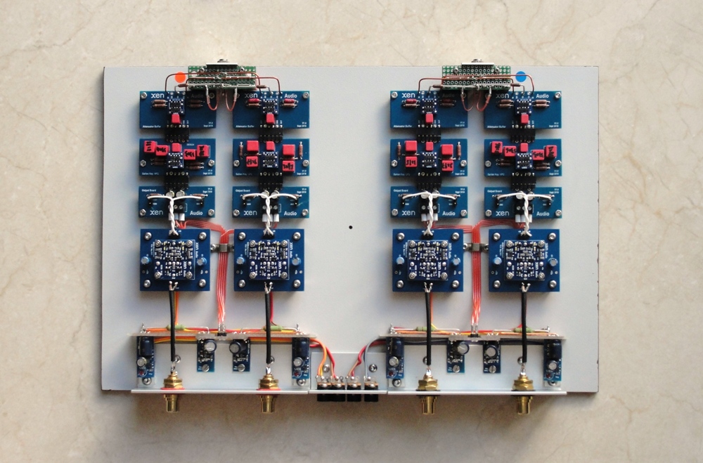

A friend in the EU built a LS5_9 clone, but used a different woofer (Audax HM210G6) together with the Audax TW034.
He chose a simple 12dB crossover with the tweeter 3dB attenuated, plus 6dB bass boost at 410Hz.
Just for fun, I built a balanced active crossover to replicate that.
There are also 4x XCEN Bal to SE converters to get the benefits of BAL even with RCA out.
Gorgeous woodwork. 😉
Patrick

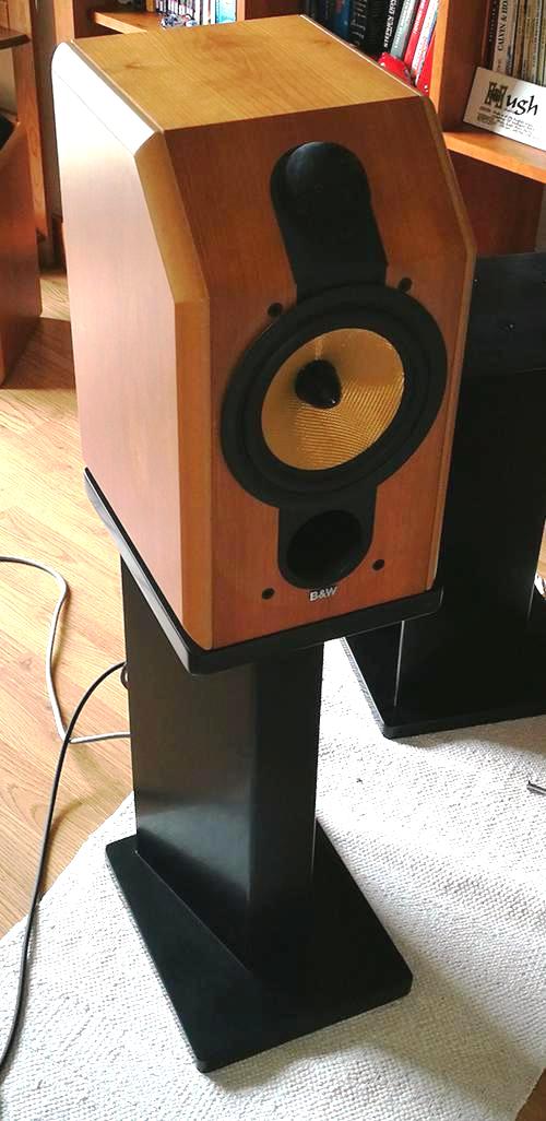

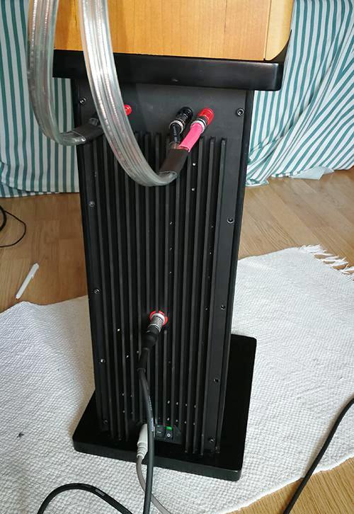

Another build replacing the (different to CDM1) passive crossover of the B&W CDM1SE.
This is also balanced, with the speaker stand in black Corian housing all the electronics.
Amplifiers are 2x LM4780 per channel, inverted & bridged.
The B&W CDM1SE (2nd hand) is a real bargain.
The builder loves it to bits.
Patrick

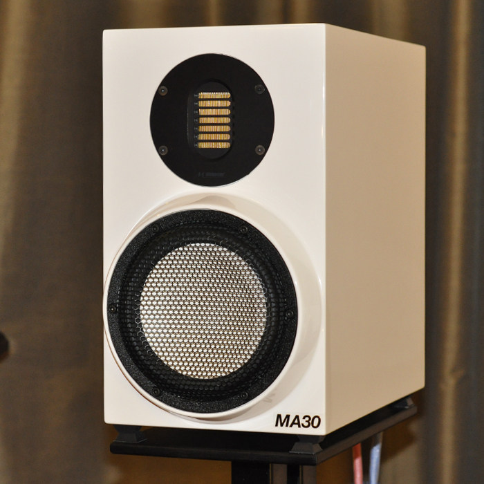

We have used them for quite a few project since.
Including an active Mundorf MA30.
So not many left.
Patrick

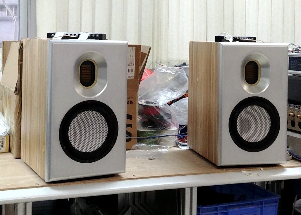

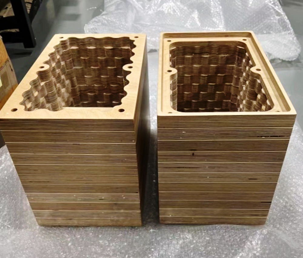

Not mine.
Speakers built by a XEN team member from a Mundorf kit.
There are things you don't see from outside.
We played some heavy drum music deliberately loud.
Yet the enclosure has no vibration whatsoever by finger touch.
Both drivers have no direct contact with the aluminium front panel.
There are damping material at all contact surfaces, including under screw heads.
I would say quite an improvement to stock design, cosmetically at least.
