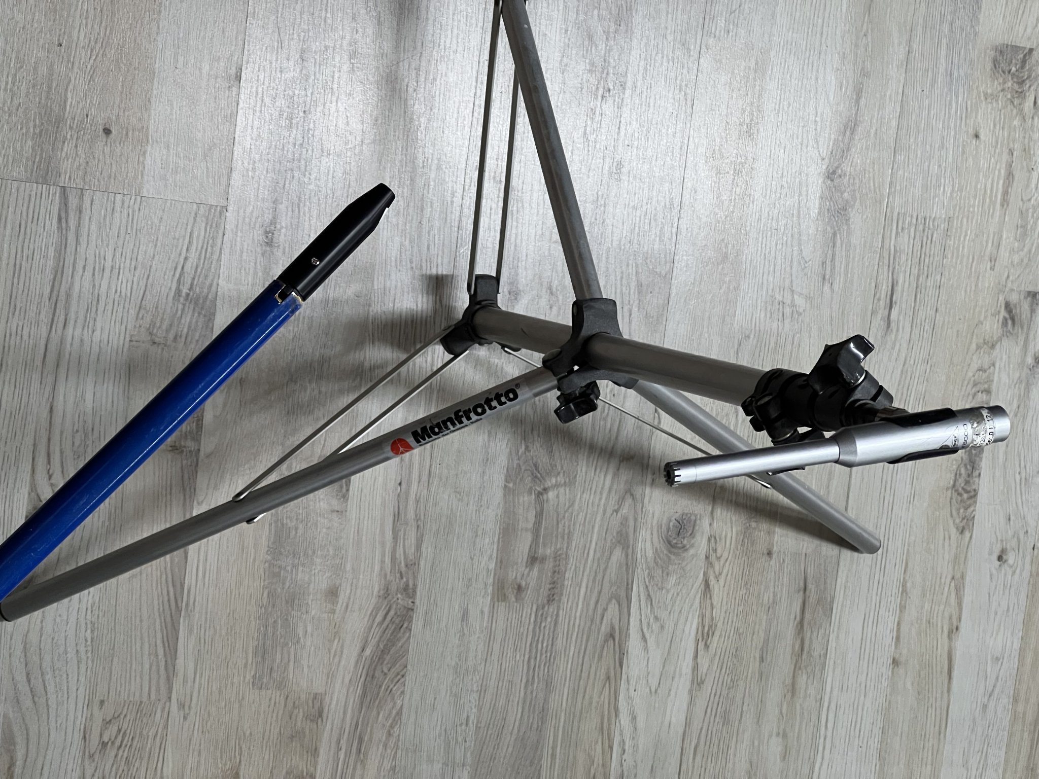

And don’t forget a suitable microphone stand, with the tiniest clip you can find. Because you’re measuring in a direct field, anything that can cause reflections in the vicinity of the mike will have impact on your measurements.PS don't forget an XLR cable, 5 meter will come handy.
the cable as suggested by - @Turbowatch2 - I have it, it should be 4mt it is the one of the mic. AT
do you also need the support? 😵
do you have a pic of the mic support. to understand what I should look for. graziee

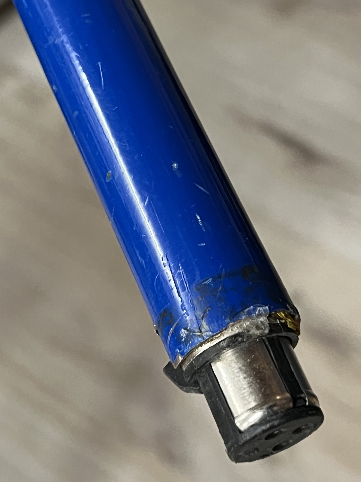

On the right the one I used more than a decade ago. The light stand is still handy for room acoustics (goes up high if needed). The left one is a DIY XLR female wrought into a snug fitting tube that has the diameter of almost all measurement mikes.
