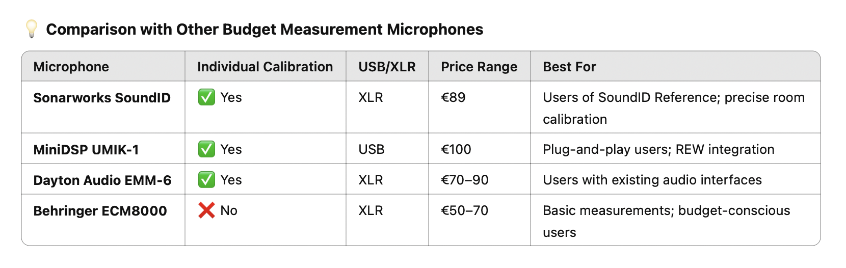

ChatGPT (with some help):
You don't want the MiniDSP for loudspeaker design work though.
I did ask the AI what is best when accurate timing is important. Impressive how we evolved ever since Google came around. It went wrong on the SoundID mike though, that one is very analog and very well suited:
Great follow-up — accurate timing is crucial if you’re doing:
When timing accuracy is critical, the entire signal chain matters — not just the microphone, but also the interface, ADC, and whether you’re using USB vs. XLR.
If your interface supports loopback (or has dual inputs), you can:

I'm confused because I see microphones placed one meter away, and others only 20cm from the speaker.
And while we're at it, any advice on what to take to measure with quality.
the latest generation sound card, which should also be purchased, but I already have clearer ideas, will have the best features.
I just installed REW

Re: best microphone. XLR if you can afford it. It needs to be calibrated.
Your AT microphone is 100% useless for measuring, it is for DJ anouncements and vocals maybe.
You need a phantom powered XLR input for REW and dedicated measuring mike. Don't waste money on a USB type.
With such gear, in the EU, you may buy at Thomann. In most cases it will be (USB interface and microphone) cheaper to buy new than used, because of P&P, even if you ignore the 3 years guarantee you get there.
If you go for a non calibrated microphone, you must be prepared to have no correct data in the low and high end. The midrange usualy is linear. To know that your measurements are correct is more value than the 50€ premium you pay, compared to the cheapest Behringer mike with very inconsistant tollerances.
If we look at Thomann, you get a calibrated Sonarworks for 77€, which is a very fair price and will serve you well for many years.
https://www.thomann.de/it/sonarworks_soundid_ref_measurement_micro.htm
Throw in a ESI Maya 22 USB 2-channel USB interface for 39€ and you are ready to go.
https://www.thomann.de/it/esi_maya_22_usb.htm
This is nice combination, compact and solid.
If your budget is a little higher, a Focusrite Scarlett 2i2 3rd Gen for 116€ is a safe bet and has no weak points. May be considered a little more audiophile by some.
It may be interesting to know, if you spend these 114€, which includes P&P and a return option, you get something you can resell with very little loss if you don't like the hobby any more. Have a look what eBay offers you find and you will see they are rare and expensive in used condition.

These cheaper mics may come with a cal file, allowing accurate measurements. But in my experience they drift quite a bit, making the cal file moot after a couple of months.ChatGPT (with some help):
If you are interested in long-term stability, I would recommend something a bit higher quality than these.
