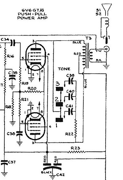

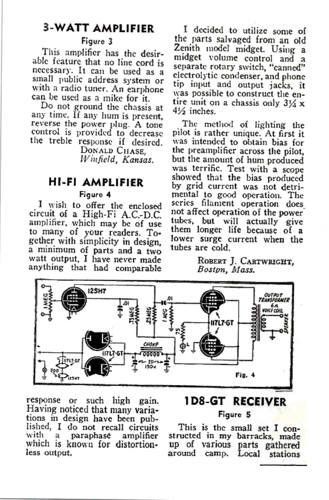

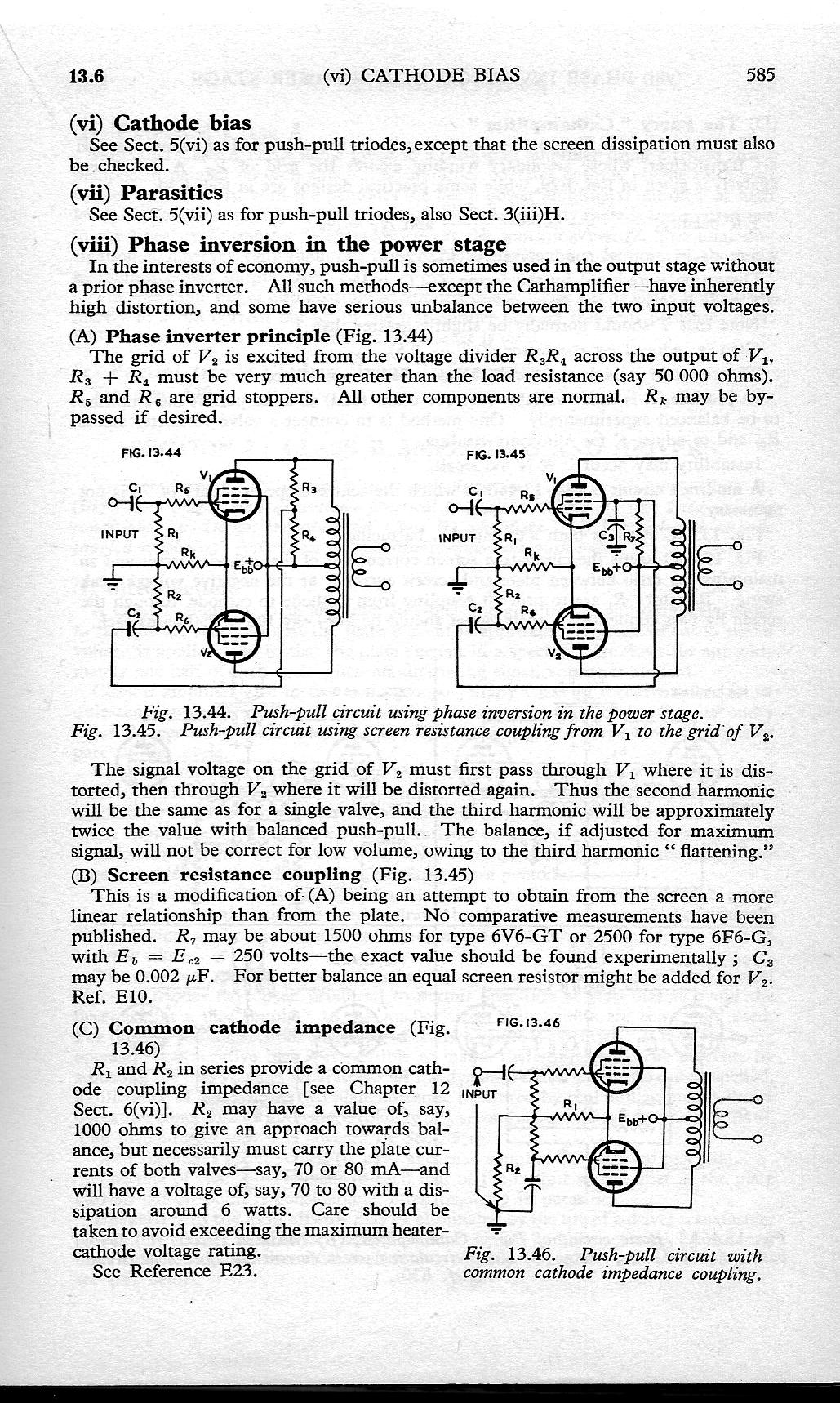

The self inverting output stage has been circulating in the experimental realm since before WW2.
And covered Ad Absurdum by many including Yours Truly on these pages a few years ago,
Here is one from WW2 built when parts were hard to find, This version needs an isolation transformer in today's World.
A few commercially sold products have utilized the self inverting circuit.
For those who have a copy of RDH4 you can find references there as well. 👍

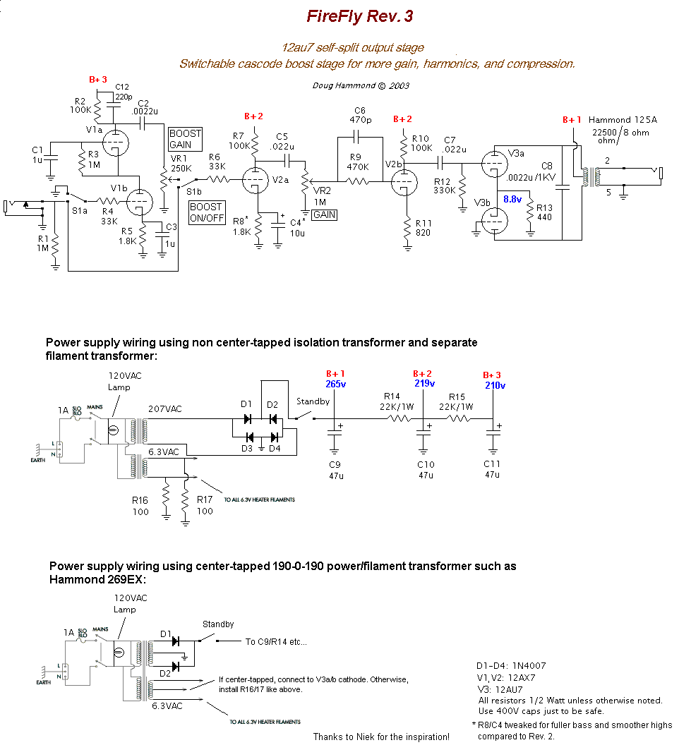

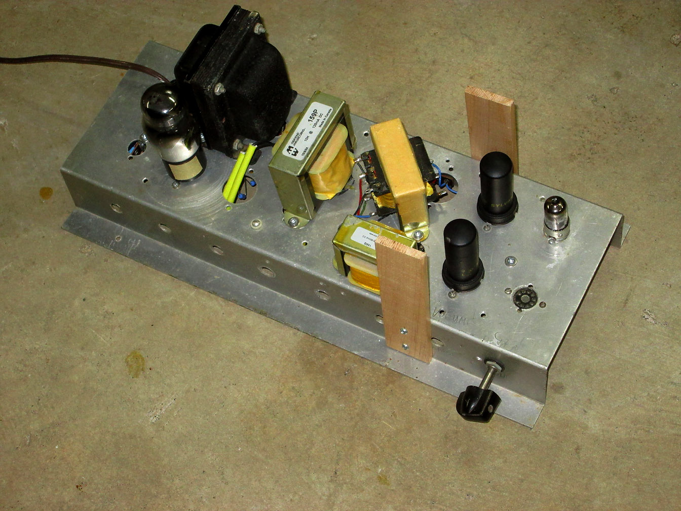

Certainly that's true of the Poddwatt I built a couple of years back. My sweetest sounding amp.Was that not the essence of the Oddwatt amps?

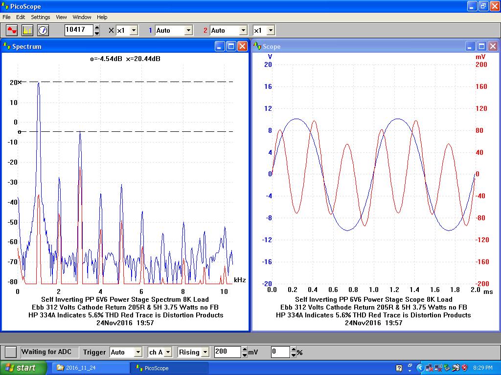

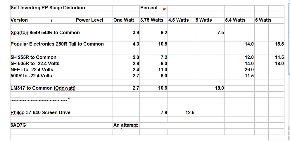

I tried several versions of the self inverting circuit, most of the measurements & observations are posted here on DIY.
For the test mule I used an old chassis that had run many experimental circuits. In this case the driver is a triode connected 6AU6.
The rectifier is a 5V4 or something similar into a simple CLC HV filter. B+ is ~300V.
The PP outputs are 6V6s. The OPT a Hammond 125E. The main variable for the tests was the cathode tail.
I tried tails of Rs, NPNs, 3-term device & a Hammond choke, The Hammond choke gave the best results.
The spectrums were obtained using a Pico Technology 3224. The THD by an HP 334A.
The output terminals of the HP 334A provides the distortion components for direct viewing & measurement.
That is the RED Trace in the Pico Tech Display.👍

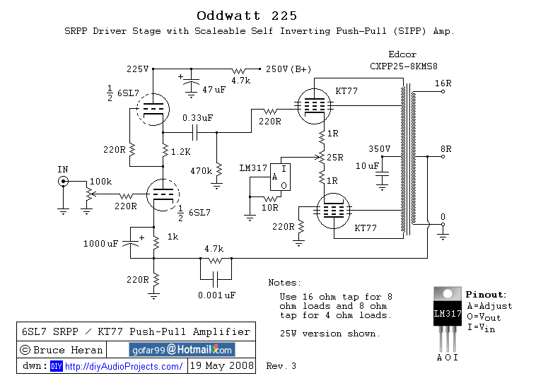

Answer: Yes, but an LM317 or other solid stage CCS, is far different than a Choke CCS.

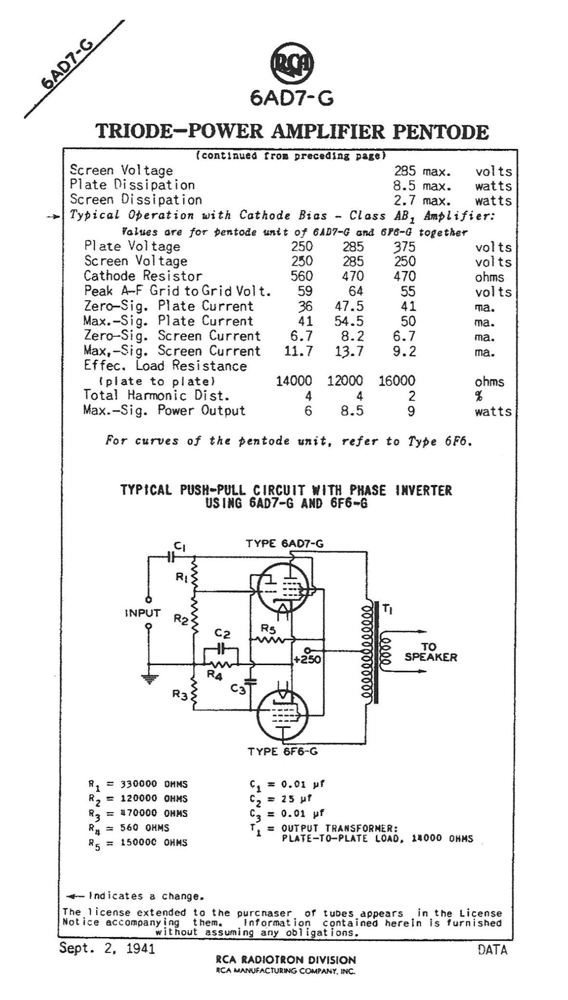

There are other ways, for example the 6AD7G. It was used as a low budget phase inverter driving its pentode in PP with a 6F6,👍

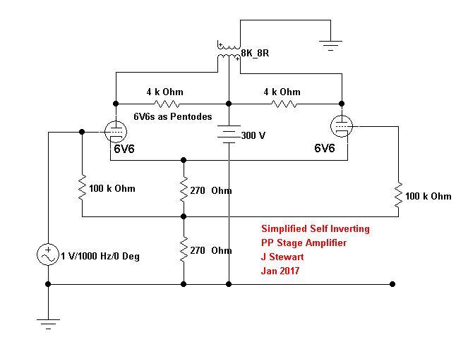

not mentioned so far:What is the limitation of this approach?
- strictly limited to class A operation (as soon as the driven output enters class B, i.e. is cut off, the other output does not get any more signal to work with)
- incomplete cancellation of even harmonics (PP with more like a SE distortion spectrum)
constant ...?Vds, which as I understand it, remains constant in a split load circuit like a concertina....
drain goes up while source drops and vice versa ... both with unity gain,
so vds change is twice the input signal swing ...
Sorento,
You were correct about Class A operation only, no Class AB allowed because of the CCS (Constant Current Sink).
. . . But is that an advantage, or is it a disadvantage?
That depends on what you want to get, and what you are willing to trade off . . .
needing to use global negative feedback or not; output power lower or higher; distortion lower or higher; average power supply works OK, or a much stiffer power supply is paramount; simple circuit or complex circuit; etc.

A typical single ended amplifier has dominant 2nd harmonic distortion; and the 3rd harmonic is typically 15 dB less than the 2nd harmonic.
Example: -40dBc 2nd harmonic distortion, and -55dBc 3rd harmonic distortion.
But my self inverting amplifier (this thread) has almost equal 2nd HD and 3rd HD.
1 Watt, 1kHz:
2nd Harmonic - 55 dBc 0.18%, 3rd Harmonic - 54 dBc, 0.2%, THD 0.27%

As a marketing tool the circuit has the advantage of allowing the manufacturer to claim PP, a big deal in the 30s & 40s.
All without the expense of another socket & toob. Things are not always as they seem at first glance! 😀

A strange way to look at things, but push tubes are unbalanced versus pull tubes as the signal drives them in opposite phase.
A triode wired 6L6GWB beam power tube has a transconductance of about 4,700 uMhos.
Transconductance:
When the control grid voltage to cathode changes by one Volt, the plate current changes by 4.7mA (and the screen current changes slightly too).
The hidden factor, alluded to in in your comment is the fact that now the plate Voltage and screen Voltage are changing . . .
Which means the transconductance is also changing slightly, true.
But one plate and screen voltage is reducing, causing lower transconductance in that tube; and lower current;
While the other tube's plate and screen voltage is increasing, causing higher transconductance, and higher current.
I think that sounds like push pull, and the resulting 2nd order cancellation.
If that set of conditions does not prove it . . .
Then I think -54dBc 2nd Harmonic Distortion is proof enough.
Right?
Many designers of push pull do not notice the factor that is essentially plate to plate negative feedback.
That and cathode feedback are as local of a negative feedback as you can get (other than plate to grid negative feedback).
The big disadvantage of Class A self inverting output stages, and Class A LTP phase inverters is:
The CCS (Constant Current SINK) in the cathodes reduces the gain of the stage, and they are Only Class A (no Class AB allowed, unless you like listening to severe clipping).
I hope I covered it very well this time.
Happy designing, building, and listening!
