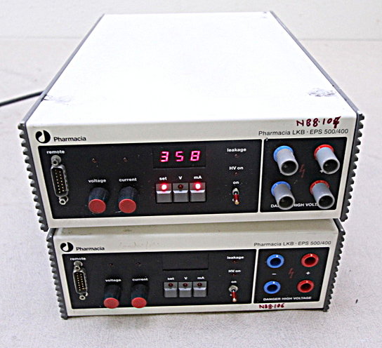

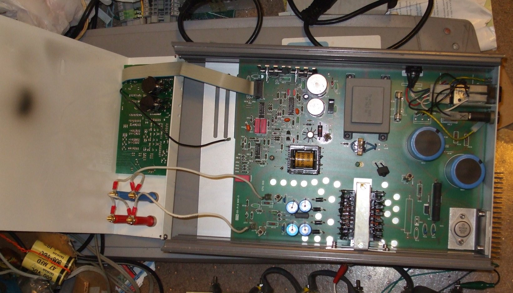

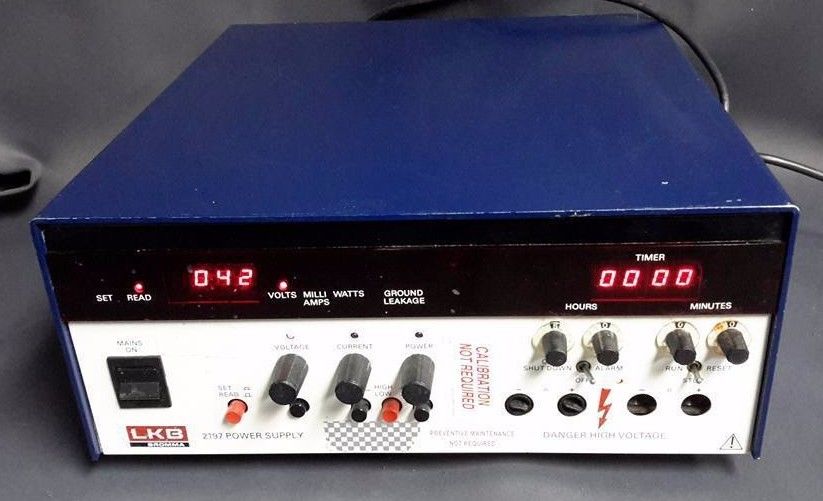

Pharmacia LKB EPS 500/400 unit:
Requires less than 1 mA load to activate (ie, has a no load safety shut-down).
Also has a leakage indicator and shut-down. (a ground fault interrupter safety, detects stray current going to ground, like used in modern kitchen outlets, super safe)
500V, 400 mA, 200 Watt max specs.
Weight 9 Lbs.
Dimensions: 3.75" H x 8.625" W x 16" D (including heatsink and knobs)
(Height not including rubber feet on bottom, another .25") Uses up bench space, but one could stack multiple units.
Power switch on the back is very hard to switch. Does have an easy standby switch on the front panel. V and I knobs are small and un-comfortable to use.
Only one digital readout meter, button switchable between actual Vout, actual Iout, V knob setting, and I knob setting. (the extra knob setting readouts are nice, but it definitely needs an extra Vout meter operating 100% of the time)
Has current limiting, with LED V and I mode indicators. Current limiting just turns off the converter, somewhat slow for the Vout to decay.
Euro style deep recessed mini banana plug output terminals (electrophoresis style)
Operates at 28.5 KHz using a flyback converter design using Philips TDA1060 controller chip with a heatsinked TO-5 driver transistor. Single switching transistor, TO-3, (probably bipolar) Heatsinked on the back, no fan. Two resistors on PC board getting rather hot (board browned around the 3 Watter)

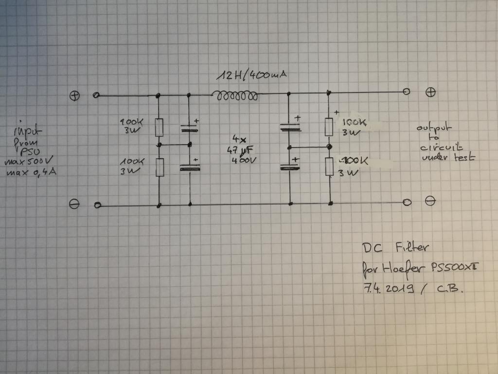

Both units need added line input filtering AND HF output filtering. ESPECIALLY the Pharmacia LKB unit!! Common mode HF output filtering too. Most bench switching supplies use a full C - L - C - CM choke filter on the output. I've noticed that Xantrex XHR supplies also have a shunt Mosfet across the output to pull the Vout down quickly (1 mSec) when either the Current Limit or Over Voltage modes activate. This -could- be added to these units IF an I limit signal is available. Especially useful after adding more filter Caps, since those will further delay the output voltage decay. Might save some tubes from melting down occasionally.

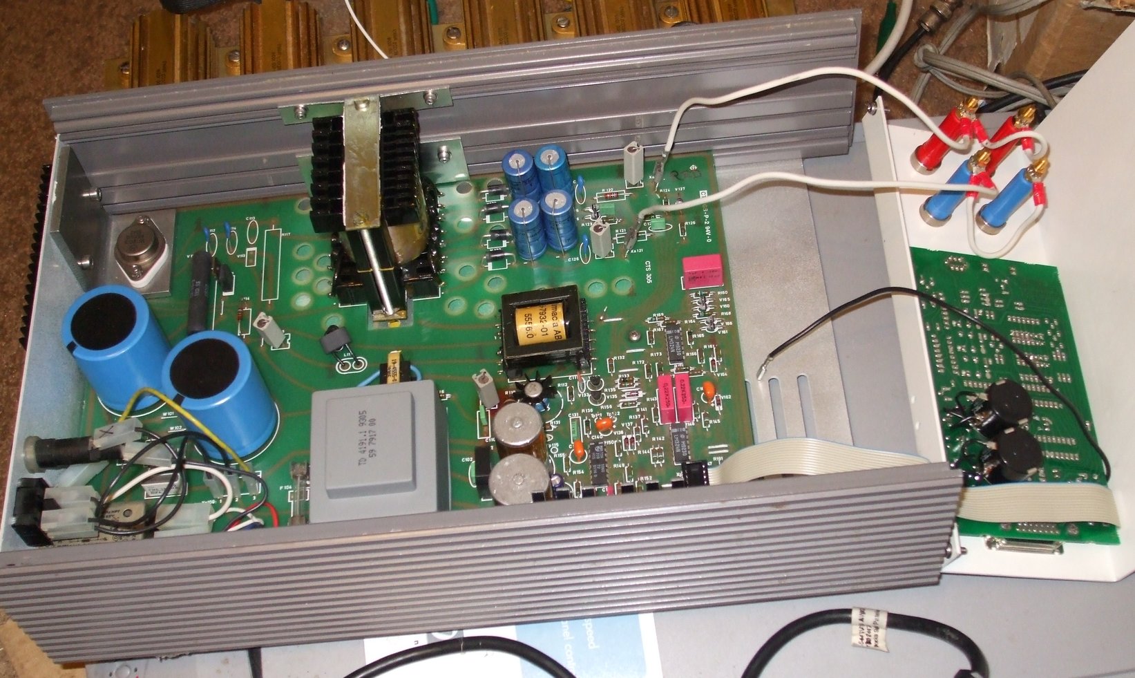

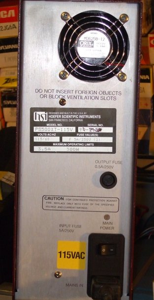

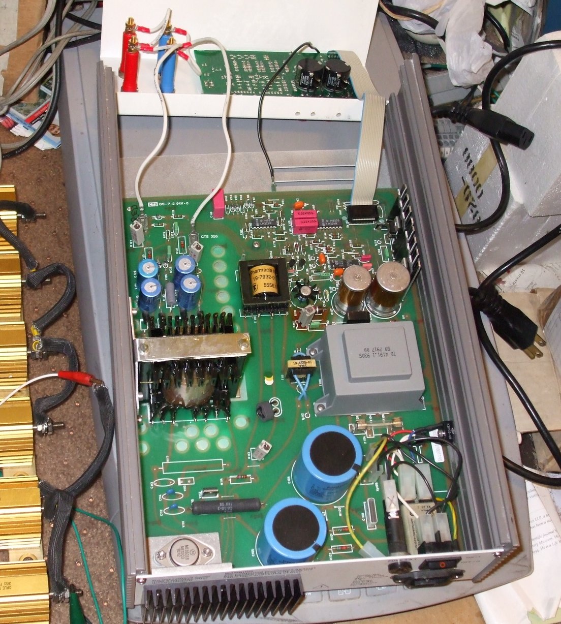

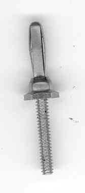

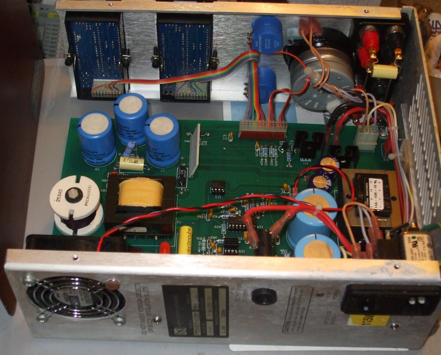

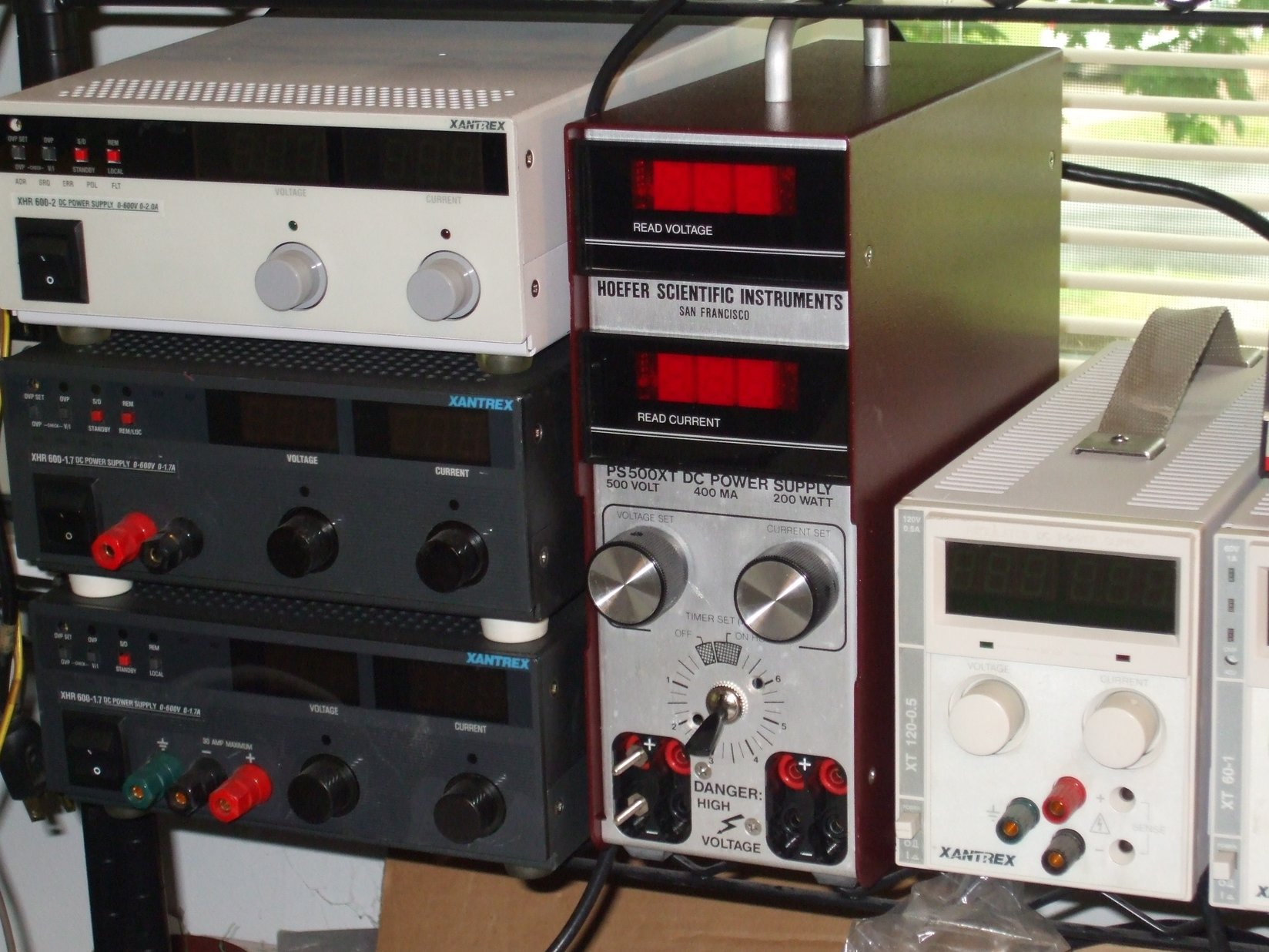

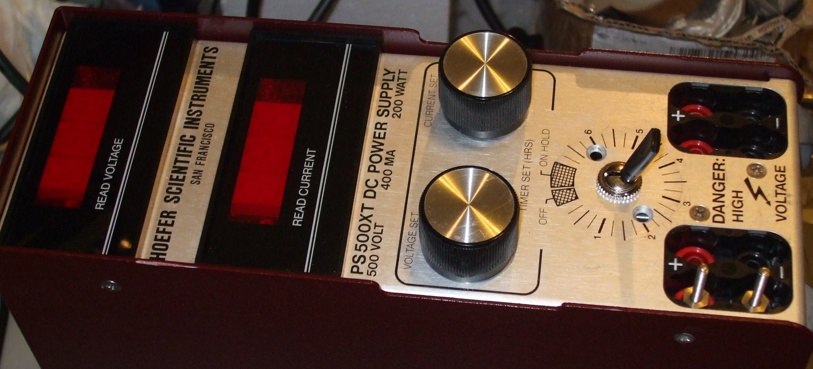

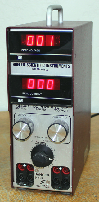

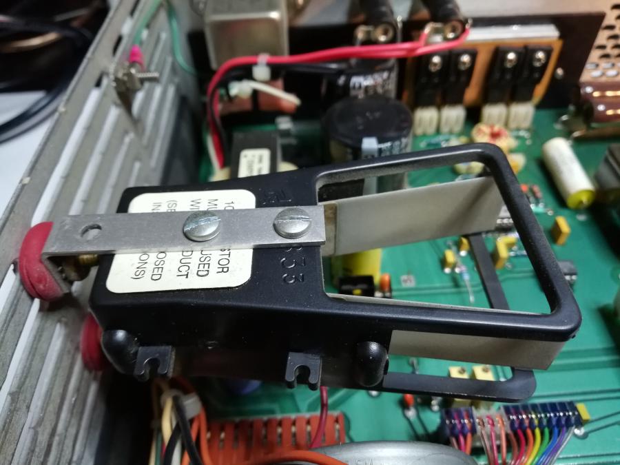

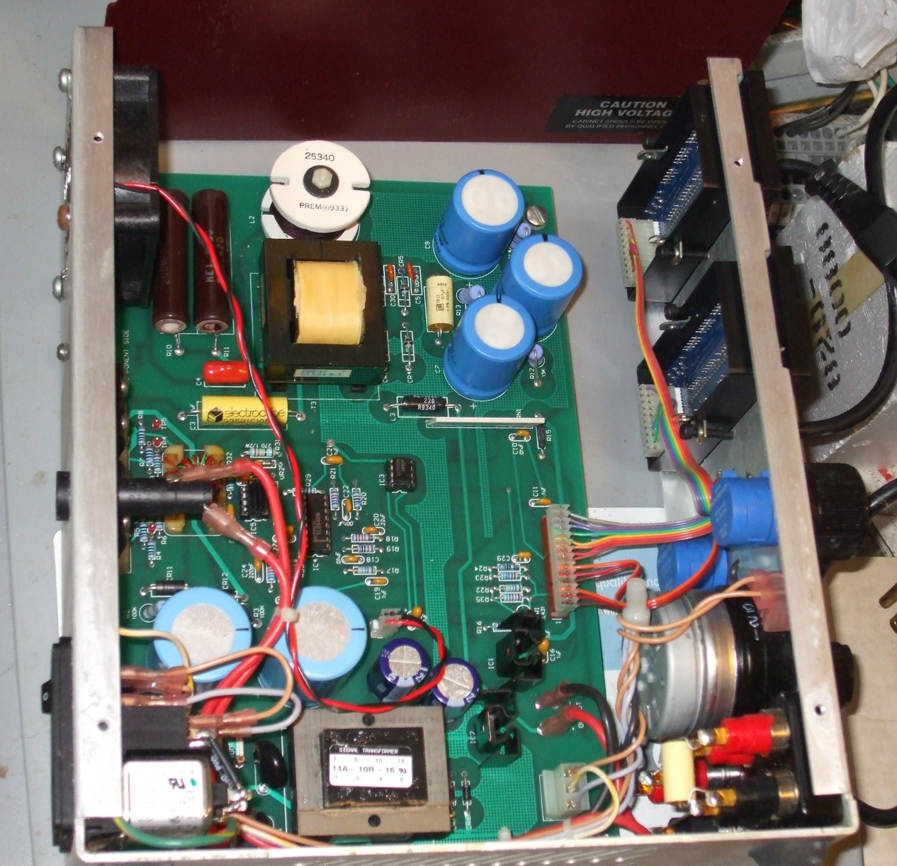

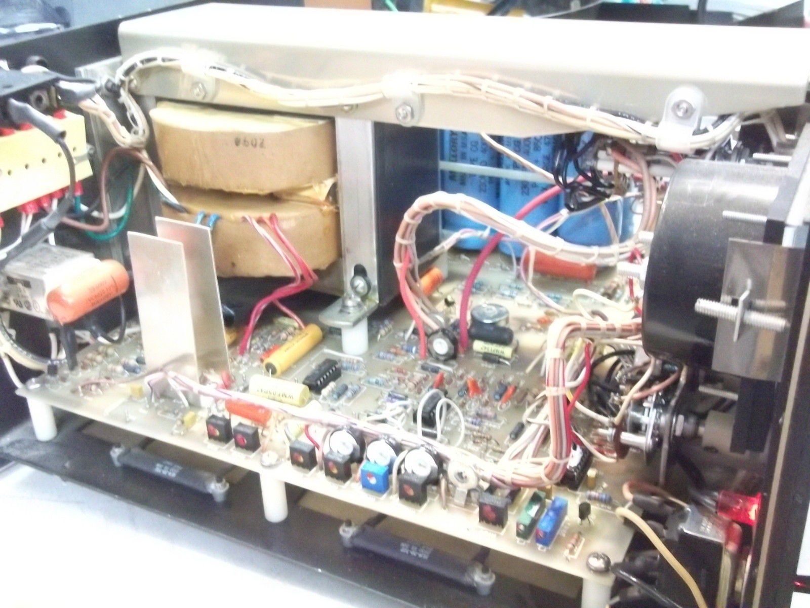

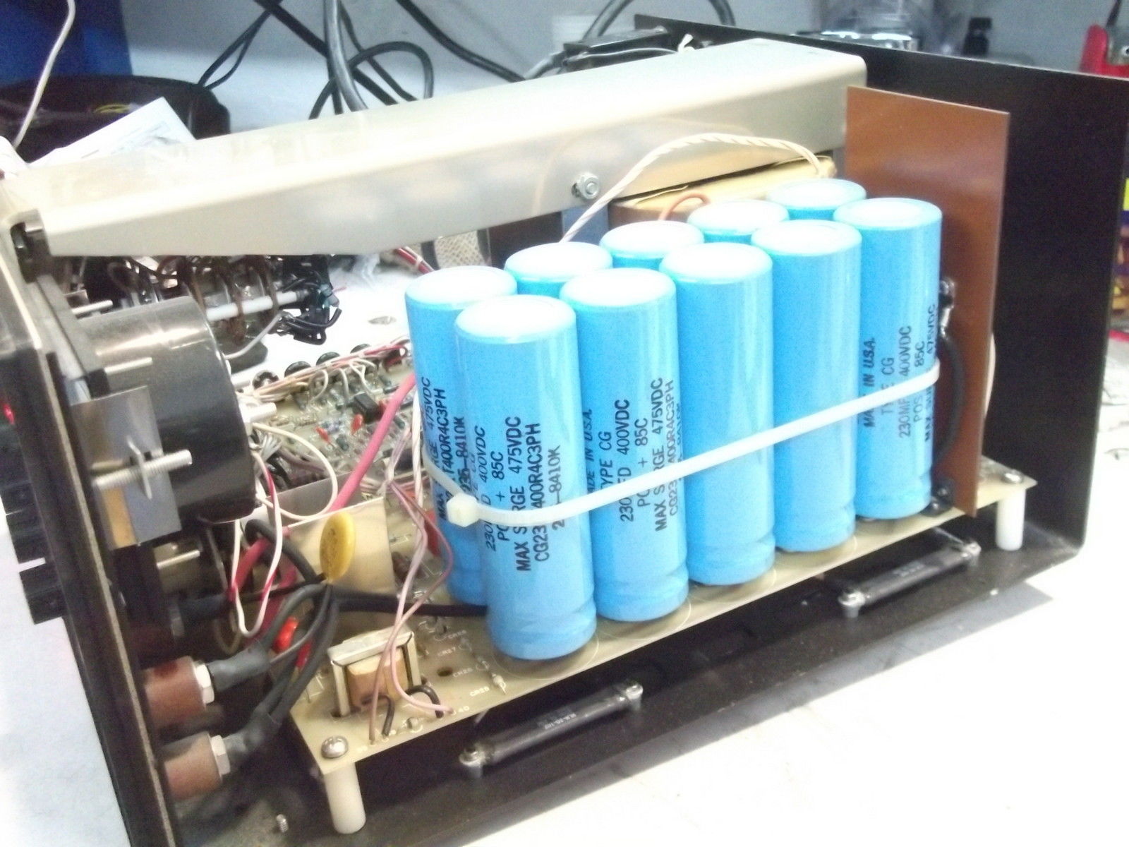

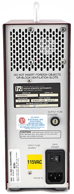

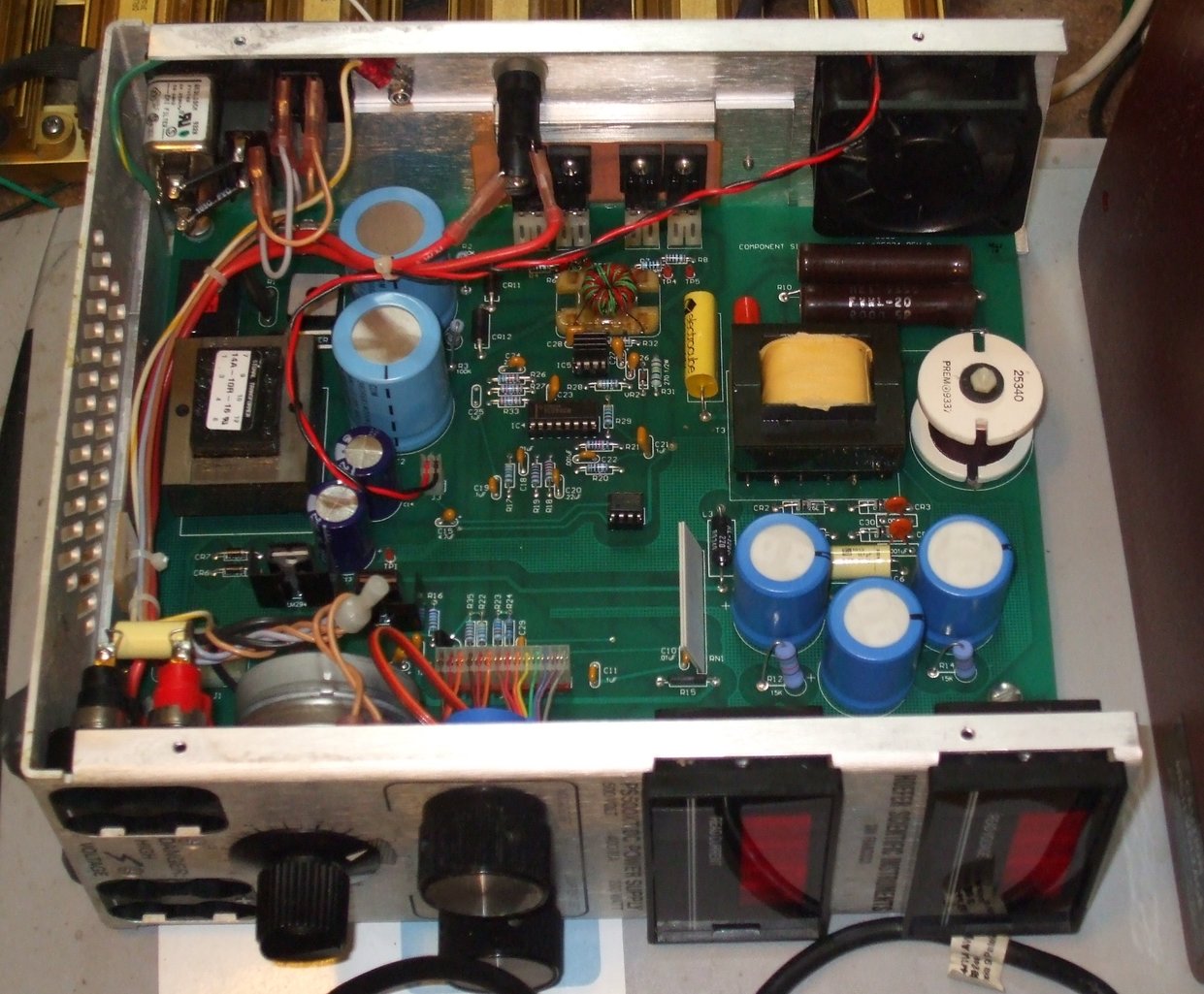

Some more pics of the Hoefer unit. The 1st pic shows the big insulated handle ON-OFF toggle switch I put on the Hoefer unit front in place of the stupid timer setup. The 2nd pic shows the bottom of the Hoefer unit, I added some extra vent holes along the edge, after slowing down the fan for quiet running. 3rd pic shows the Hoefer on the shelf with some Xantrex XT-250 supplies on the right side (for screen supplies, woops, the 120V model shown there) and some Xantrex XHR-600-2 supplies, stacked on the left side, for those heavy duty jobs. (0-600V, 1.7 or 2 Amps, a few thousand Watts there)

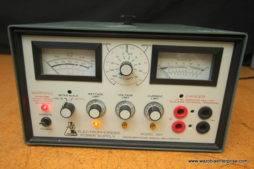

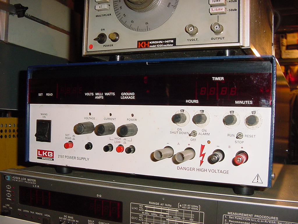

And also some pics (off Ebay, I don't have one) of an ISCO 494 Electrophoresis supply, which some have used before.

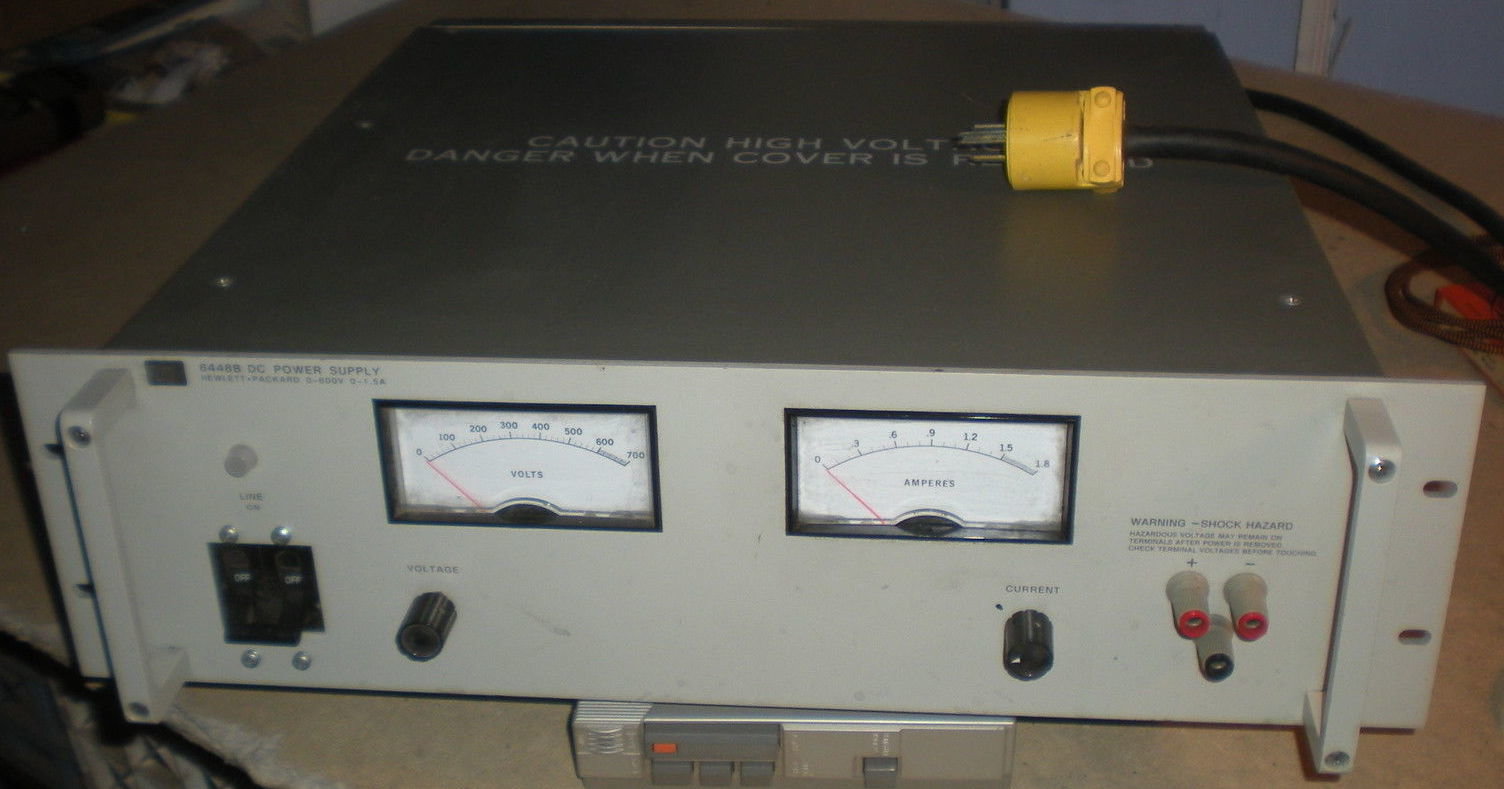

The ISCO 494 looks to be a 60 Hz Triac phase control design (similar to HP 6448 or EMI/Sorensen TCR-600) (big heavy boat anchors). Although the ISCO is slightly different in using a constant V power xfmr, which would make the phase control quite linear. (a square wave output, instead of a sine wave, from the XFMR)

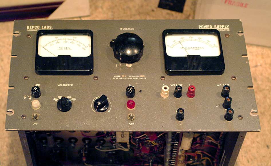

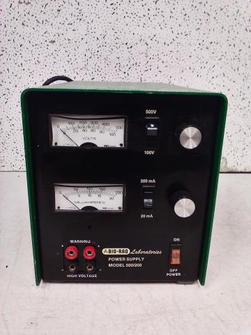

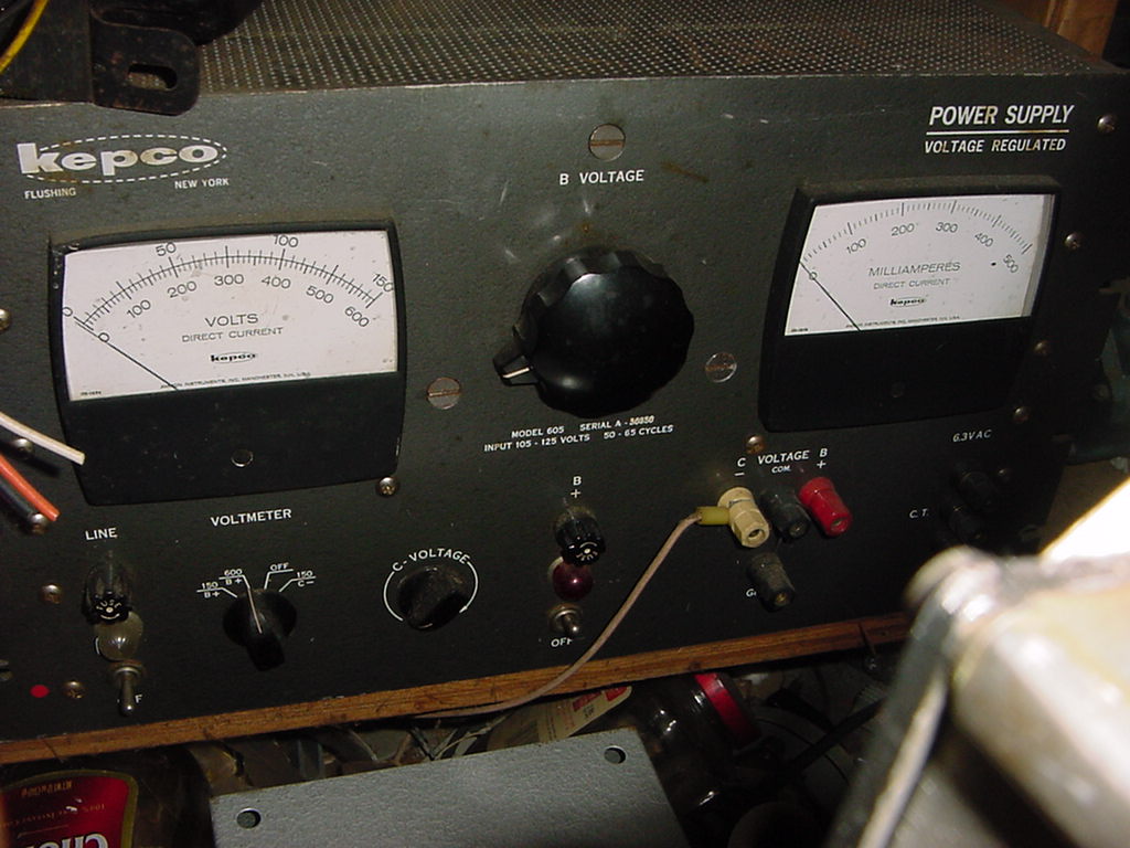

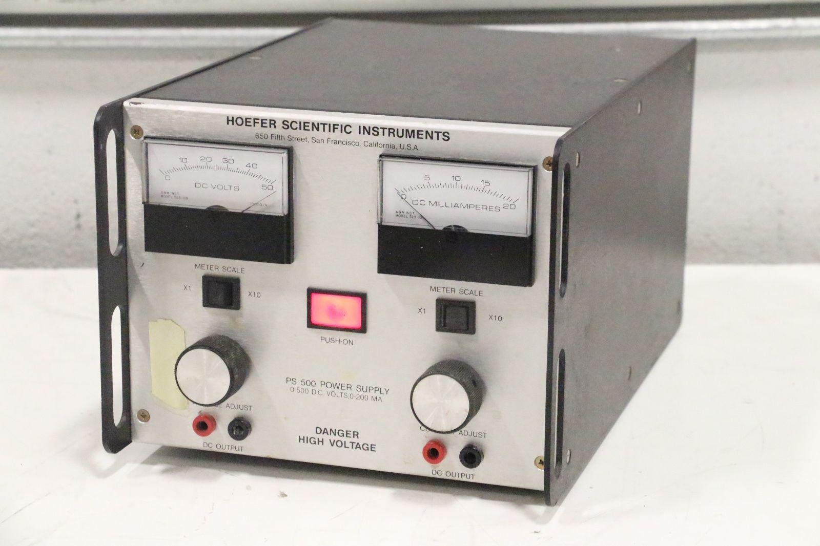

Here are some more pics of the BIO-Rad 500/200, and Hoefer PS500-200 (linear supplies 500V, 200 mA, 100 Watt, about $120). And that mysterious LKB2197 (2500V, 250 mA, 100 Watt)($75). The linear units should be nice.

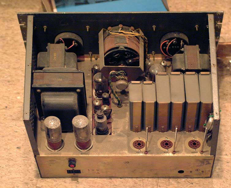

HP 6448 boat anchor and Kepco tube supply pics

The Pharmacia LKB connectors on the EPS 500/400 unit I have here look to be 2 mm shrouded miniature banana plug jacks (European standard). With a deep recessed socket.
The Hoefer PS500X connectors are standard US 4 mm banana plug jacks. I use a US banana plug to 6/32 thread adapter to fit them. (for test bench clip lead attachment) (pics below)

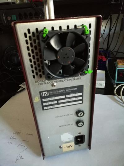

Based on your inputs, I have bought a Hoefer PS500XT from ebay. Seeing 115 and 230V models existed, I thought do not care and buy the 115V version, modify its input transformer connections to work on 230V... sadly no way it seems. I will buy an auto-transformer so I can hook it to my 230V mains. Tested it on a Variac and it works fine.
Do someone have a schematic ?
And then other questions:

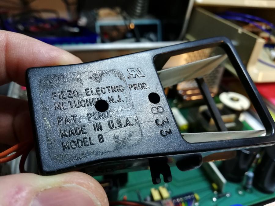

There is this strange device with two winglets, they vibrate when power applied. Seems its goal is move air around, like an internal fan or similar. It has got 3 connections, two orange wired together to the main power timer and a red one going to the PCB. What is its purpose and can I remove it ? I plan to add a fan anyway ?
I see on your pics someone has taken power for a small DC fan from the PCB. Can you explain where you connect it ? I can of course test around with a multimeter and see where I get a valid 7-8V or so, but hints will help...
thx !
Charles
This is the one I have, no real current limiting, but really cheap
Can anyone help me modify this power supply? EC-135 ( OSP-135 ?) | Audiokarma Home Audio Stereo Discussion Forums
> this strange device
Piezo fan. Several companies pushed the idea 1970s onward. Not a big blow. Very power-thrifty, especially when run from wall AC. *May* have longer life than motor fans. Will have a different sound.
Thank you PRR. The piezo fan will go to the dodos and get a real fan installed instead. Preliminary tests confirm results of smoking-amp : the two large resistors get really hot and deserve a constant air flow !
Not sure about the airflow direction for the fan. Should I push air in, or pull air out ? There are large holes at the bottom of the case, so circulation is ok.
If there is a natural convection path from bottom to top then you should align your airflow with it. In other words, if there is generous ventilation on the bottom then have the fan pull air in through the bottom and exhaust out the back, assuming the fan will be on the back. The exception to this is if you had localized very hot parts in which case you would want to arrange the fan so that the coldest air possible was blowing directly on the hot parts. The piezo fan would really only provide air circulation within the case, so a fan that pulls air from outside is going to be much more effective.
Bfpca thanks for this logical explanation. Clearly it would make sense to pull air out, given the fan is at the top of the case, but the hottest resistors are right behind the fan air flow so I decided to pull in. Will see how it goes after a few hours loaded usage and a temperature sensor. Reversing is obviously easy.
I placed the fan outside, because it's a little bit too small inside, with the large snuber resistors. The 12V fan is powered with 8V, pulled from the +15V opamp with a 3W/220Ω resistor in serie. It is not obvious from the pic, but I cut-out the aluminium grid to poke a large 50mm hole for good airflow.
I'm ordering a 300VA, 230/115V auto-transformer from Toroidy, and then it will be time to check the PSU under load and see what kind of CLC filter I add. Probably a small external box with input and output bananas sockets and the CLC filter in it, close to the circuit under test.
Mmh I think there is a serious bug in the forum software, last post is half from me, half from Bfpca. Probably some strange edit/quote/reply combination that had Bfpca's session associated with my own session. Not very important to me, but maybe the forum software needs an update.
CLC filtering for Hoefer PS500XT
Hello again,
I realize I have so much to learn... I'm very grateful for your help !
smoking-amp told about the lack of good filtering for the Hoefer PS500XT. My intended use is to experiment tube amp circuits with this PSU. I can well imagine I want it to be stable and not introduce noise into my circuit under test (my model has an EMI input filter on the main so I have no plan to modify this side).
So my idea is to add some filtering at the output, in a distinct chassis. Will a CLC filter be appropriate ? Looking at Toroidy page, they have this 12H/400mA /66Ω DC choke, which I would preceed and follow by two set of electrolytic capacitors, twice 400V in serie with bridge resistors would be safer. The resistors would serve as bleeders as well.
What I'm not sure :
Hello again,
What I'm not sure :
- is it a problem (beside weight, price) to have such a high-current DC choke, which I will probably never saturate ?
- what size of capacitors should I use ?
- do I need to snub the electrolytics with small caps ? If yes, what types should I prefer ?
I have two ISCO power supplies. One is a model 494 which I've only tested to make sure it works and functions correctly. The other one is a ISCO model 470 which has digital displays and it sees usage when I am working on a design.
The last unit is a Dan Kar that is capable of 2000volts @ 200 mA. Its a no frills unit that consists of a transformer a variac and a heck of a bank of capacitors.
Out of the three I use one. The others will probably get tossed when we sell the house and move.
