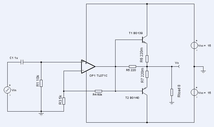

Is similar to this simplified form, used as opamp booster in some industrial application:
Tr 1 and Tr2 are poor current sources but the principle should be correct, is so mandatory to have a high impedance current source?

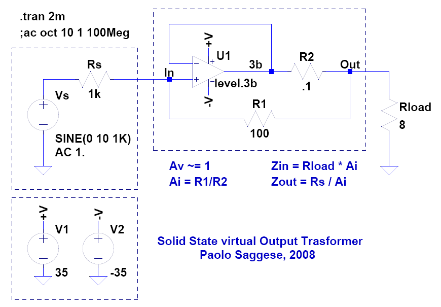

I have tried a different yet similar approach. I have prototyped the circuit shown below using an LM3875. It works just fine (and sounds very good, too!) using a tube "front-end" (actually a 12b4 SE preamp!).
The circuit is perfectly stable as far as the drive impedance (Rs) is high enough compared to R1.
