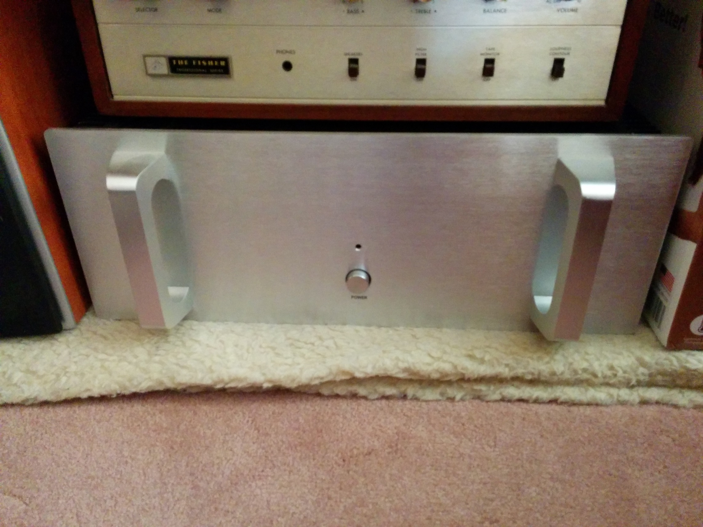

I bought some China made chassis from ebay, and they had painted some crazy Chinese "brands" and model on the front plate. Here is one of them:
Aluminum Case Chassis Enclosure for AR998 Amplifier with Heatsink 483 380 180mm | eBay

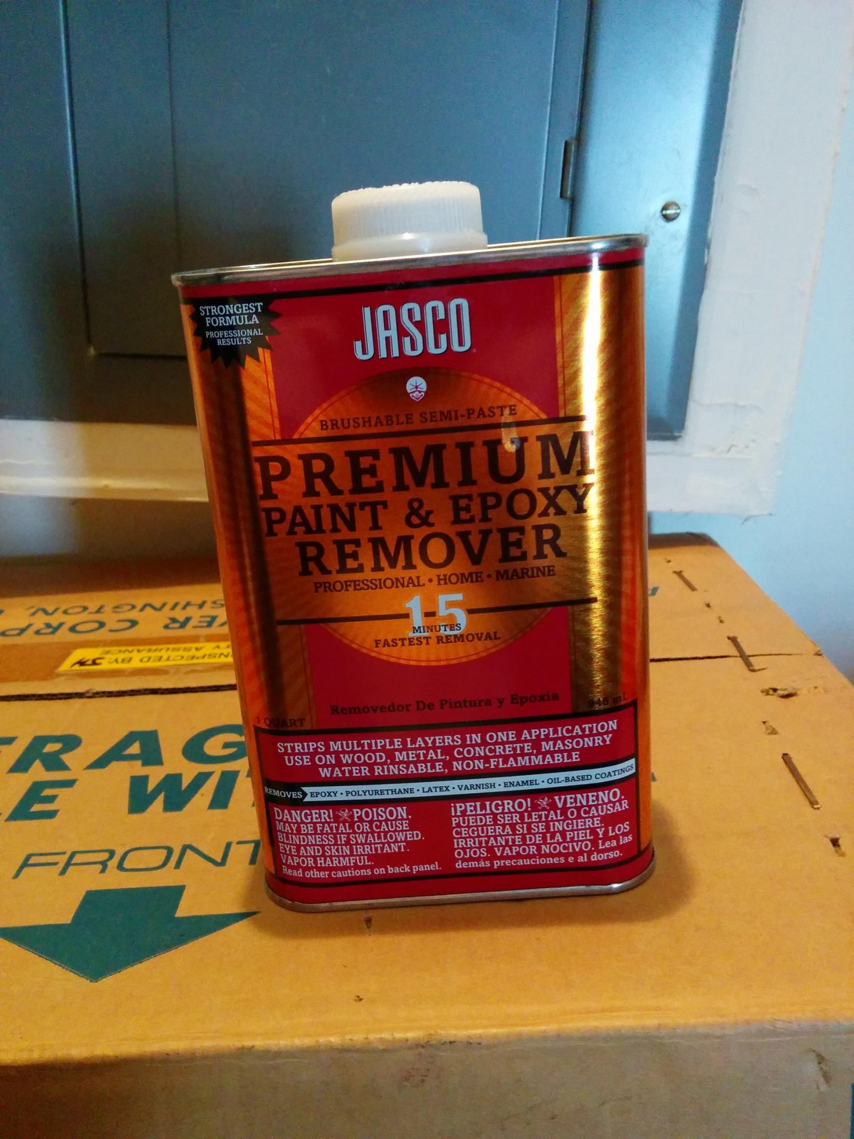

Pure Acetone from Ace Hardware could not remove the paint. Even a razor didn't work, but I didn't attempt to the point that I could risk of scratch the front plate. Then my brother (who works in a print shop) gave me a can of left over "paint removal" gel to try, and it worked the magic.
Attached are pics of the "paint removal" gel and the front plate afterward. You can compare the result to the ebay ad.
Notice that the gel is very very strong, I accidentally got some to my forearm, and it gave me burning sensation after a few seconds, and I had to rinse it off right the way. So, read the label and use with caution. Don't say I didn't warn you.
