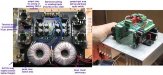

comments on chassis layout?
Before I drill too many holes, I thought I'd invite comments/suggestions on my anticipated amp floorplan. It's a 4 channel TXO-2 that can be switched to two channels bi-amped. In 4 channel mode it will contribute for DD/Dts 5.1 sources (alongside with my first stereo TXO-2). In bi-amp mode it will drive 15" woofers (<= 180 Hz only).
Each channel is a TPM pair flanking a center-mounted TXD on custom brackets (to keep interconnects short). The three-board asselbly is supported entirely by the heat sink, and is positioned with the hot-spot of the 3886 nearly centered in the radiating field. The sides of the 3U rack box are chopped back 1" to expose the heatsink vanes. Balanced inputs and their grounds will switch via a modified Darwin board and input wiring will run near the top of the case. Outputs from 2 of the 4 power modules (the 'top two' in the photo) will be switched using two (super-gnarly!) 12 V. power relays with silver contacts. I chose them partly because of the convenient mounts moulded into the bases. Relay control wiring will run from the front panel backwards between the transformers and power supplies. Transformers are 22V - using 25 V, my other TXO-2 driving only mids & tweets (>= 6 ohms) sheds plenty of heat. These heatsinks are 50% larger - I'll wait to see if they need to be painted flat black like the ones in my other TXO-2.
I'm having a great time with this... Thanks to Russ and Brian for doing all of the hard work so that beginners like me can play DIYer!
All suggestions much appreciated!
Frank in Minneapolis

Great job!
Hi Frank,
Incredible layout work. I love it.
One word of warning. While it may work just fine (it has worked for me) be very careful when testing your parallel TXO-2s as some have had issues with instability when trying that configuration.
There may be some thing we can do to make it work if you have issues. So please contact me privately if you notice any problems in running that configuration.
It is a very well thought out implementation very good work.
Cheers!
Russ
