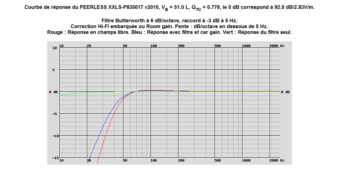

Parameters:
Re=2.50 Ohms (4 Ohms)
Fs=22.00 Hz
VAS=136.04 L (136.042L = 4.8043ft³)
Qts=0.39
Xmax= ± 12.30 mm
1.8ft³ = 51L (sealed) ~
PEERLESS XXLS-P835017 v2010, VB = 51.0 L, QTC = 0.78, 92.0 dB/2.83V/m
F3 = 41 Hz
30Hz@-8dB
P 145.0 W@4 Ohms for ± 12.30 mm (19.04 V), note: 120 W max. spec sheet rated amp (RMS)
I put the eminence and peerless T/S parameters in winisd pro and the freq range was on top of ea other at 51l sealed, there was about 3db difference in max spl though. I was more interested in kind of a subjective approach if any one had an opportunity to listen to the eminence lab12 compared to the peerless driver in sealed cabinet? how well they both sound if there is any benefits or trade offs between the two.
