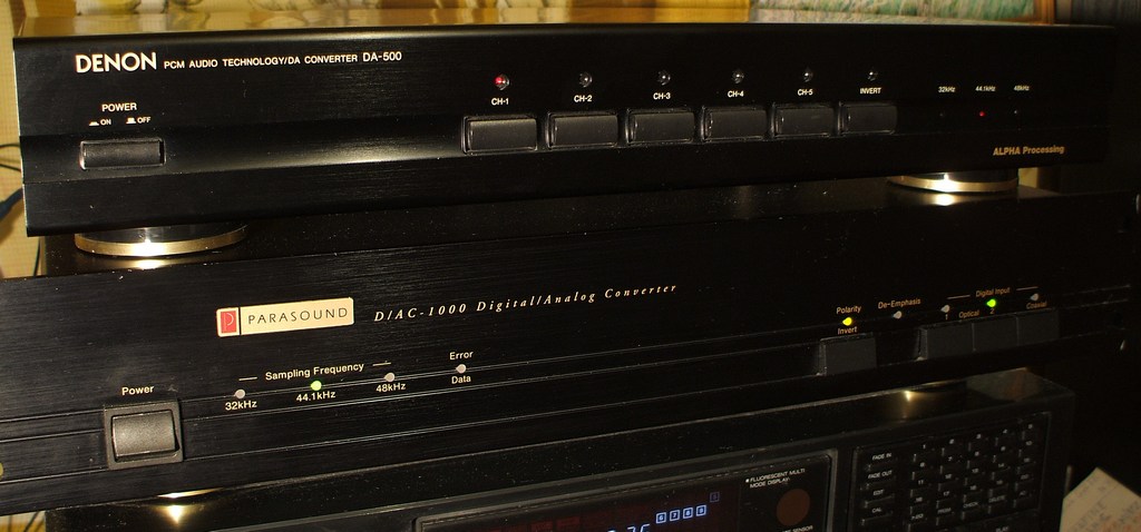

All is much worse, misters!
For the information - at comparison Parasound D/AC-1000 and D/AC-1500 the signal passed{took place} both through 1500, and through 1000 differences not noticeably absolutely!
I recently have got DA-500. Has involved presence of many inputs. Too thought to make updating because assumed, that it{he} will sound certainly worse, than mine Parasound D/AC-1000. But when has compared - the difference has turned me into a shock. At testing it was found out - DA-500 is murderer SP/DIF of a signal! At passage of a signal through DA-500 Parasound sounds approximately so as DA-500! It means, that signal SP/DIF is deformed{distorted} already in entrance circuits-комутаторах DA-500! And updating of hours, a power unit, and other updatings is as at Russian speak " Catching of fleas "! The Reason of a bad sound - bad entrance schemes{plans} and elements.The simple clock mod with one diode+cap works well in my modded DA500.

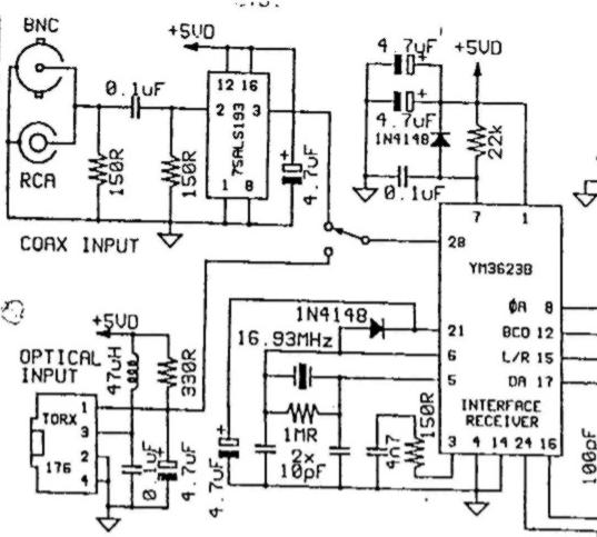

I'm not saying that clock being distorted. I say that the input circuits make such distortions that the modification of clock will not give good results. First, you need to modify the input circuit, then all the rest.The simple clock mod is there to prevent the entrance circuit from clock distortions.
Sry for my misunderstandable reply. Here's a more untwisted sentence: The clock mod is there to disable the clock from the entrance circuit when it's not more needed (it's only needed for triggering to an incoming new data stream). Without the mod, the entrance circuit will be disturbed by the (additional) working clock (it's described in this thread before, read it from the beginning!). The entrance circuit (input receiver chip ym3626b) outputs also the spdif stream, so output can be disturbed when the ym3623b gets clock signals when it's already locked to the data stream.
Sry for my misunderstandable reply. Here's a more understandable version (?): The clock mod is there to disable the external clock from the entrance circuit when it's not more needed (it's only needed for triggering to an incoming new data stream). Without the mod, the entrance circuit will be disturbed by the external clock. The entrance circuit (input receiver chip ym3626b) outputs also the spdif stream, so output can be disturbed when the ym3623b gets external clock signals even if it's already locked to the data stream.
I do not argue with that. You're absolutely right. I'm talking about something else. I say that, in this device, very poorly made input circuits. And before you do other modifications need to fix it.Sry for my misunderstandable reply. Here's a more untwisted sentence: The clock mod is there to disable the clock from the entrance circuit when it's not more needed (it's only needed for triggering to an incoming new data stream). Without the mod, the entrance circuit will be disturbed by the (additional) working clock (it's described in this thread before, read it from the beginning!). The entrance circuit (input receiver chip ym3626b) outputs also the spdif stream, so output can be disturbed when the ym3623b gets clock signals when it's already locked to the data stream.
