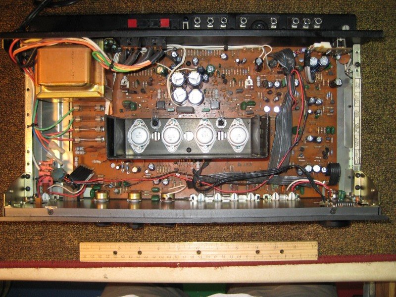

i have an nad 3020a, or it might be a b, how do i tell? the model number on the back just says 3020, but the internal layout is significantly different than the 3020.
anyways, i bought it for $10 at a pawn shop a few years ago but kinda forgot about it, now i want to get it working. when i turn it on, all 4 fuses stay put of but all i get from the speakers is a steady, repetitive and loud pop and the volume power leds light up from 1 to 35 repeatedly.
i am somewhat of a novice with electronic repair. i took a course in high school, so i know the basics(identifying parts and what they do) and am not afraid to break out a soldering iron. i am ok at reading a schematic, though i am no expert.
i am also going in this blind since i cannot find a schematic or service manual for the 3020a. i did some quick tests on the output transistors, along with a few others with a multimeter.....i found 2 2SD669a transistors that appear to be shorted(the reading on the meter was only 130).......but again, i am no expert.

thanks in advance for any help. attached is what the internals of mine look like:

There are a number of versions.
Early service manual:
http://p10hifi.net/planet10/manuals/NAD_3020_ServiceManual.pdf

thanks, is the 3020b the same as the 3020a? i know mine is a different layout that the one in the service manual you posted.

You need to check semiconductors out of circuit... that "130" may be a reading affected by low vaue resistors around the device.
Personally I would try an confirm where the fault lies first if possible. Alo always power up with a 100 watt filament bulb in series with the mains to limit any excess current flow while the amp is faulty. Far better to see the bulb light than to blow the outputs

well, just an update here. upon removing the bottom cross bracket and looking underneath it i found my problem, cracked pcb. i found all the cut traces and jumped them with wire, it turned on and worked. i decided to replace all the caps anyways(since i had them), found a few that didn't look too healthy. i didnt bother replacing the output transistors(if they work then there would be no point, right?).
tomorrow i will hook it up to some quality speakers and a quality source and see how it sounds. one thing i did notice is that the amp part does not kick in until a few seconds after i turn it on. i can hear the sound, but it is not amplified right away. i don't know if this is normal or not for this amp....
