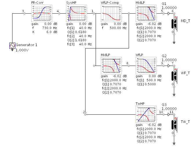

2.5-Way target with 100% coherent phases. Shown is
- synthesis circuit

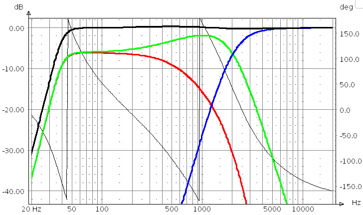

- SPL responses (with total phase)

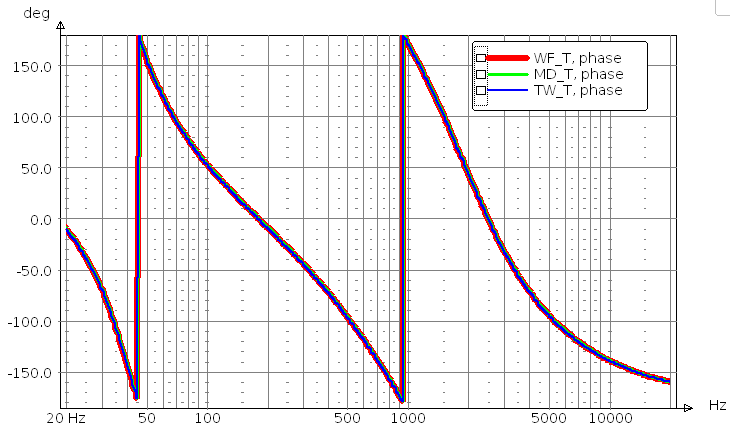

- Phase responses (which are all the same and identical to the total phase)
System highpass is Bu5@40Hz, Butterworth 5th order (equivalent of ported bass with 1st order protection).
Woofer roll-off is LR2@500Hz, Linkwitz-Riley 2nd order.
Mid-to-tweeter XO is LR4@2000Hz, Linkwitz-Riley 4th order.
This would be a usable target for a small 2.5-Way with 4"...5"-midwoofers and a nice, low-Fs 1" dome.
The key point is that the woofer low-pass (WfLP) phase contribution is mimicked in the allpass cell (WfLP-comp) in the midrange and tweeter paths. The total phase contribution of the XO is that of a 3-way with LR2@500Hz and LR4@2000Hz, so this is where the (small) penalty is. But excess phase can always easily be removed with FIR-phase-unrolling applied to the source signal.
Of lesser importance here (because the Mid-Tweeter XO is high) is that the system highpass is applied to all ways.

In SL's pictures - why for both bandpass driver networks (W) and (M) - is W lower in amplitude vs. M when both are direct from source (not cascaded)? Why is W automatically lower? Shouldn't M suffer the same fate being a bandpass also? or is SL's argument the longer wavelengths provide more opportunity for destructive phase lowering output between SW - W - M?
The drop in level is going with the inverse of the distance of surroung XO point freqs because phase mismatch is larger and the sum (which is a vector sum, then) drops. With 90° phase mismatch, for example, the sum of two equal sound pressure magnitudes is only sqrt(2)=1.41 times the magnitude.
Probably I am misunderstanding something here, but if we go back to Robbin’s original VituixCad picture in post 1, we have a (sub) woofer, crossing over at 120hz with 24 dB octave. Now this driver is further rolled off at 1000 Hz and 10000 Hz.
At 1000 Hz this (sub)woofer is already 62 dB down, then rolled again with 24 dB/octave. Then, again, when this (sub)woofer is below -100 dB relative to its passband, it is rolled off again with 24 db. So final steepness above 10000 Hz is 62 dB/octave
If I understand it all correctly, the idea is that that introduction of further phase shift in the stopband, way past any reasonable level ( past -40dB!) would contribute to better system integration.
To be honest, I do not see that immediately. In a twoway-system, yes, its is relevant.
But here, in a 4 way? Would not the passband phase characteristic of the “active” driver in question determine system phase behavior only, whereas the drivers in their stopbands do not contribute anything to system behavior below minus 40dB?
It also raises the interesting question as to how much attenuation in the stopband of a driver would still affect any system contribution. In other words: are driver anomalies below, say, -40 dB, irrelevant?
Maybe Robbin and KSTR can shed some light on this.
