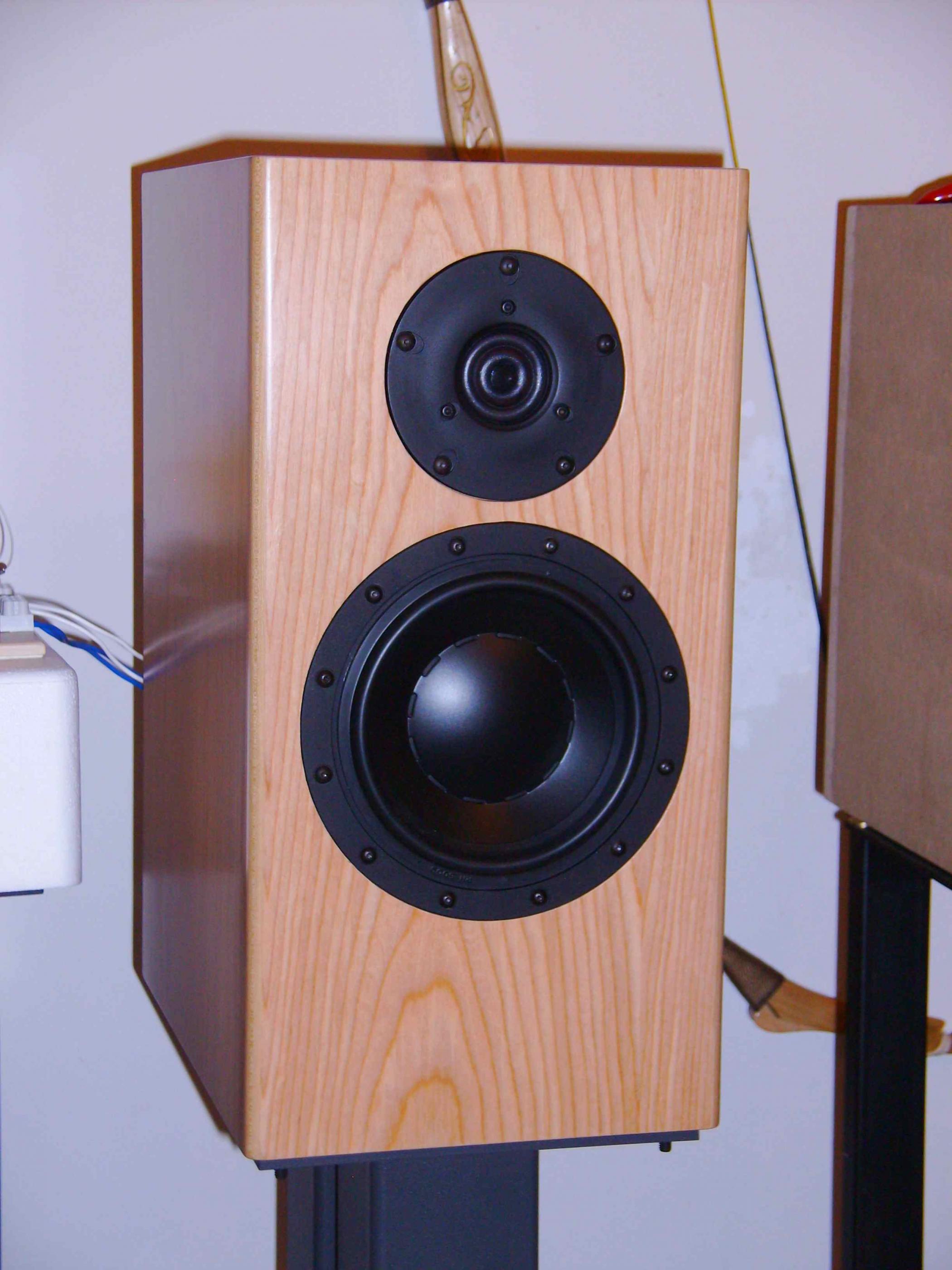

A cheaper alternative of push-pull isobaric principle is a clone of the Totem Mani-2. Read the Stereophile rewiev first...... The original uses Dynaudio woofers, the clone (same box size, slightly different tuning) Hi-Vi D6.8-s. Sensitivity and impedance are pretty low (around 83-84 dB, and 3 ohms), but the bass for the size of the box is astonishing, in-room you can get down to 26-28 Hz.
