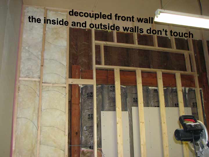

I did all the drywall myself. My very first time doing it. I've worked construction before, decades ago, and saw a lot of drywall go up. But I had never hung a sheet. 11 foot ceilings on the listening room side didn't make it easy. Yes, taping and sanding is awful! Never want to do that again. Painting is a joy compared to that.
OK, after the window was removed and patched, the floor poured and the garage door removed, it was time to move on to the walls.
The side walls were covered in cedar singles that had to be pulled down - you can see them in some of the photos. A "shingle ripper" came in handy here.

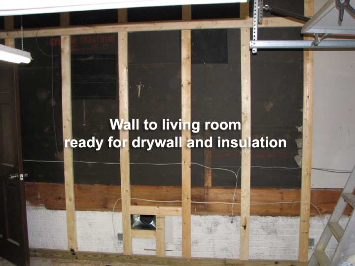

Once the were singles gone, then up went the furring strips on the wall between my listening room and the living room. Used 2x4 studs on their flat side. This was an exterior wall, but I added the furring to give me room to run wire, install receptacles and put in insulation for sound proofing. The wall is about 8" thick, now. I should have wimped out and bought a framing air gun for all this work, but instead did it all with a nice classic framing hammer - bam, bam bam! Didn't even smash a finger while framing.
I painted the brick and the new floor with DRYLOK paint to keep things warm and dry.
The front wall that faces the street was a big source of noise. Having read in the "Master Handbook of Acoustics" that a decoupled wall could reduce that noise by as much as 52dB, I decided to do that. So a new wall was built about 1.5" from the existing wall (where the garage door was). Only touching at the ceiling and the floor they are nicely decoupled. Insulation went in both walls to about an R30. They look like they touch in the photo, but they don't.
I framed in a space for a glass block window that will go in when the weather gets better. You can see it in the pix.
The decoupled wall really does work. It kills all but the lowest, loudest sounds. Much more traffic noise comes in from the door and window on the back side of the house now.

"It kills all but the lowest, loudest sounds"
Guess that means when the teenagers with the body panel rattling stereos in their cars go by, the wall doesn't help much!😡😡

The rolling boom boxes on the street can still be heard, along with the rumble of trucks and buses. But I don't know how much of that is my decoupled wall and how much comes thru the storage room doors, the rear window, the roof. But it's much, much quieter than before. I can now hear my tinnitus in the room, and it needs to be very quiet for that (luckily). The least bit of music covers all that up. My Radio Shack SPL meter does not register most of the noise.
The house is one block from the fire station. I still hear the fire trucks, but they don't really bother me. Sound proofing is a big, expensive job. On a noisy street like this, I just do my best and turn up the music. 😉

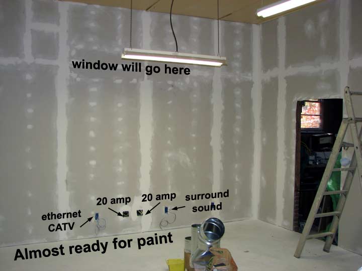

The Electrics
Since the room is a complete redo, the electrics need to be updated, too.
True to its garage heritage, the electrics were pretty funky. At some point in the past a 220V 30A sub-panel had been run to the area marked "Workshop" on the floor plan. 2 hots and neutral, but no ground - in a simple panel with two 30A fuses. Everything ran off that. Plus later 2 120V circuits had been pulled for a freezer. I"m not using those at the moment.
I have left the main 220V run but installed a new breaker panel. A new ground is run back to the main service panel. The new remote breaker panel in the room has 6 circuits:
  1. Wall receptacles
  2. Main wall 20A
  3. Main wall 20A
  4. Lights
  5. Work shop
  6. Spare
Behind the amp rack I have the two separate 20A circuits with 4 receptacles each. I don't need all that power, but it was easy to install. So 8 wall plugs just for the audio. The circuits can not be all run full load, as each leg to the room is breakered at 30A in the main panel, but I can't think I'll ever need that much. I did buy "Professional" grade receptacles for the audio circuits. Not fancy hospital grade, but very sturdy stuff that makes and keeps a good connection. The cheap ones don't.
Also on the same wall there is 1 CAT5 line coming from the router inside the house and another going to the back wall behind the couch. Cable TV is in the same wall box. I doubt I'll use the cable, but you never know. In a box on the right are the two surround sound speaker lines that go to the back of the room about 8 feet up.
Rear wall has 3 receptacles, telephone and CAT5.
The overhead fluorescent work lights have been replaced with 2 nice drum style lights. You can see one in the photos. They give a nice glow to the room.
Tell you what, with the price of cooper what it is, wire is expensive!

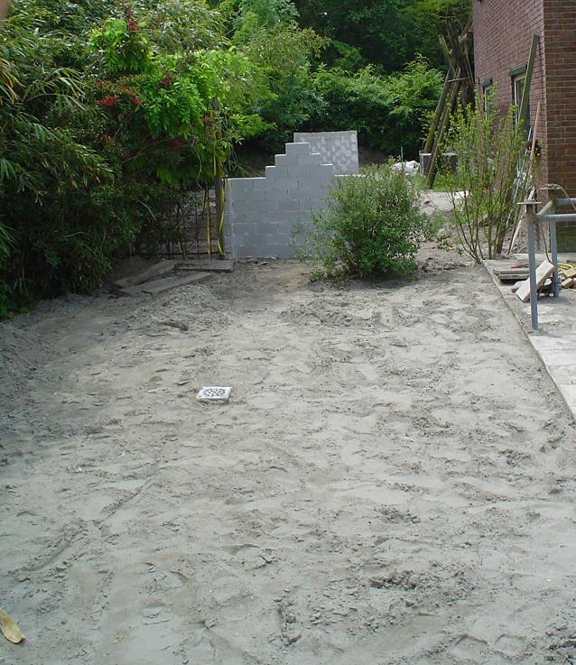

Pan-o-Man.
nice work, always interesting how you guys construct homes.
(my latest fling is acoustic socker panels and exterior landscaping, the gents drove me up the walls with their banging, arty farty paint finish scheduled for 2k11 summer break)

What you making there, Jacco?
Yes, North American house construction does seem "flimsy" compared to a lot of what I saw in Europe. I did a few renovation projects in France and everything was much more solid and heavy.
