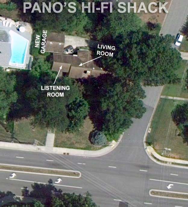

OK, a couple of quick images.
A recent shot from above (this summer) and the floor plan. Floorplan is flipped 180 degs. More later!

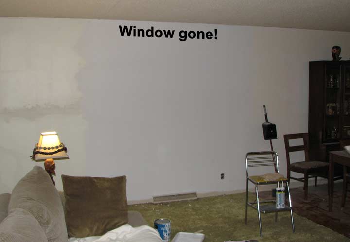

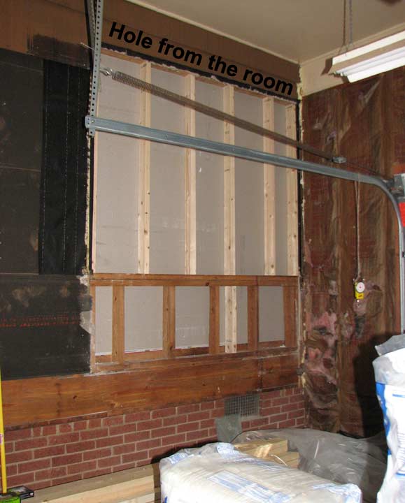

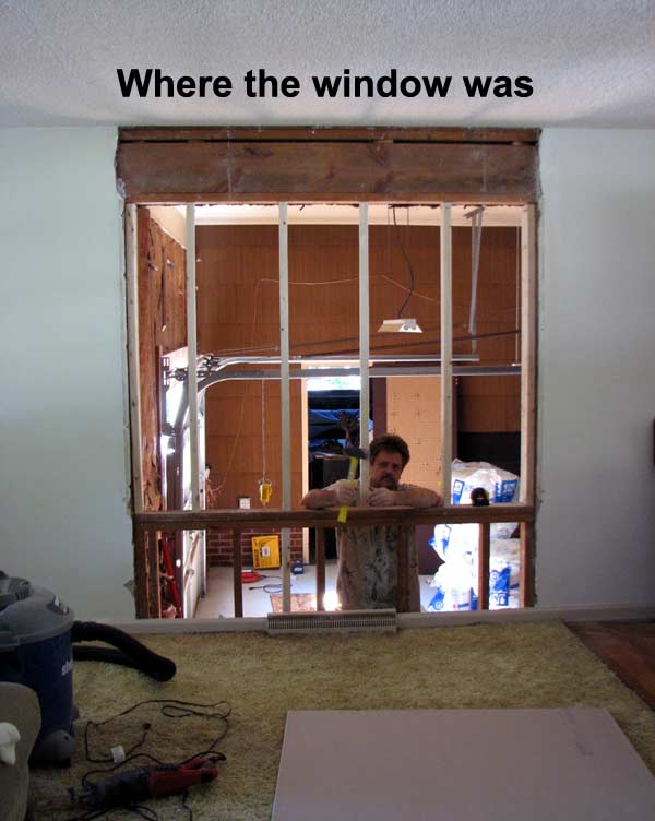

First thing to do was get rid of the large window from the living room into the old garage that had lived behind heavy curtains for years. That got pulled out and walled up. You'd never know it was there, now. The living room also got a facelift, that 1970s green shag carpet is now long gone.
You can see a bit more of the old room thru the big hole in the wall.

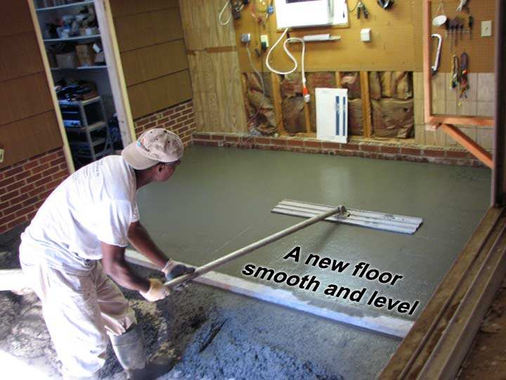

The concrete floor was not level or even and cracked. So a new slab was poured. More than 4" thick in some places just to get it even. Here is a pic of the new slab going in. This is a task I did not feel up to doing myself.

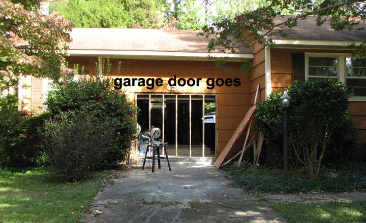

Also needed to get rid of the garage door as it let in cold, heat and a lot of noise. The street in front of us is busy 20 hours a day. It was very annoying. Below is a shot of the garage door being framed in. It is gone and cedar single siding that I pulled out of the room in its place.
