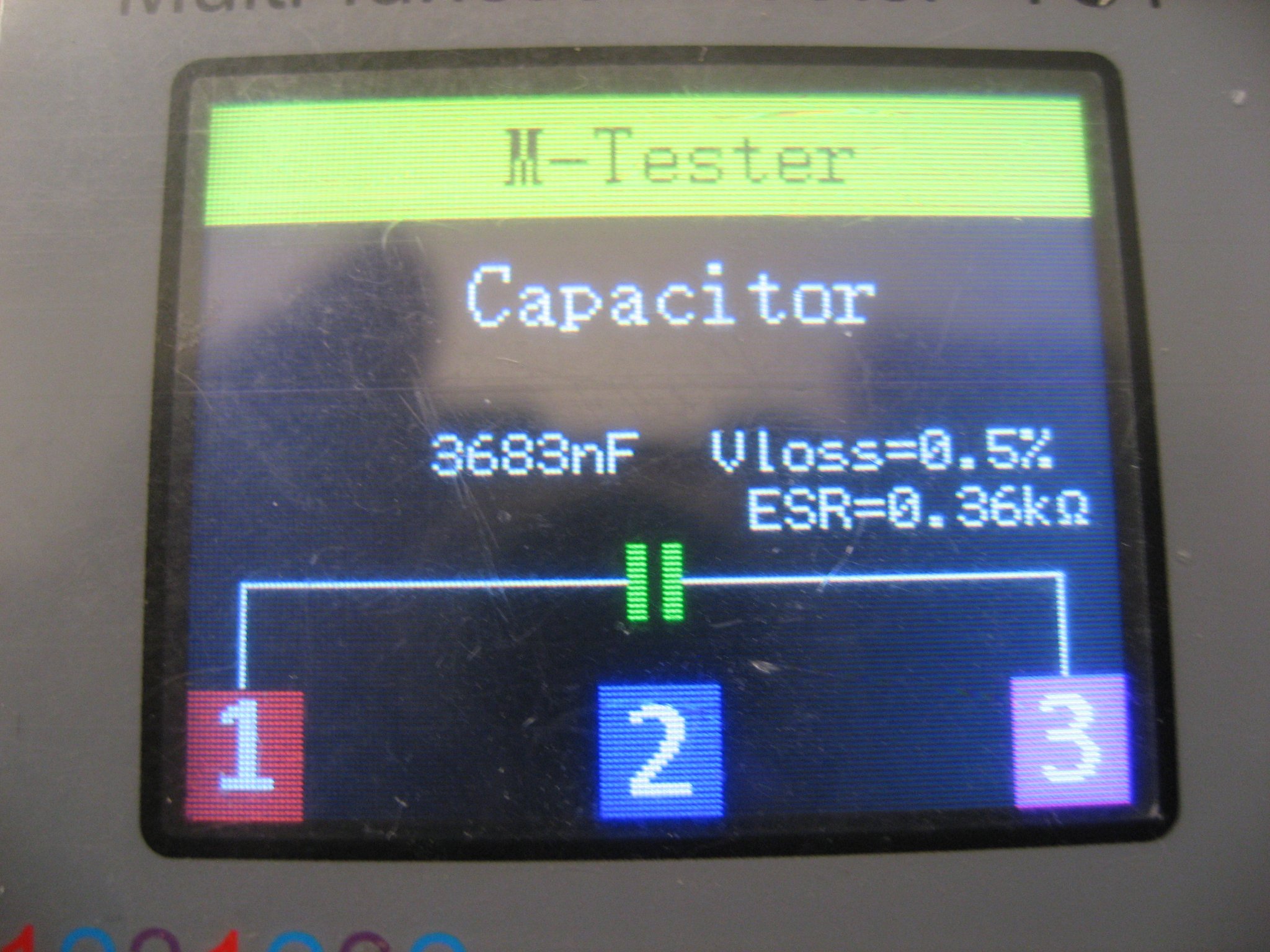

Kind of difficult to believe this - never yet seen a new capacitor with 360 ohm ESR.the device I have displayed an ESR for the UPX of 0.36k ohms which my math says is 360 ohms.
If the datasheet states also so then that is the way these were designed. Usually the new capacitors are smaller than old ones.brown 35V 3.3uF UPX is much wider than the 25V 3.3uF orange Elna.
Your comment made me double check. My eysight is not what it was and the characters displayed on the component tester screen are small.
But yes, for that new, brown Nichicon 3.3 ohm EXP series, 0.36K ohms, 360 ohms, is displayed on the screen.
I realize that the tester I have is not the most precise instrument on the planet but it has shown believable and mostly consistent low ESR's when checking the old original capacitors as I removed them. That is also true of the new UKL capacitors I installed to replace the orange Elnas with values other than 3.3mF.
If you take random half a dozen other capacitors of roughly the same capacitance then what does the device show?
Can always be that the new capacitors are defective...
Or it may be a device software glitch...

When I made my selection for the 3.3 ohm capacitors I received, I used filters on Digikey's website. The parameters I used provided 6 or 8 choices and I did not scrutinize extereior dimensions. If I did, I probably would have picked one of smaller girth.
Well, that was somewhat intersting. I ran through all ten of the Nichicon 3.3uF I received and six displayed 0.036K ohms. The other four displayed 0.35K ohms.
I have an assortment of 63V 2.2uF and 4.7uF capacitors and spot checked some of those. FWIW those 2.2uF and 4.7uF had what I guess could be called expected physical dimensions.
Except for one, all I tested displayed 0.36K ohms. The oddball was 0.0 ohms

If you repeat these measurments e.g. three times and get the same results then I would say that those other four are defective.I ran through all ten of the Nichicon 3.3uF I received and six displayed 0.036K ohms. The other four displayed 0.35K ohms.
It does seem the TC1 multi-component tester is of no value when checking for ancillary data.. As I went through replacing all of the electrolytic caps except those involved with the tuner, that 0.365 ohm ESR reading was displayed on numerous old and new capacitors.
I primarily got the tester as it was recommended for doing quick checks on transistors. Good transistor or bad transistor. I did use it too to assess capacitors but only their capacitiance. I knew it was supposed to display ESR but I looked at that as a bonus feature. And that feature has proved itself worthless.
I'll admit to having little in the way of test gear. I don't really do enough DIY to make owning adequate equipment worthwhile. Plus I do not have the means to purchase such things so what little I do have was at the budget end of the price spectrum. Or used. Well and truley used.

Money does not always "talk" - I have been using LCR-T4 tester (from eBay) for many years now and it has so far worked reliably.It does seem the TC1 multi-component tester is of no value
Yes, my comment was undeservidly harsh. The main reason I acquired a TC-1 was to quick check if a transistor was bad or good.
And it will display capacitance and resistance so it is good for that. But even though it claims to measure ESR, what I've seen it display is the same ESR value for nearly every capacitor I connected to it. That makes me suspect it's ability to measure ESR.
