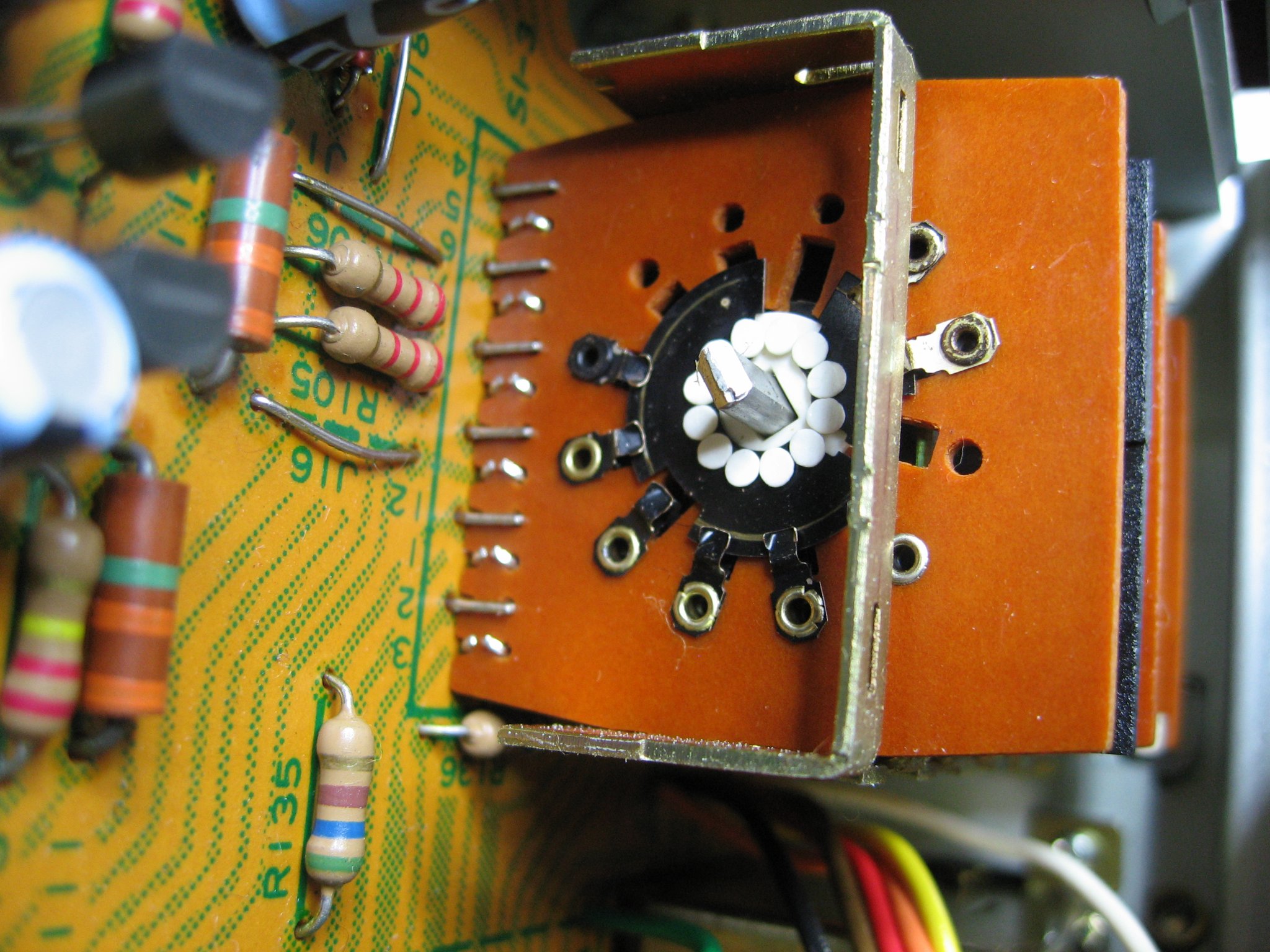

Afterwards, as far as I could tell, the receiver worked well. That is until I gave it an extended listen while playing LP's during which the volume periodicaly dropped slightly at random intervals. It was akin to turning a 10dB loudness switch off then engaging it again. The sound would recover, play normally for a short time then drop again. That cycle repeated over and over and it seemed to occur on both channels simultaineously. It also occurred with more than one input source.
Not kowing where to start looking, I first considered the input selector switch and took as good a look as I could with an illuminated magnifier. I could be mistaken but I was expecting the contact surfaces to be shiny metal but they are black.
The photo is of the switch in situ.
If someone would care to comment if the section of the switch that I was able to photograph looks normal or not, it would be appreciated. To my eye, it sort of looks like paint.
Is it supposed to be black?

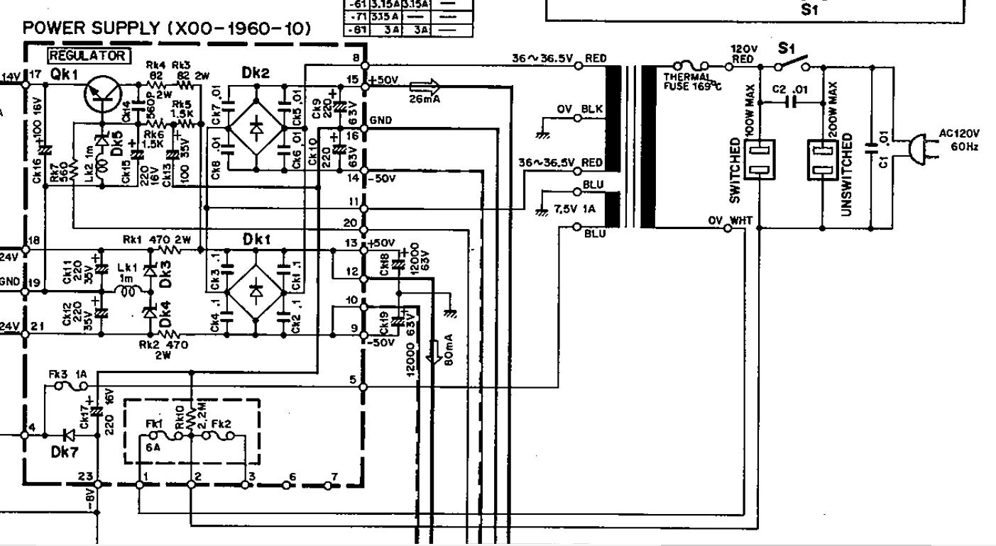

The two large filters caps are normally the first that are replaced as these have "suffered" the most normally.
Looks to me like a solder crack near the loudness switch circuit or the contact cleaner did not do a proper job.It was akin to turning a 10dB loudness switch off then engaging it again. The sound would recover, play normally for a short time then drop again.
This power supply has actually two separate rectifier bridges supplying the power output stage - I would refresh their soldering and also the inter-board connecting power cables joints.The two large filters caps are normally the first
Yes the 2 x 12000 uF suffer the most normally. Highest inrush current too. The 2 x 220 uF at the other rectifier bridge can be replaced for 2 x 470 uF.

Reflow of all solder joints and disassembly of all switches is almost mandatory at this age. Until that is done other advice seems redundant. Cheap hoarded old audio devices are real time eaters. And since they are never alone the time must be multiplied by the number of devices. A normal person does not have that time so the general pattern is then 30 devices with each at least one complaint.
If the device has a loudspeaker relay that one is also prone to failure as japanese brands excelled in choosing the wrong relay for the purpose.

The presence of two rectifiers is noted. I did not realize that. And a good point re the interboard connectors. I will pay attention to those.

No...... They´re not.Yes, they are plated and are that colour.
From the beginning, these are silver plated.
Turning black is oxydation, whitch is pretty bad on this one.
The most annoying/difficult places are, if the oxydation affects the contact points, where the "rivets" go through the pertinax.
Can (maybe) be fixed by first cleaning them with a fiber glasss brush and carefully soldered together.
You can see a few rivets are not affected. All the metal parts in the switch function are supposed to have that same color.

They are silver plated, correct. They are also self cleaning. Look closely at the clean portion where the wiper wipes the contact.
Silver, like silver cuttlery, tarnishes but even the tarnish is a good conductor of electricity. (Ask anyone who knows about Germanium transistors and BGA soldering with lead free solder).
If they are loose, they will be intermittent. If not I expect a dry joint or relay issue.

Sorry, but with all due respect this argument does not sell. The "clean portion" is existing only due to mechanical wear caused by the wiper.They are also self cleaning. Look closely at the clean portion where the wiper wipes the contact.
And that wear does not happen under the rivets.

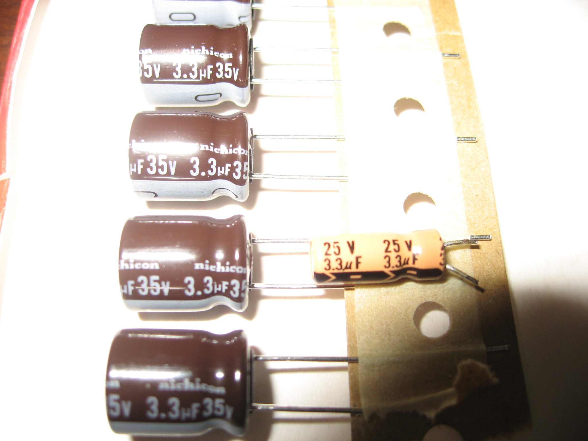

I removed one of the 25V 3.3uF Elnas, and tested it with a device that provides some data on capacitors. I did likewise with a 50V 3.3uF Rubicon:
Original orange 25V 3.3uF Elna - 3170nF - ESR 2.5 ohms - Vloss 2.4%
Rubicon 50V 3.3uF - 3240nF - ESR 6.7 ohms - Vloss 2.6%
Does the higher 6.7 ohm ESR of the Rubycon disqualify it as a replacement for the 2.5 ohm ESR of the Elna? Since the Elna is 47 years old, should it be reinstalled?

Geez, replace these for "anything". If film caps are too costly then any new capacitors (from respectable suppliers) will do.Original orange 25V 3.3uF Elna - 3170nF - ESR 2.5 ohms - Vloss 2.4%

Thanks. I appreciate the advice and will take it. But I would like to excercise some care in making my selections.
The tally of orange jacketed capacitors that I would replace is 14. I began costing out replacement film capacitors on Digikey's site and soon learned that their cost will excede what I am comfortable with. So new capacitors will be electrolytics. I would go one voltage step higher than the originals but keep capacitance values the same.
Since those orange jacketed Elna's are "low loss / low leakage", should I be trying for the lowest ESR values I can find? And what exactly constitutes low ESR? Is there a treshhold number that a low ESR capacitor must be below?
As mentioned in my first post, the ESR of the existing original Elna 3.3uF cap which I was able to measure is 2.5 ohms. And that the small Rubycon 3.3uF cap I have on hand is 6.7 ohms. Navigating the Digikey site using basic specs for 50V 3.3 ohm capacitors produced a selection of 8 candidates. Only one, the least expensive option, has an ESR value attached to it and the ESR number cited for that one is 80.381 Ohm @ 120Hz.
The other seven choices had no ESR values displayed.
How would I make an appropriate choice?
The 14 orange jacketed Elna's are comprised of 4 different values. Since ESR values are not disclosed on Digikey's site, are there certain brands or a series within a brand that I should focus on?

My request for recommending capacitor brand / series can be ignored. I ordered Nichicon UKL series for all but the 3.3uF.
For that value, I ordered UPX series as there were no UKL series on the Digikey site. I will either install those or maybe those Rubycon's that I have on hand.

My capacitor order arrived from Digikey earlier today and the first ones I intended to install were the 3.3uF Nichicon UPX series I received. As previously mentioned, I ordered UPX series in lieu of UKL series because Digikey had no stock of 3.3uF UKL. Digikey's site had UPX categorized as Audio Grade so I thought that would do.
They were my choice to replace the orange 3.3uF low loss / low leakage Elnas in the earlier photo which produced an ESR reading of 2.5 ohms on the device I have.
What I first noticed was a big difference in diameter. Although it will fit on the board, the new, brown 35V 3.3uF UPX is much wider than the 25V 3.3uF orange Elna. Plus the device I have displayed an ESR for the UPX of 0.36k ohms which my math says is 360 ohms.
If ESR is important, it would seem that I should not use this 35V 3.3 ohm UPX but rather use that small black 50V 3.3 ohm Rubycon depicted earlier. It's ESR of 6.7 ohms is a heck of a lot closer to the Elna's 2.5 ohms than the 360 ohms displayed by the just received Nichicon UPX.
It seems than that the designation "Audio Grade" when it comes to capacitors, does not mean an automatic low ESR.
Am I on a ghost chase? Should I be concerned about ESR? That specification is all but ignored on Digikey's capacitor descriptions.
Should the V-loss figure command more attention? Is that the "loss" attributed to those low loss orange Elnas?
The V-loss figure of that Nichicon UPX I just received is considerably less than the orange Elna.
