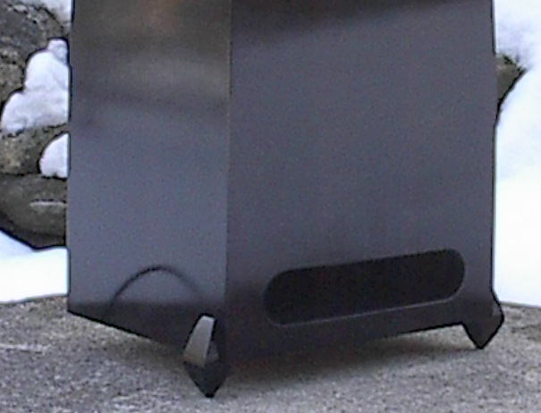

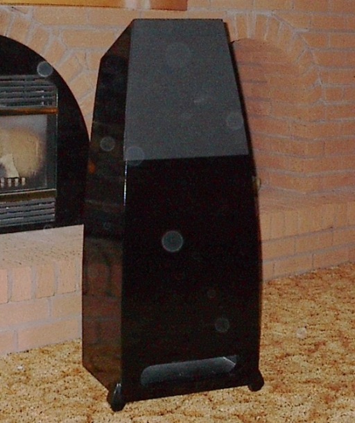

To be honest, I'm not sure why you attached that picture, since no details can be discerned.

My camera....
Here's a cropped closeup of it before polishing. Although of poor quality, you can see that there are no joints showing, as it would be seen in the reflection.
454Casull said:To be honest, I'm not sure why you attached that picture, since no details can be discerned.
My camera....

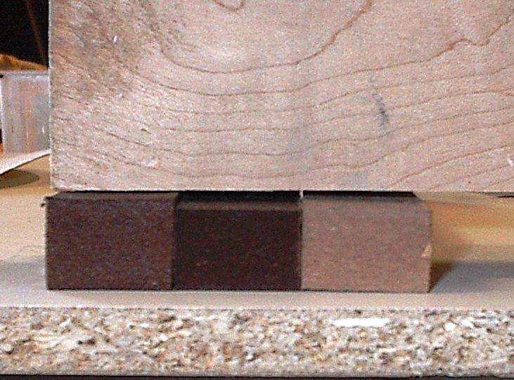

Regarding your stir stick, perhaps the lacquer you are using is waterbased. I will attach a picture below of MDF soaked for one hour in water and another in mineral spirits (as I mentioned in a previous post). It can be seen that the on soaked in solvent did not swell at all.

The picture shows three pieces of MDF, left is one soaked in water, middle is soaked in paint thinner, and right is a dry piece.

... I will attach a picture below of MDF soaked for one hour in water and another in mineral spirits (as I mentioned in a previous post). It can be seen that the on soaked in solvent did not swell at all.
It looks like that in the pic, but they are the same thickness. The one soaked in water swelled from 5/8" thick to 3/4" thick in one hour.

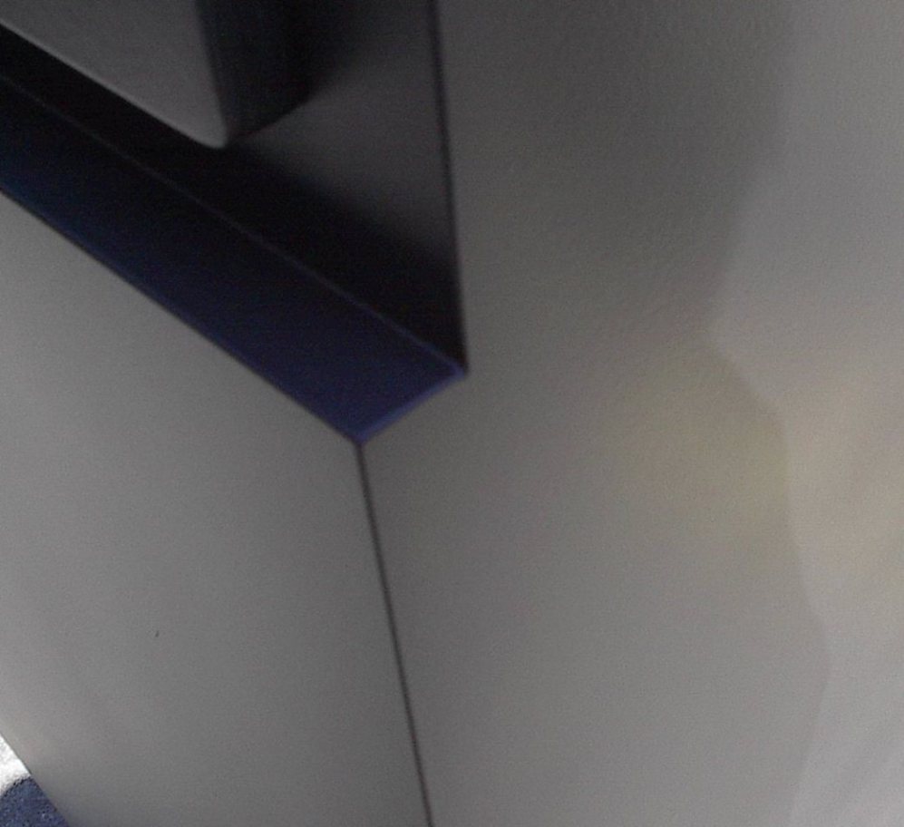

Below is a pic of a close-up of a corner on a box that I primed today. Taken will my POS camera.
