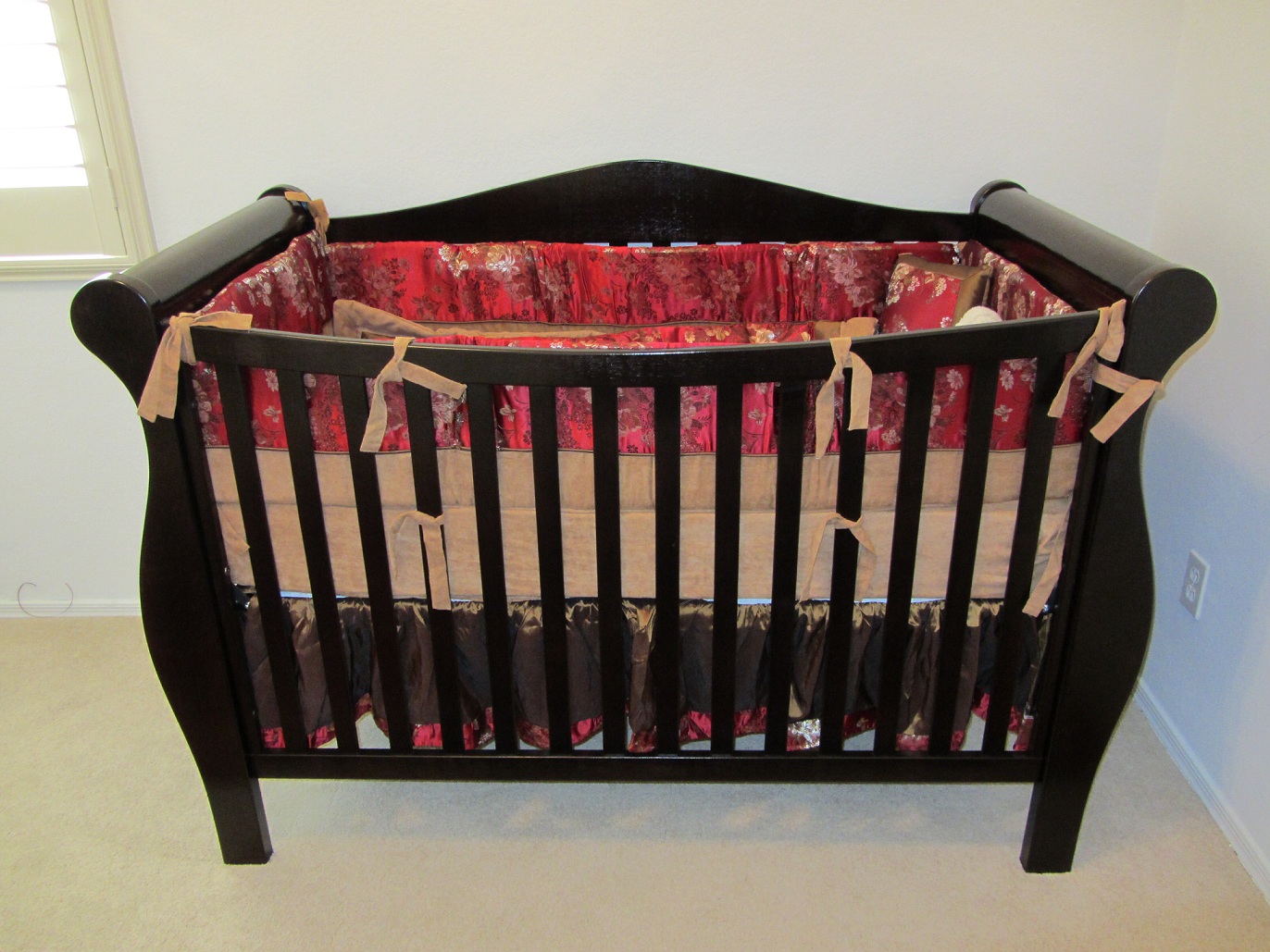

Not a speaker but still gloss finish. This was NOT polished out. Straight off the gun finish.
So-so vision and crappy monitor keeps me from seeing it very well, but the relatively sharp reflections implies a fine gloss finish!
GM
Renron crib looks awesome. I to almost always use waterborne spray. I like the general finish much more then the target coating. Seems to lay out nicer, less problems with fish eyes, and holds on better when sprayed on a vertical surface.
