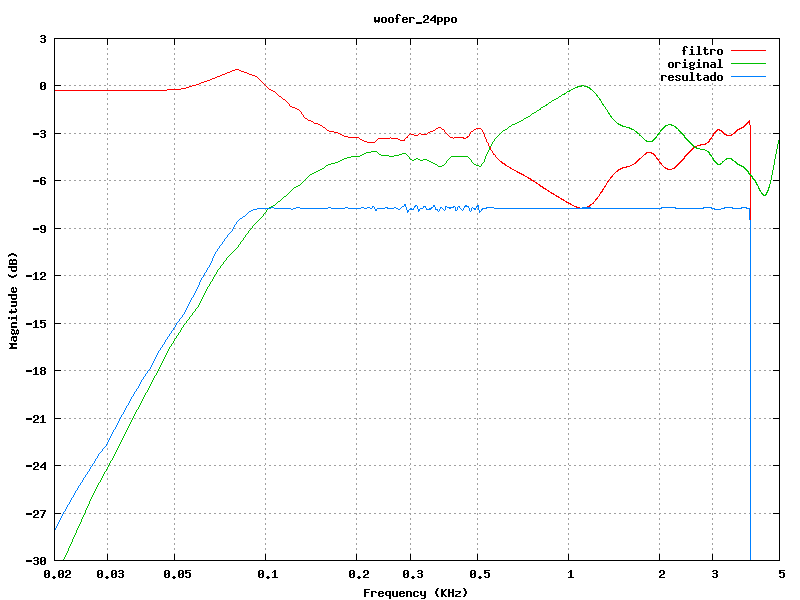

I'm using octave for filter generation. Octave can be used under windows installing cygwin.
Although I've not implemented arbitrary curve equalization, it could be possible to do a spline interpolation from a file in .frd format and generate the impulse response.
My scripts takes a measured impulse response from a driver, applies a minimum-phase correction equalization on a smoothed version of the magnitude response and then a high-slope crossover.
I've used bits of code from others, you can find some code in the DRC wiki site, and the octave scripts that comes with DRC.
In particular, managing PCM files in octave is taken from the loadpcm scripts in the DRC distribution. Thay are pretty simple, headerless row of 32 bits floating point values.
If you are interested in this approach I can attach the code. Anyhow, I plan to upload my files to the DRC wiki when everything gets matured.

Hi, I certainly will, and publish it in the wiki. I've found too much help there and I'd like to contribute as much as possible.
Just give me some time to document the scripts, as inline comments to user input are written in spanish, and it would be better to translate them.
Just a picture of what it does. The low end of the woofer would be better corrected against a user defined target function. Now it only makes a transition window to no correction, in order to avoid woofer overload.
Note the steep crossover at 4000 hz. It's a blackman windowed sinc, 16k samples long at 44100 Fs.
Yeah, that's a neat script that you have there. Please publish what you have now and fixup as you go along. The wiki is versioned, so it's a good backup as well
Basically what you have there is the equivalent of a TACT RCS system...
