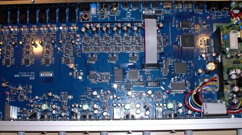

One downside I did note was that it doesn't have 192Khz capable DAC's. So my setup is better there, although its not something that I've ever used with current software - it likely to be important in the future though.
I'm still a bit shocked by it all and I'd really have liked to have spent more time with it in my system to get a better idea of all the features and sound but from what I've used/heard so far its a no brainer IMO for an economically high end setup.
I'm fairly sure they are 192Khz capable? Perhaps there was some config issue though?
http://www.rme-audio.com/english/firewire/ff800.htm
Great review though. Sadly there are no linux drivers for the FF either, and rumour has it that RME are blocking attempts to create one. Sad really
Ed
rme FF800 dac's can do 192khz . they use AKM Ak4396 dac chips , those are 192 khz compatible . i did some modifications on FF800 for friend . But if you wanna hear my personal opinion - there is no sigma delta DAC units on the market which can play in same league like good multibit paralel DAC's - AD1862 , PCM 1704 or PCM63 , and there is no really good integrated clocking units on the market (at least at reasonable price) .just my 2 cents .
