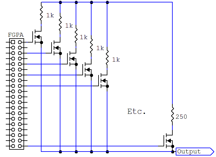

I looked into the work by Sandler et al several years ago and came to the same conclusion TacT seemed to capitalize on first. I feel your comments above precisely illustrate the salient issues.
At the same time, it would be interesting to benchmark against say the TAS5015 for comparison purposes. The problem with the TAS unit is general availability as well as no internal changes possibly by the DIY crowd. Your solution to this is very cool!
I also wonder if it is possible to use your board as a DAC unit unit - certainly your modulator is interesting, and if you could modulate say 64 outputs swithing at MHz, adding some randomness and having say 4 levels - all tweaked analog current sources, my belief is that you could make a killer DAC unit.
Petter
Making a DAC out of the current platform is fairly easy. However, the output stage would have to be changed, but since we designed the platform in a modular fashion, this is a simple task.
DAX Group
DAX Group
High end DAC out of this?
Consider attached drawing.
I have pondered over using an FPGA with a lot of outputs, some randomness (as seen by a dCs) + a couple of levels (say 4-24 units per bank, 2-4 levels in total 🙂). I never had the courage to start learning FPGA programming - but only having to modify a project is another kettle of fish altogether 🙂
I would expect switching at MHz interesting 🙂
Output stage is for demonstration only. JFET's and matched current sources are probably cheaper than ultra-precision resistors.
Let me know what you think
Petter
Petter
