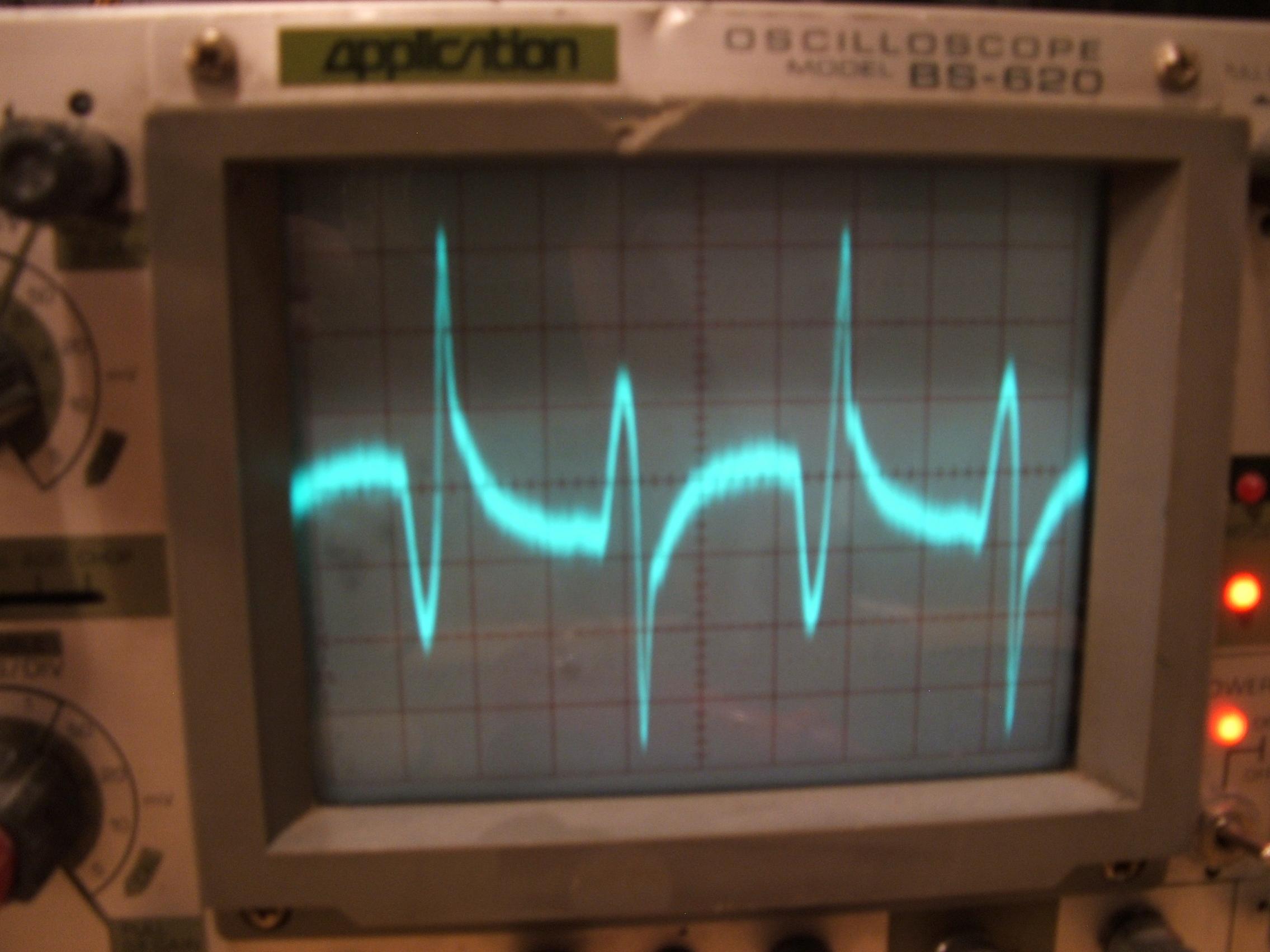

Those spikes look like charging pulses (plus possibly a diode switch-off spike), so the secondary/rectifier/cap loop is either generating a magnetic field or contaminating a ground.
Thanks DF96 (I assume you are referring to the last traces I posted), Both channels are sharing the same PS, bog standard single rectifier with two 8,000uF caps in parallel per rail. Star point is on the PCB and is shared by the two channels.... So I think that it has to be induced noise in this case since one channel is completely clean... The speaker connections are not symetrical with a long wire connecting from the right channels output to the zobel and speaker protection relay on the left channel side of the single PCB . Also the +- wiring for the right channel is longer than that for the left. I think that the combo of the transformer sitting directly under this channel and the asymetries are causing the problem.

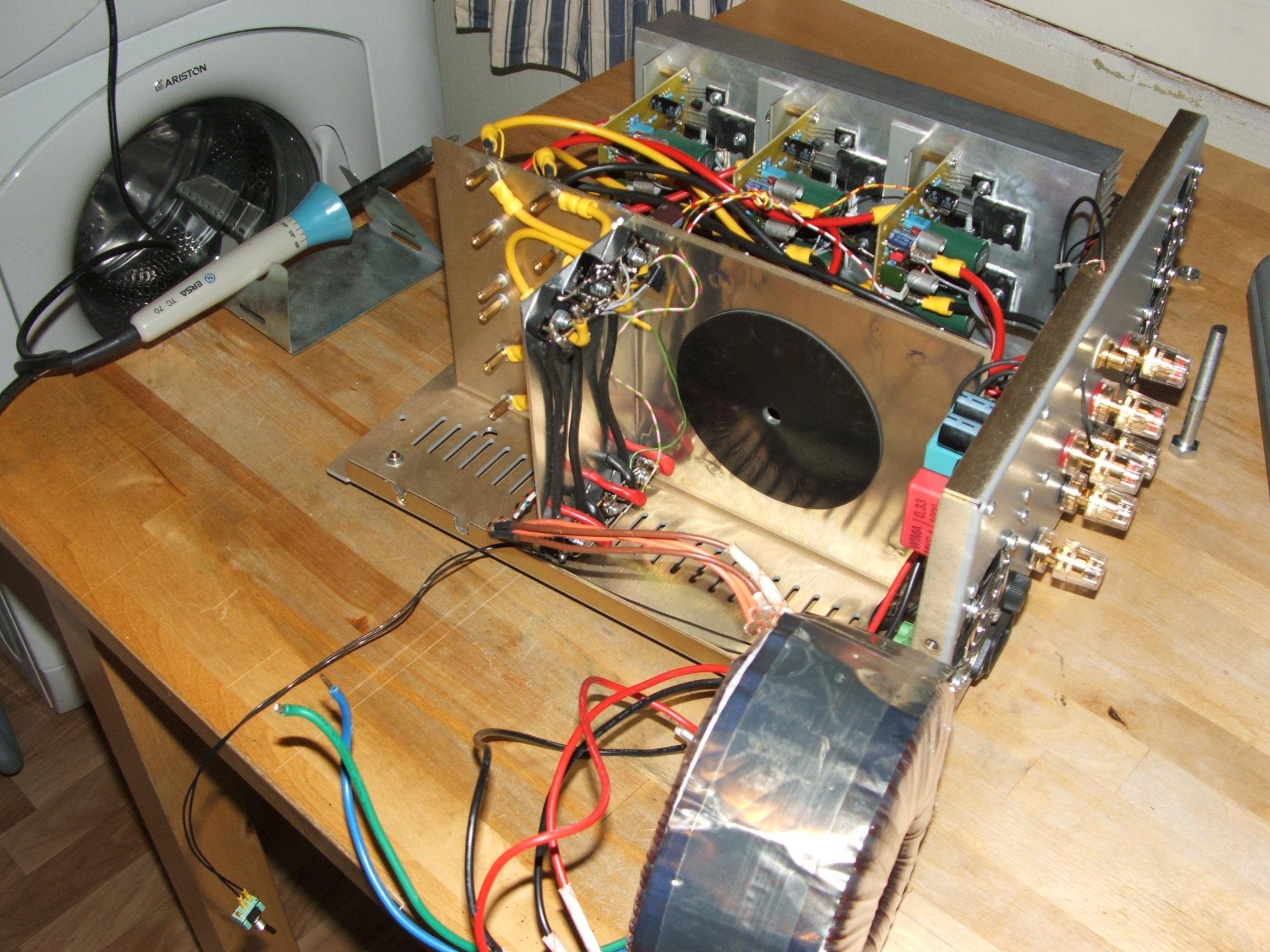

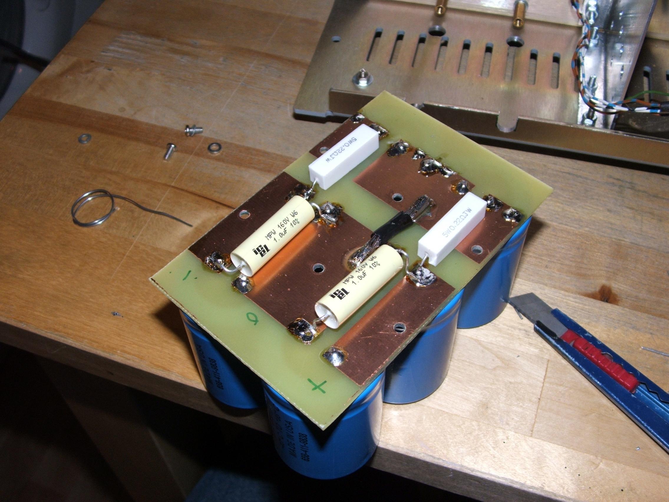

Finally the parts arrived, and yesterday I modified the PSU.
Enclosed are the immages of the teardown, capacitor card with "split" resistors and bypas caps added, and the new rectifier made from the super-de-luxe 60A fast& soft recovery diodes.
Completed the assembly today, and powered up.
On the side of the split capacitor bank connected to the rectifier, I measured about 400mV of ripple.
On the other side, i.e. in the part of the capacitor bank on the other side of the split-resistors where the amps are connected, I measured 50mV ripple.
This was with all thre amplifier cards drawing about 200 mA each of idle-current.
That's what I would call a significant improvement! 🙂

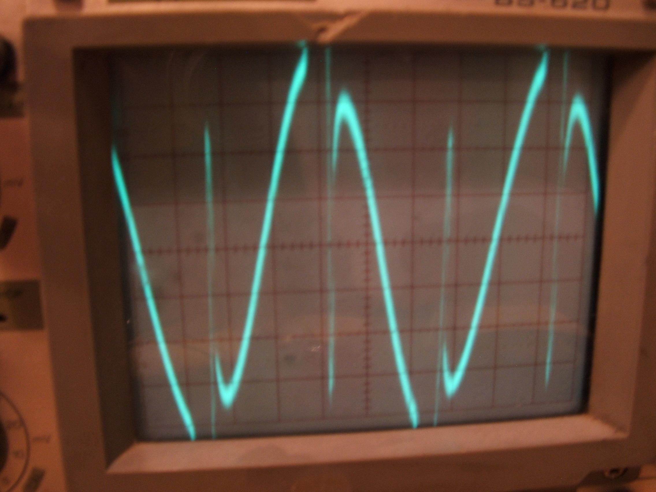

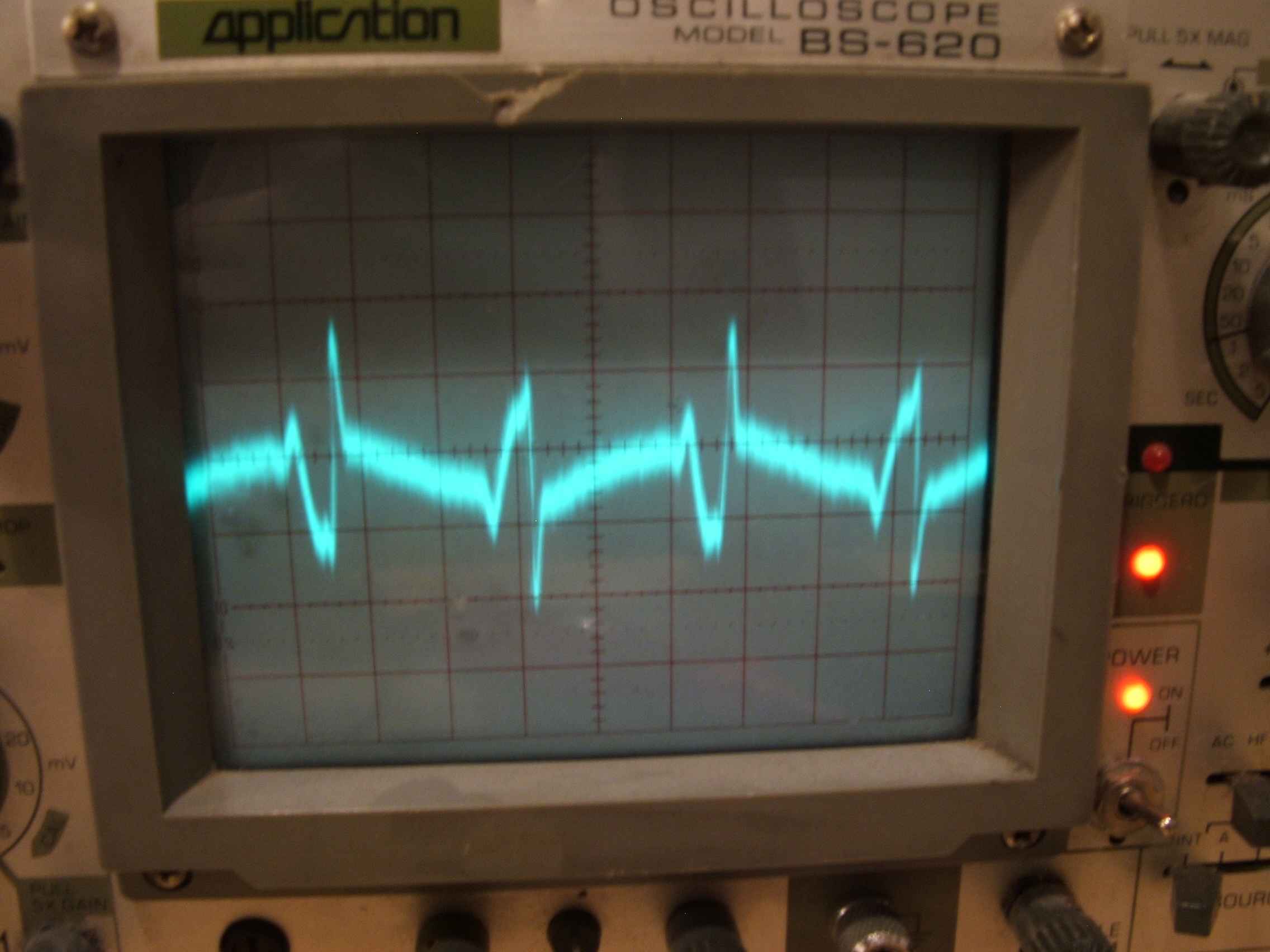

And here's the first measurements..
Scope set at 2mv/ div. and all the amplifier connected to the x-over card including sifnal screen.
Not too much improvement from previous set-up.
What is interresting to note, is the difference between the first amp and the second, and how that difference is reduced when I insert the strip of mu-metal behind the x-over card.
The output from the third amp is quite messy, anb the mu-metal didnæt make much difference here..
The third amp is situated closest to the transformer, and the first one furthest away.

Now, the first measurement shows the x-over card grounded through one signal screen only measured on the first channel.
Improvement here, but no change to speak of on amp 2 and 3.
The second immage shows the x-over card grounded from the PSU star-point and no screen ground connection.
This is quite noisy and not quite what I expected..
Perhaps I should try and ground the screens on the x-over card an disconnect the screens from the amp cards?
Now, after the rebuild, it became easier to move the transformer, so I managed to lift it out of the chassis.
As you can se from the immage, I couldn't move it that much but now it was at least not sitting virtually next to the x.over board.
This didn't really make much difference. When grounding the x-over card from the starpoint, there was slightly less noise on the scope, but not a change I would call significant as such.
