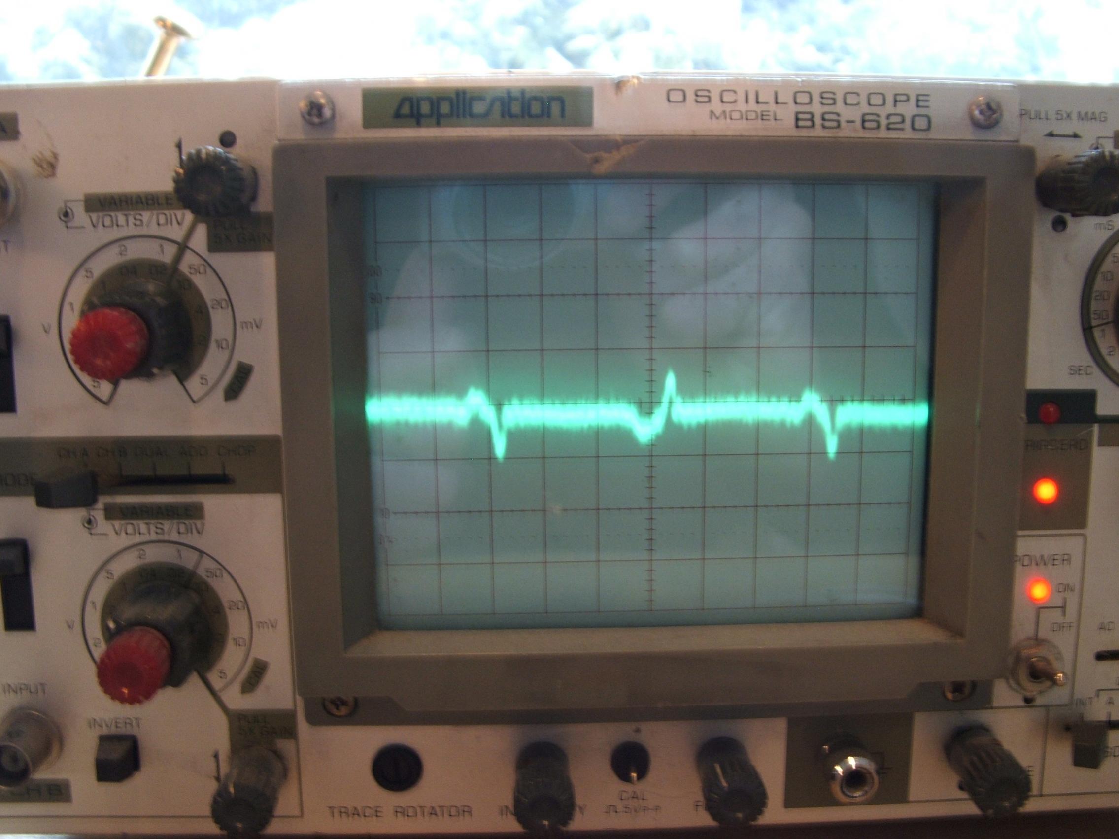

Anyway, I got the old scope hooked up and did some measurements.
It's not the best scope or digital camera, but hopefully, the images can give a clue about what's going on..
I measured on the output of the first amp.
First measurement is with the first card fully connected, the other two connected to PSU, but signal screen disconnected.
The scope is set to 5mV V/div and 2mS time/div.
The first measurement looks OK, about 4mV peaks, this is the hookup that gave virtually no audible noise in the speaker..

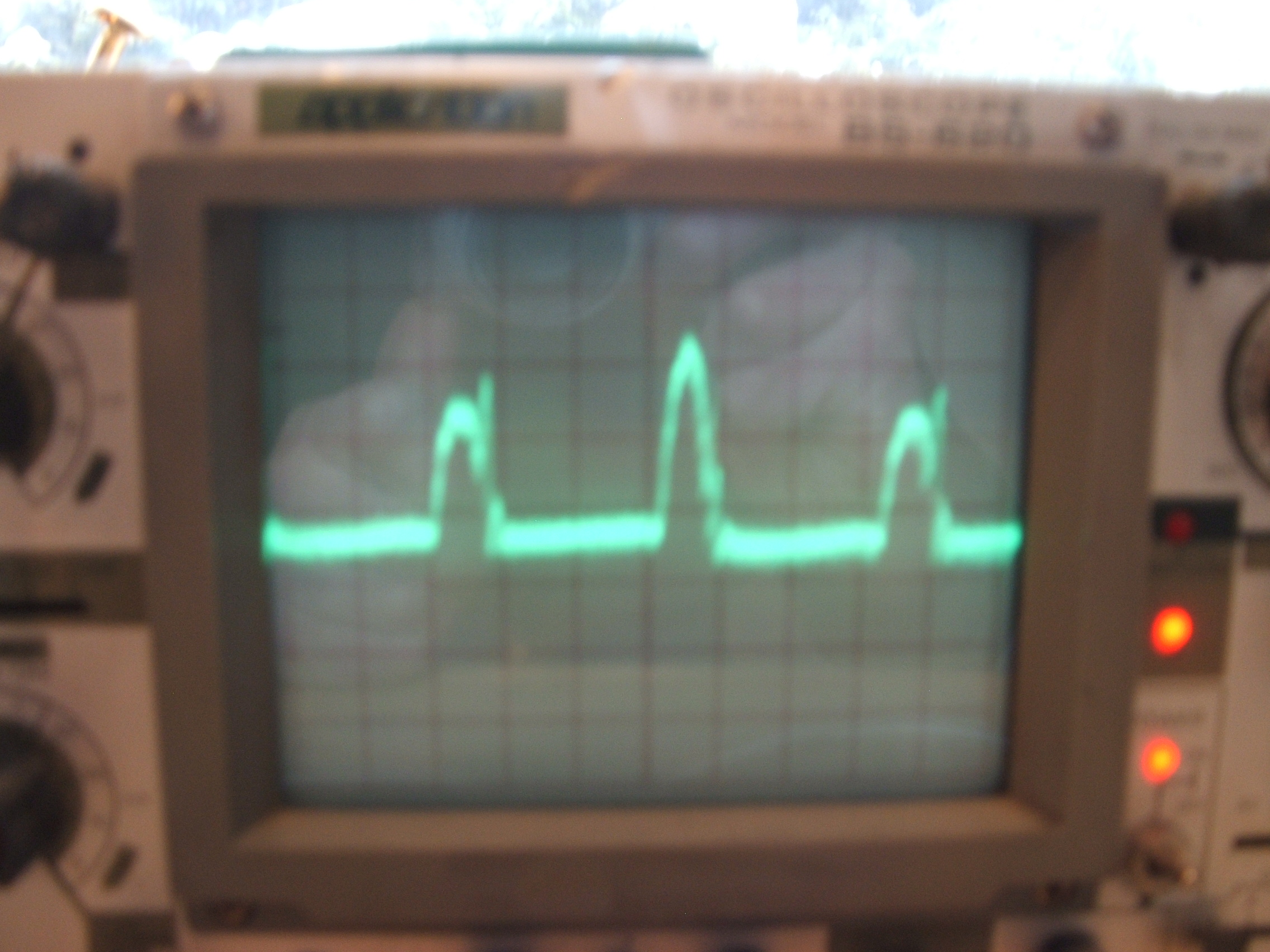

For the second measurement, I connected the signal cable screen on the second card.
Peaks allmost doubled and changed to positive sign only..

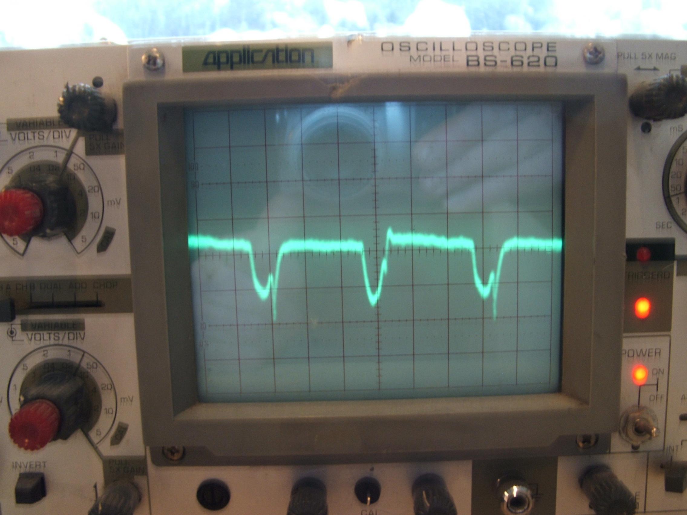

Third measurement; all cards now have their signal cable screen connected, peaks increase even further.
what could be going on here??

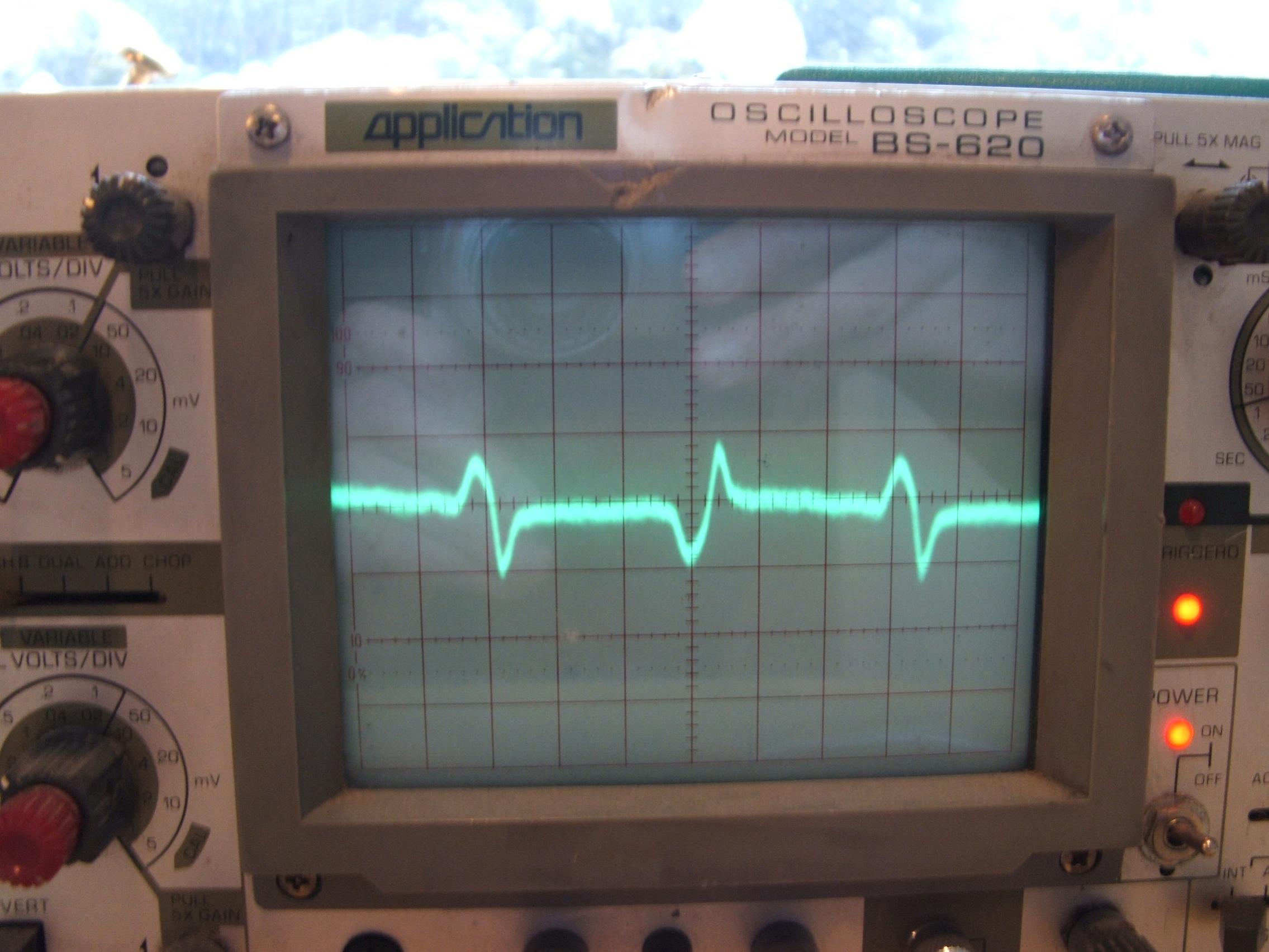

For consistency, I performed the same set of measurements on the second amplifier card as well..
Same tendency, the noise adds on for each addirtional card that gets connected to the signal cable screen.
But the interesting thing here is that the peaks change sign compared to the first card... 😕

Just tried with a 1 ohm resistor in stead of 39 ohms, and even with that, the ripple on the scope was barely visible.

Been trying to understand this issue in small steps..
Individually, the amplifier cards work well. Short the input on one card, and there is no noise on its output.
Non- shorted , there is a clean sawtooth on the output.
Connecting the input cable screens toogether, there is the same clean sawtooth on the output of all 3 cards.
Short all 3 inputs and screens together, and there is only a very faint ripple on the outputs.
If there was some serious isue with the power-supply, I would expect to see noise appearing at this stage as ground currents could now start to flow between the amplifier cards through the signal grounds and signal inputs.
But when the screens are connected to the x-over card, where they become interconnected through the ground tracks of the card, and the signal wires are connected to the X-over card, things get messy. Perhaps this is because the signal screns do not connect at a single point but on points across the card?
Tomorrow I'll see if I can devise a set-up that allows me to experiment and measure a bit to shed some more light on this..
