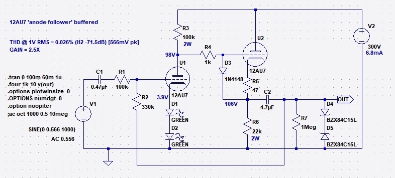

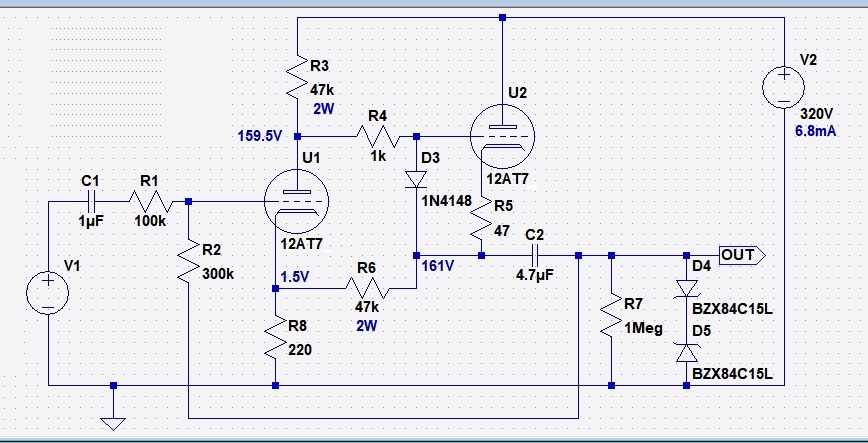

This little line stage circuit looks like it should be OK. 2.5X gain, 0.025% THD at 1V rms output into 50k ohm load (THD looks like it nulls into a 10k load, but I don't trust that in simulation).
Granted, this is a mere simulation, but the real life circuit would be quite close, and it looks like it would be a pretty good line stage preamp thing.
It could be made better using ECC81, ECC88, ECC40, ECC99, etc. But if all you have is a sleeve of ECC82...
C1 could be removed if you're sure there's no subsonic garbage coming in and the power supply has very low impedance.
D4 and D5 could be removed if there are no solid state devices downstream.
D1 and D2 could be red instead of green.

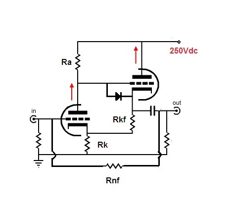

In this regard, as described on Tubelab, it occurred to me to try a ccda with this configuration, where the role of the small positive feedback to the CF is praised. In addition I would like to try at the same time to add a GNF (about 200k) to further stabilize everything. The simulation so far looks promising ...

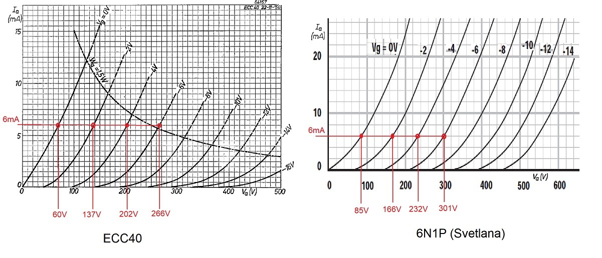

Curves do look similar.Soviet 6N1P is electrically identical to ECC40 ( filament current , miu , gm ) as far the datasheet tells ... maybe somebody will test distortion .
Operating points somewhat similar, although not identical.

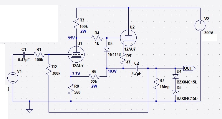

Rongon, in the time I was writing the post I saw your circuit which somehow preceded my intentions...
The CCDA ceases to have equal-but-opposite current draw if the load changes much. In practice, that's probably not a problem driving the input of a power amp. But if the volume control comes after this line stage, then that would be a problem. Solution is to put the volume control before the line stage.
The positive feedback to the cathode of V1 basically does the same thing as the LED cathode load for V1 in the circuit I posted previously. The results are almost identical. The amount of NFB is about the same. The resulting gain is about the same. The THD turns out to be slightly improved.
It looks like a worthwhile improvement.
Thanks for your contribution, on the first inverting stage wouldn't be more appropriate a higher Ia though (i.e. with Ra 30-40k and Rk ~300Ω)? A steeper slope is usually preferable in the graph as far as I know...
Oh, sorry... I didn't fully understand your comments.
Yes, you could increase the Ip of the first 12AU7 (U1) and make the circuit a CCDA. The thing is, I don't know if that improves anything. You want as much gain as possible from that first stage, to provide negative feedback. I was going for as much voltage gain as possible from U1 since the U2 cathode follower presents such a light load to U1. You could rearrange things to make Ip of U1 = Ip of U2.
Also, 12AU7 is weird in that it's more linear at low Ip (like 2mA) than it is with higher Ip (like 5mA or more).
The idea of a CCDA is that the balanced current draw from U1 and U2 make the circuit's current draw appear more constant to the power supply. A higher impedance from the power supply becomes less of a drawback. If you have a good regulated psu with low output impedance, then this may become a moot point. Or maybe the CCDA 'sounds better' because it makes the regulator work less hard? I really don't know.

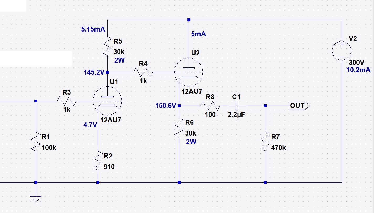

To make the 12AU7 CCDA with the positive feedback to V1 cathode and NFB from output to V1 grid, you have to arrange for V1 and V2 to draw the same plate current (Ip).
1. Choose the plate resistor value for V1.
2. The cathode resistor for V2 will be the same value.
3. You will need the Vp (plate voltage) of V1 to be 1/2 of B+ voltage. If B+ = 300V then Vp for V1 will be 150V.
4. Now you can figure out the Ip of V1 and the value of Rp for V1.
Let's say you decide on 30k ohms for Rp. That 30k ohms will need to drop 150V.
Ip = Vp/Rp
Ip = 150V/30,000R = 0.005 (5mA)
Now you need to look at the 12AU7 plate curves to see what the grid bias will be for Vp = 150V and Ip = 5mA. That looks like about -4.6V to me.
4.6V/0.005A = 920R
I think 910R is the closest standard value.
Let's not worry about the positive feedback yet. Let's put together our prospective circuit in its most simple and basic form. Plugging the circuit values into LTspice, I came out with this (using Adrian Immler's model of a PhilipsECG 12AU7):

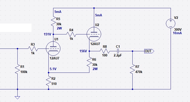

Yes, the method works. Voltages and currents came out very close to predictions.

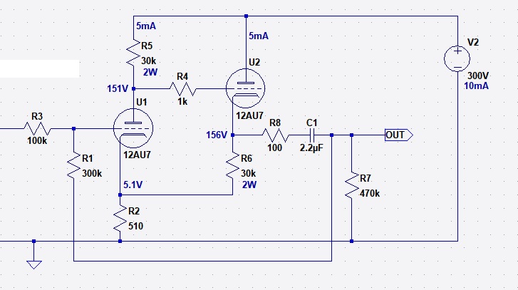

Now we add the positive feedback. The bottom of R6 gets disconnected from ground and then connected to the cathode of V1.
The combined plate currents of both V1 and V2 (about 10mA) will now be flowing through R2. The value of R2 will need to be reduced enough for V1 to see 4.7V at its cathode. Since V1 and V2 will be drawing 10mA, the math is easy.
4.7V/0,01A = 470R
R2 needs to be changed to 470 ohms. In simulation it came out close, but actually 510R got the two triodes to equalize at 5mA Ip each. It's hard to get the two triodes to draw exactly the same current, so I think it's not useful to split hairs. Either 470R or 510R will work.
With positive feedback in place, the gain goes up, but so does THD. So we want to add negative feedback to reduce gain and lower THD. For that, we can use an 'anode follower' circuit, but with the cathode follower acting as a buffer (which is a good thing). That's plate to grid 'shunt' or 'parallel' NFB.
Let's say our target is a gain of about 2.5X. We'll make the values of the two feedback resistors define a 3:1 ratio. That would define 3X gain if the open loop gain was infinite, but it's not even close. The losses should put us close to 2.5X gain closed loop. I'll pick a voltage divider made of a 300k feedback resistor and 100k series resistor. Like this:
The feedback is now defined by a virtual ground at the input grid of V1, made from R3 in series and R1 in parallel. R1 is the feedback resistor ('shunts' the amplified and inverted signal from the output back to the input), and R3 is the series resistor forming the voltage divider that defines how much output signal is fed back to the input.
The DC conditions don't change at all. Gain is reduced from about 15X down to 2.256X. That's about 16dB of NFB.
Now that we know the gain is 2.256X, we can figure out what input signal voltage will be required to get 1V rms (1.414V peak) at the output of our little amplifier.
1.414V/2.256 = 0.627V (627mV peak)
I put a 627mV 1kHz sine wave signal to the input of the simulated circuit, and it says the output will be 1.4135V peak. Close enough.
It also says the THD at 1kHz will be 0.0264%, which is quite decent. It's all 2nd harmonic, of course.
The frequency response looks like it will be flat down to DC and -3dB down at 365kHz. That's in simulation, of course. It's likely to be not that good in real life. But it should be close and more than good enough.
It's a feedback amplifier, so now you have to be careful of stability. You don't want it to ring or oscillate. However, there are no reactive elements inside the negative feedback loop except for the output coupling cap C1. LTspice predicts no nasty ringing or oscillations, because the open loop gain isn't that high (a 12AU7 only has mu of 15 to 20).
You could make C1 larger in value, perhaps 4.7uF, and that should increase LF stability a little. Or, you could install an input blocking cap of a large enough value to allow low audio frequencies through but filter out subsonic noise. Maybe 1uF would do well (it forms a high pass filter with R3). That would make LF stability very solid.
Ip = Vp/Rp
4.6V/0.005A = 920R
4.7V/0,01A = 470R
There's always more to a circuit than meets the eye. Feedback complicates things too. But in a simple circuit like this, you can see how everything goes together fairly easily.
