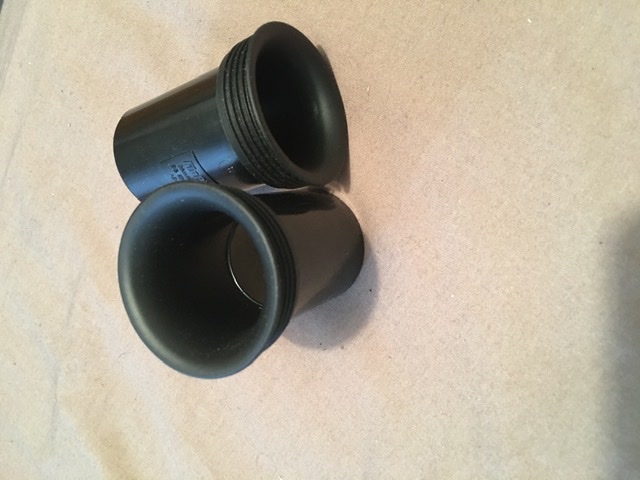

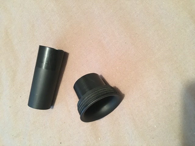

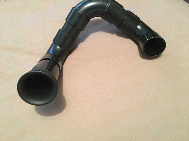

A Monacor BR-30HP and a 32mm waste pipe make really good combination for building a custom length bass port. I tried this before and it worked pretty well: https://twitter.com/killzone_kid/status/1360940606961422340?s=21
For my next project I need 2 bass ports 50cm each. Took me 2 min to mock up the port, which is roughly the required length and looks good. Pipes and fittings are Floplast from Screwfix (see attached images) if anyone interested
