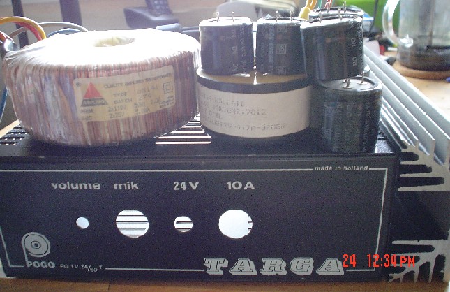

I have seen that kind of heatsinks before, thermal R is rather low.
I can imagine that it runs very hot.
An amplifier like this one deserves something bigger, i am thinking in the order of 0,50
At 10watts/8 in class A with 25vac toroids it would come down to a little over 55 watts dissipation.
That would keep a 0.50 heatsink at reasonable temperature with enough reserve for the added heat from the floating bias.
