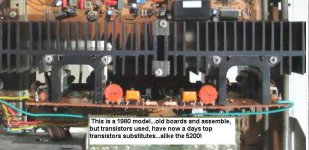

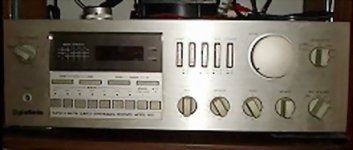

Made in the eighties by Gradiente, started with hi speed transistors.
The first one to use those "hi speed" devices here.
Now a days it is already searched by native audiophiles.
Produce a warm (a little mufled) sound, with good dinamics and temperature good to keep you coffee hot....just put is over the amplifier...do not forget the dish to protect from coffee leakage to circuit.
You cannot find to sell....the ones that have do not intend to sell..... when you find, people is asking more than 500 dollares.

The output transistor is a 150W dissipation unit
And it is alike the 5200 famous transistor....160 Volts maximum and 16 amperes maximum current.
To be safe, using 8 ohms loads, better to use the output voltage with plus and minus 35 volts and 40 volts plus and 40 volts minus to power input stages.
