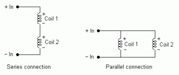

My last question to bug you with that i just thought about...
As quoted by your picture...
it shows that the same place i plug in the actual plug from the plate amp, i need to (solder) connect with wire to the other connection.
But if the plug is plugged into it... how am i supposed to solder the wire on the same connection thing?
Or would i use the other connector on that side? for instance like this?
Confused because your picture shows 2 connections on each side when the speaker has 4...
It would leave one connection ("lead"?) open, so im not sure if thats ok... and im guessing that either sides of those things are gonna have a + and - to show what side is which.

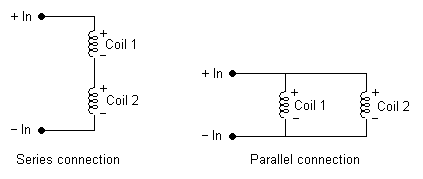

Electrically my wiring diagram and yours are exactly the same - good job !
Just make sure when you connect the wires to the driver what you have make sure is that the two terminals marked + are connected together and that the two terminals marked - are connected together, that way you will have a parallel connection for the driver voice coils.
Also, if you want, you can just cut the quick connects off of the end of the speaker wiring coming from the Foster sub amp and then, rather than soldering, connect these to your sub wiring using regular electrical twist Marr connectors. That way, if you have to remove the amp or driver for any reason it leaves that option open,
