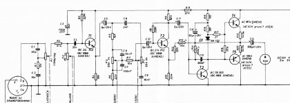

Hi. I want to build a low power germanium stereo amplifier and i got a little stuck...
So the story goes like this: A few years back was repairing a vintage radio and had it hooked up to one of my crappy speakers which had a decent bass for what it was and i was really surprised by the "warmth" and power of that tiny amp. I don't know if it was because all i used at the time were cheap class d board or because of the tapped volume control but I liked the sound and I didn't even know germanium transistor were a thing at the time... Then I started to look for a circuit using these transistors (ac187/188k) and I found an interesting amplifier which is riz transiwatt 8 and it uses these transistors. It doesn't have a tapped volume control but it has a tone control.
Here is a circuit:
https://www.google.com/url?sa=t&sou...Vaw1bdam7IFN2Tf_iu8zoPBSu&cshid=1607085821221
Now here are my questions:
1 what do r13 and r14 do. They seem to be trim pots and i don't know how to adjust them.
2 where am I supposed to find 13M ohms volume pot?

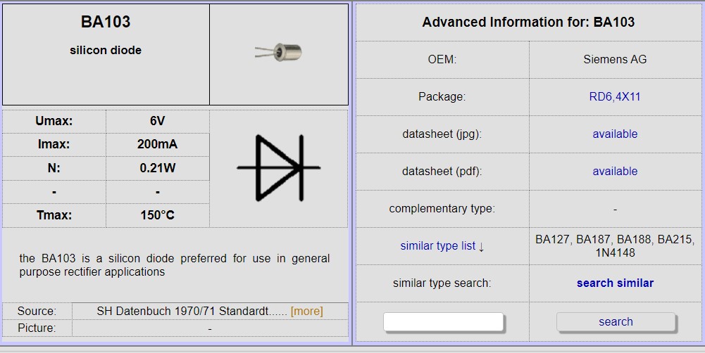

3 is there a substitute for ba103 diode because NOS part costs 20 dollars!!!
4 I see that under each transistor it says another transistor name. I think that is other compatible transistor. Now what do I do. I can get NOS parts or use bc108 ? (I already have NOS output transistors)
And finally is there some suggestions about the pcb layout?
Thanks in advance and sorry for the wall of text. Also if anyone has a better circuit for these transistors feel free to tell me.

1. These set the bias for the output stage. Ideally the positive leg of c14 should be 1/2 the supply voltage.
2. No idea but it likely has something to do with the filter on the input.
3. The datasheet says its a silicon diode so anything with a similar rating should work. The 6v rating leaves me scratching my head though.
4. Its really up to you if you want a bc108 or b115.

AC187/AC188 are well known to me in 60,s plastic small portable AM radios as output devices .
Old school biasing for Germanium BJT,s used both an upper and lower resistor attached to the base to bias them unlike the modern silicon versions .
The "B" in BA denotes its silicon as opposed to "A" which is ( early ) point contact ) later silicon junction.
As its a standard diode of its time why don't you check out old 60,s transistor radios usually in a lot of them.
If you want to keep it Germanium then don't install the silicon BC range apart from the fact it might not function correctly even though the spec ,is near it ,the circuit compensated (usually ) for the leakage in them.

I suspect the volume control would be 1Meg rather than 13Meg and even 1Meg is high and yet consistent with using a crystal cartridge whcih would be common at the time.
For modern sources you can use a 10 or 22k and reduce the balance pot and the 51k by the same sort of ratio.
Why not initially build it with all silicon which apart from the output stage it is anyway.
The BA103 comes up as silicon... could it be? The package suggests it could be mounted for thermal compensation. If it is silicon then a 1N4148 should work. It should be in thermal contact with the output stage though.
I suppose it could be Si given the 0.47 ohm emitter resistors.

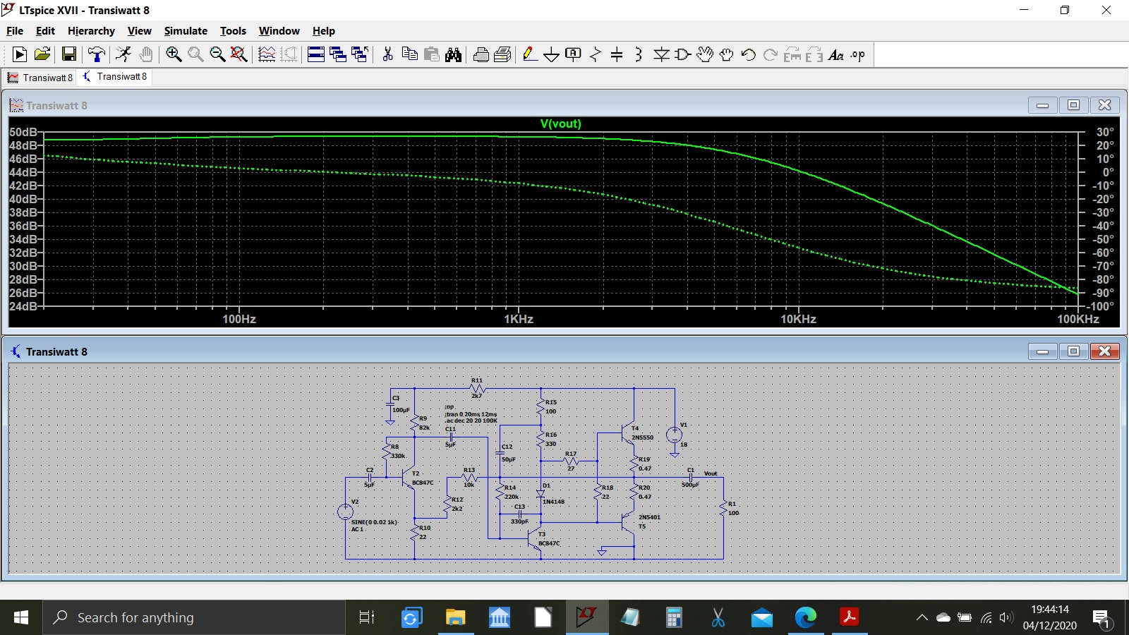

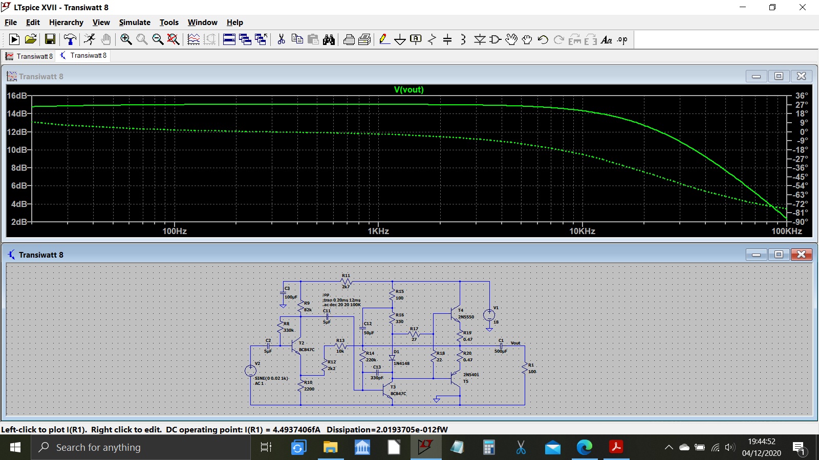

I've just done a quick simulation but am a bit unsure of the results. The gain is extremely high, the response poor and drive ability is best not mentioned.
I suspect R10 is incorrect and should perhaps be 2k2.
This is as drawn. Nearly 50db gain and response rolling off from a couple of kHz.
Now with 2k2.
.asc file attached for anyone wanting a play.

Amplifier for gramophone. Sensitivity 150 mV (25мв). Squeezed out of 5 transistors everything they could. 1970 former Yugoslavia (Zagreb). DIN 4w (THD 1/10%)
Perhaps 🙂

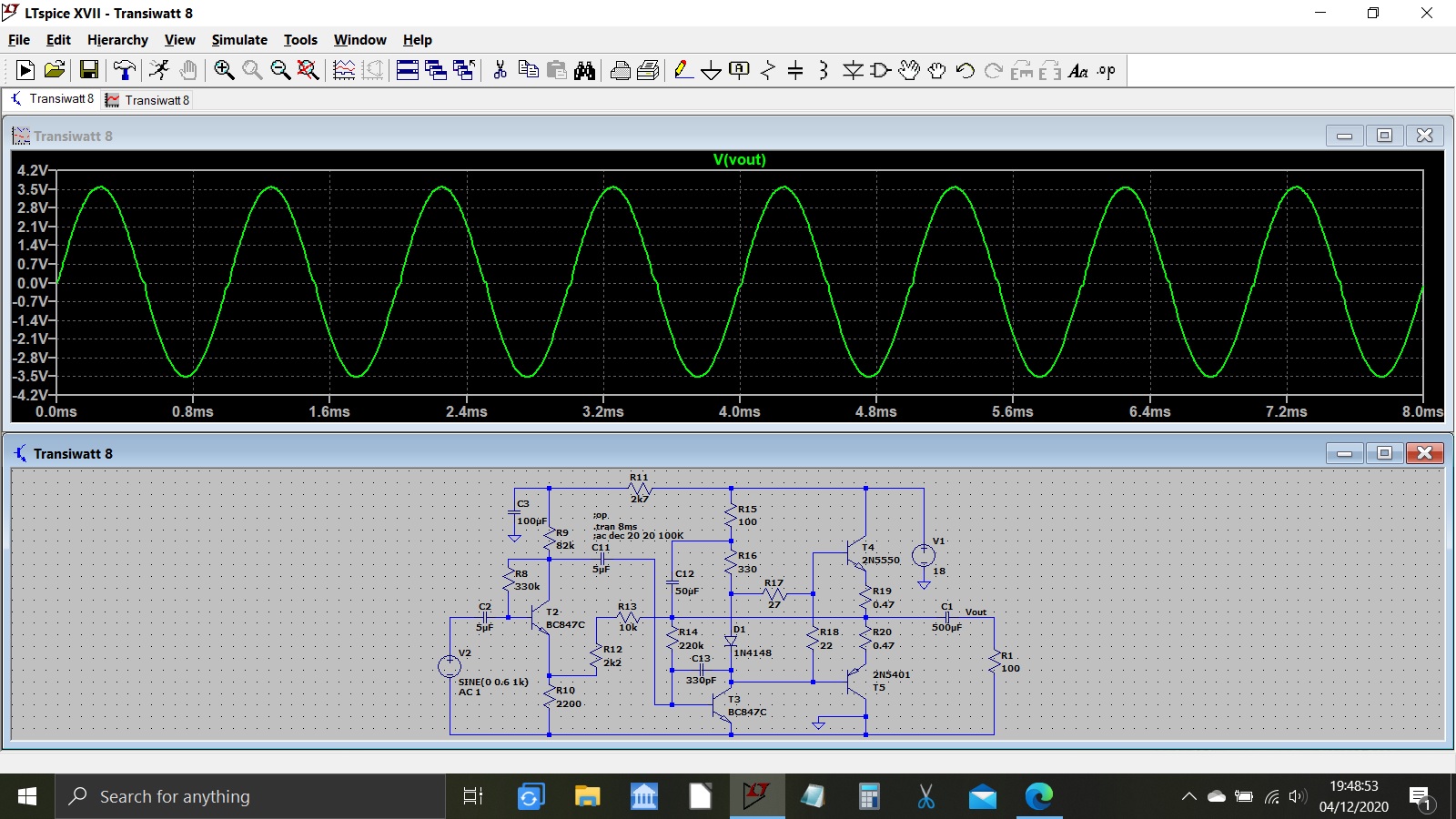

With 22 ohm in place full output is reached for just 14mv rms input. I never dabbled much with ceramic cartridges but seem to recall they put out a few hundred millivolts or so. It just seemed a bit to high gain. No getting away from that lack of HF though.

Oh i didn't even know that amp circuit simulator existed lol. Thanks. So there are some mistakes in the circuit diagram... Good to know.

Increase the NFB resistor R10 220om. Sensitivity will decrease (and distortion). The tone control can be assembled on 1 transistor in feedback (like Dual CV20). Bias R17,18.
There are some mistakes. The BC214 is a PNP and should probably have been BC184- that was the NPN complement, but BC108 is fine.
The AC187/188 pair are good ones to use for a Ge output stage. I would, however, use a germanium transistor for the bias stabiliser in the same way that silicon transistors are done. It would mean getting hold of a second AC187 (NPN) which would (should) give better thermal stability than a silicon diode, because you need two Vbe compensation while a Si diode would only give one.
A rather better arrangement might be to use a PNP input transistor (BC558) and a BC547 driver in the classic 4-transistor arrangement. Make it 5 with a bias stabiliser. I guess transistors weren't used back then as they were pretty expensive.
I would not recommend a silicon output stage like TIP31/32 for lowish power output. The AC187/188 had a minimum gain of 50 (80 for the PNP) at 1A. If you want to use silicon, and I don't believe you do, I would recommend at Zetex (now Diodes) type which also have high gain at 1A or so (like ZTX650- ZTX750) These can do 2W with a heatsink, about the same as the AC187/188 with a heatsink.
You can use a JFET or a buffer circuit to give a high impedance input which will be able to drive a lower resistance to your circuit as Mooly suggested.

Typically missing decimal diots/separators so 8 2k actually means 8.2k (notice space between schematic printed 8 and 2 digits) and so on.
Same with "1 3M" volume pot, not the same as "13M", where I guess it "must" have said "1.3M" but dot was missed.
In all, a decently made amp for the era, but for some reason germanium was being phased out and that´s lack of performance compared to silicon 🙄
