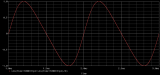

I did some FFT on FMs, see attached results. The red one looks perfectly like a tanh() distortion from a diffamp, (funny that it can be represented by a simple FM), the green one represents a dynamic phasehift caused by asymetric slewrate. It's very obvious that this kind of distortion is ABSOLUTELY EVIL, it creates sub harmonics. High gain ccs'd vas tend to do that. A balanced push/pull vas not. Also, this distortion will be rising with frequency.
But, these are all defects not beeing in any relation to nfb. It's true that a constant phasehift between freqs will not show up in FFT (harmonics), but only if they are constant. The moment these phasehifts are varying you get FM, causing harmonics. NFB will mostly compensate those phasehifts as they create an error voltage. (Okay, partial compensation of dynamic phasehifts might be a problem)

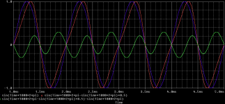

I attached the first case, FM distortion by dynamic phaseshift, Blue = original signal, Red = FM-distorted signal by level dependent phaseshift, Green = error voltage as seen by the feedback.

Yes, such behaviour is frightening... Are we talking of dynamic phaseshifts, immediately applied by the current level of outputvoltage (which occurs through the nature of bjt, changing capacitance with Vce) means FM distortion, or a permanent phaseshift dependent on the amplitude of the signal, means no distorted signal ? The 2nd gets difficult to imagine where to come from, maybe local heatup ?
Whatever, ANY phasehift will create an errorvoltage visible to the feedback and will be reduced.
One bigger problem that occurs with nfb is the reactive input of the bjt on the -input of the diffamp, this will create new phasehifts. In worst case it will create dynamic phaseshifts out of control of nfb. Thats where CFB is superior...
Another problem: A phaseshift of only 10° already creates an error voltage with up to 17.5%, driving the nfb quite busy. Gladly, in this case nfb does not add distortions yet. But, with a dynamic phasehift it does, as the FM distortion is a distortion. But these fall under open loop distortion and will be immediately visible with fft.
