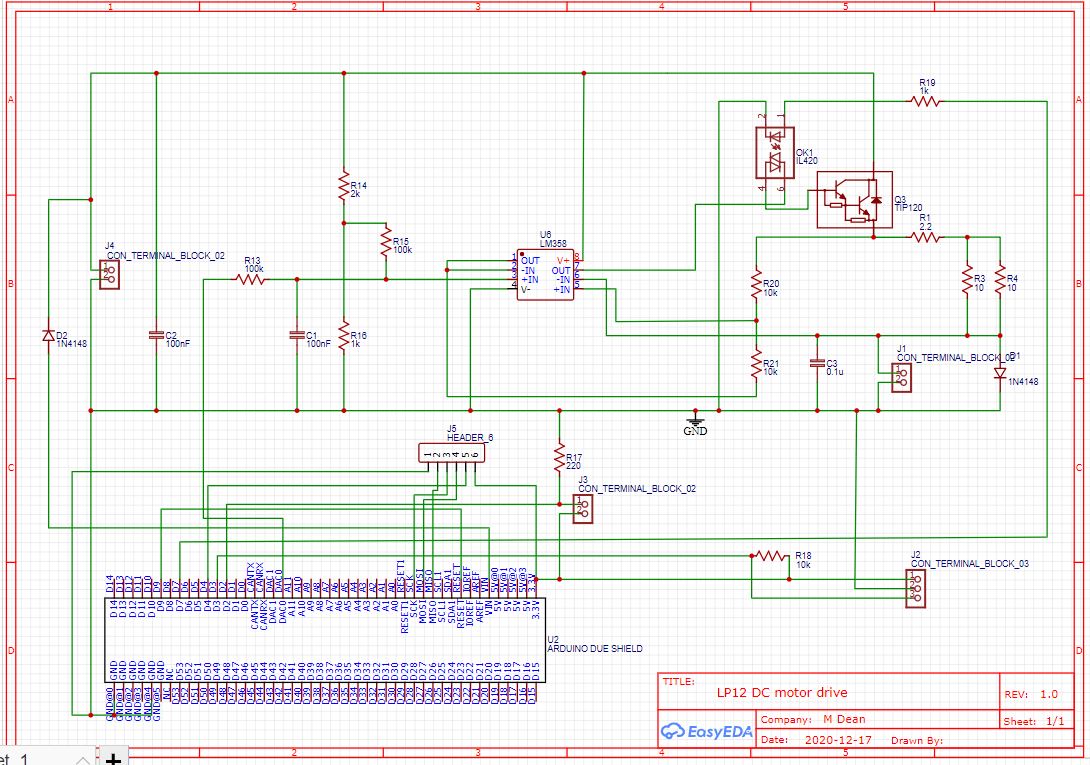

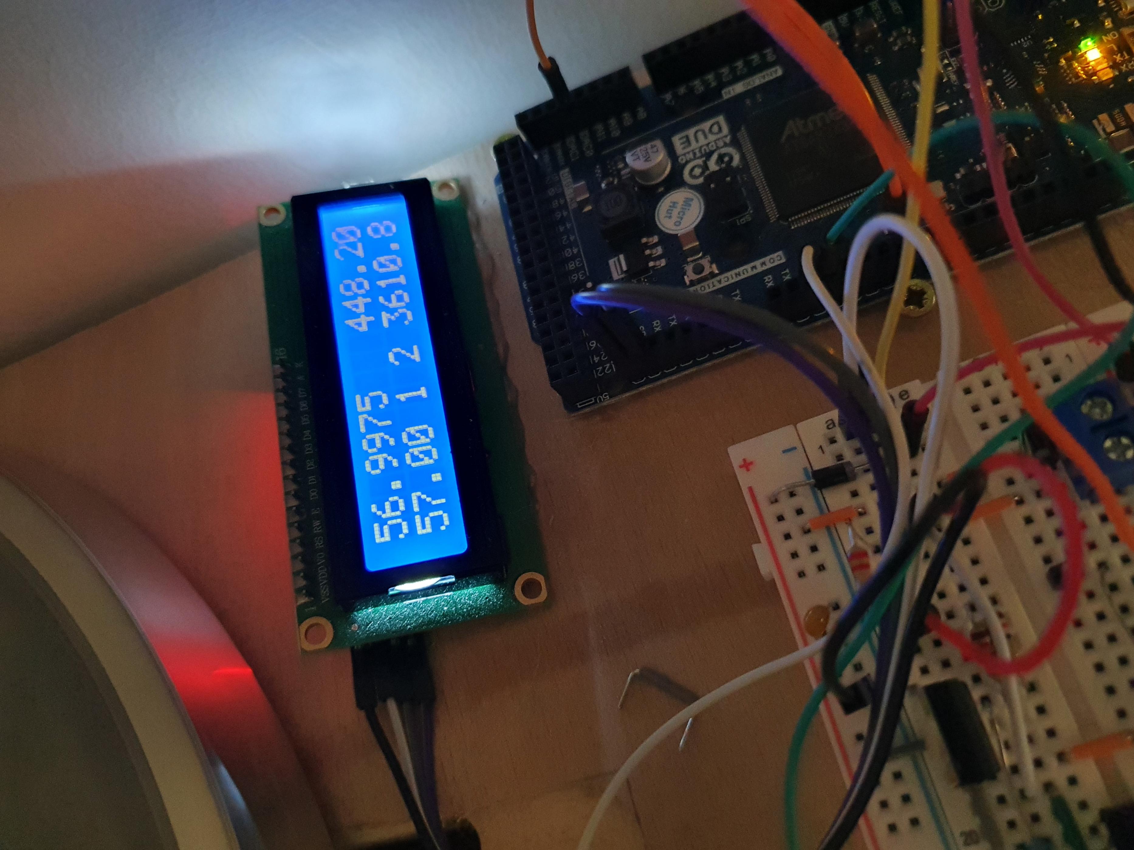

I have made some progress with my dc motor drive. I made a test rig to develop a drive circuit and the Arduino program. Its controlling speed really well, very close to target speed. I made a pulley for the motor myself on my lathe. Its 17mm diameter, which was an arbitrary choice to get it running, but seems about right. The motor needs around 2.4 and 3.3 volts to run at 33.3/45rpm with this pulley on the Linn. The test rig I have put together uses a SR222 platter which I picked up cheap on ebay. Its a different diameter so target speeds on the rig are set to 42 and 57 rpm to give an equivalent motor rpm. Once working and optimised it will be an easy job to swap it over and fine tune it for the Linn. The drive circuit uses two op amp stages and a transistor. Its simple but seems to be working well. Im not great with electronics so I'm pleased to have got this far. The first op amp stage has a voltage adder to get more range out of the Arduino DAC output. This has a 12-bit range, so a value of 0 to 4096, and 0.55 to 2.7 volts. The circuit I have converts this to around 2.2 to 3.5 volts so for 33.3/45 rpm the DAC is operating between ~400 and ~3600 which should give a resolution of 0.004 rpm. This is what I am seeing in the measured speed - its usually holding the speed within 0.002 rpm of target. Im measuring speed with a hall sensor with a single magnet, using the micros() function in the Arduino to get good resolution on the measurement. For speed control I let the platter turn 5 revolutions before making adjustments. It takes ~4 revs to get up to near nominal speed. Its usually within 0.01rpm of target speed at rev 6, and 0.002 after 30 seconds. Good enough?
The second op amp adds torque feedback so the drive voltage to the motor increases when load is added. This seems to work well. I need to add a tonearm to measure how much speed will change when the stylus is dropped onto the record. There is a bit of optimisation to do on this yet.

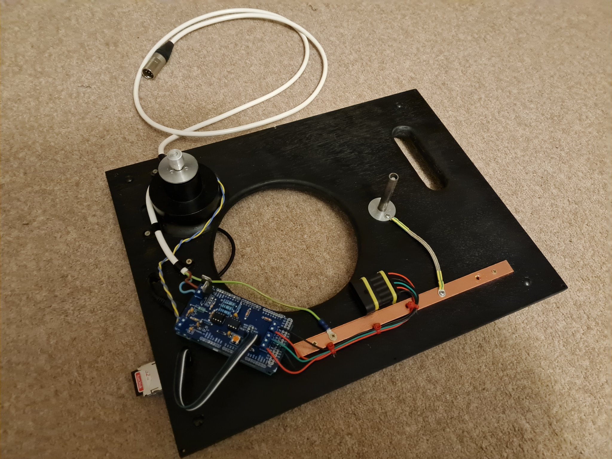

Next step is to add a memory card into the Arduino and get it recording hours run. Im going to mount a memory card somewhere onto the LP12 so I can periodically check hours run to manage life on the cart.
The graph below shows a trace of the speed showing how well its working. With no feedback the motor speed gradually increases with time, assume as it warms up.

I have been asked to post the Arduino code so that's in the attachment. Its about finished, as optimised as I can get it. I have put about 50 hours running on the motor and have tried various control options. The latest has speed adjustment starting after rev 4 and continues every revolution for next 20 with a diminishing magnitude. Thereafter it records average speed and makes a minor adjustment every 5 revs. Once its running steady state its stable and holds average speed well, within 0.002rpm of target. Motor speed drifts more during start up hence the adjustment every rev during that phase. Instantaneous speed does drift around a bit - in range 33.329 to 33.337 rpm. Is that good/bad/ok - keen to get a view on it? The circuit diagram is shown below. Im now making parts - motor housing, new pulley, pcb - will post more details soon.

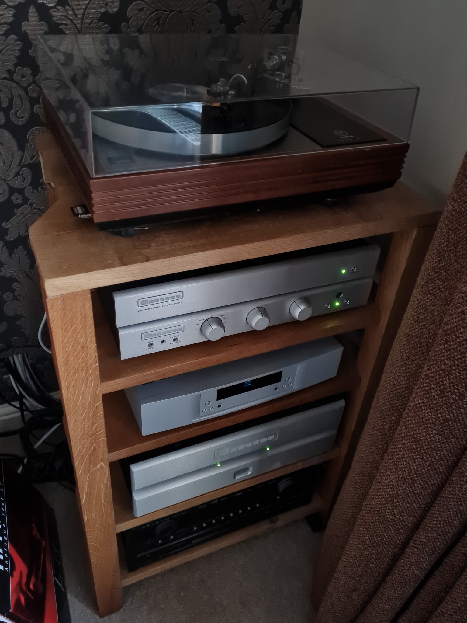

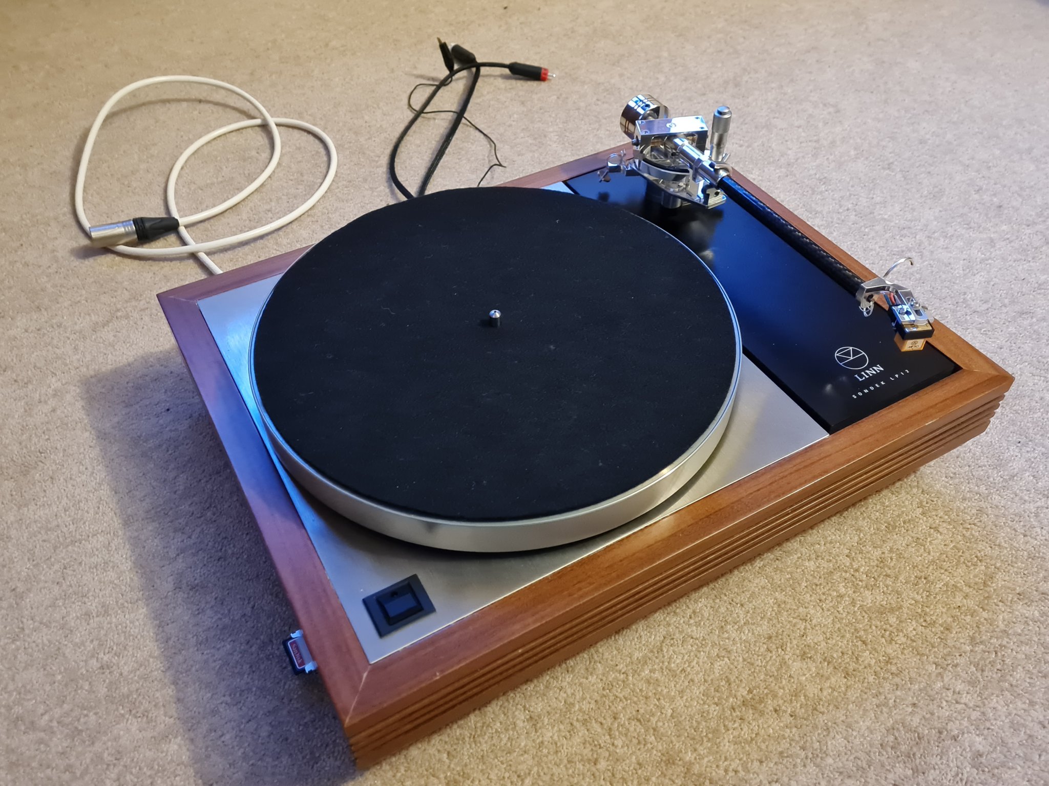

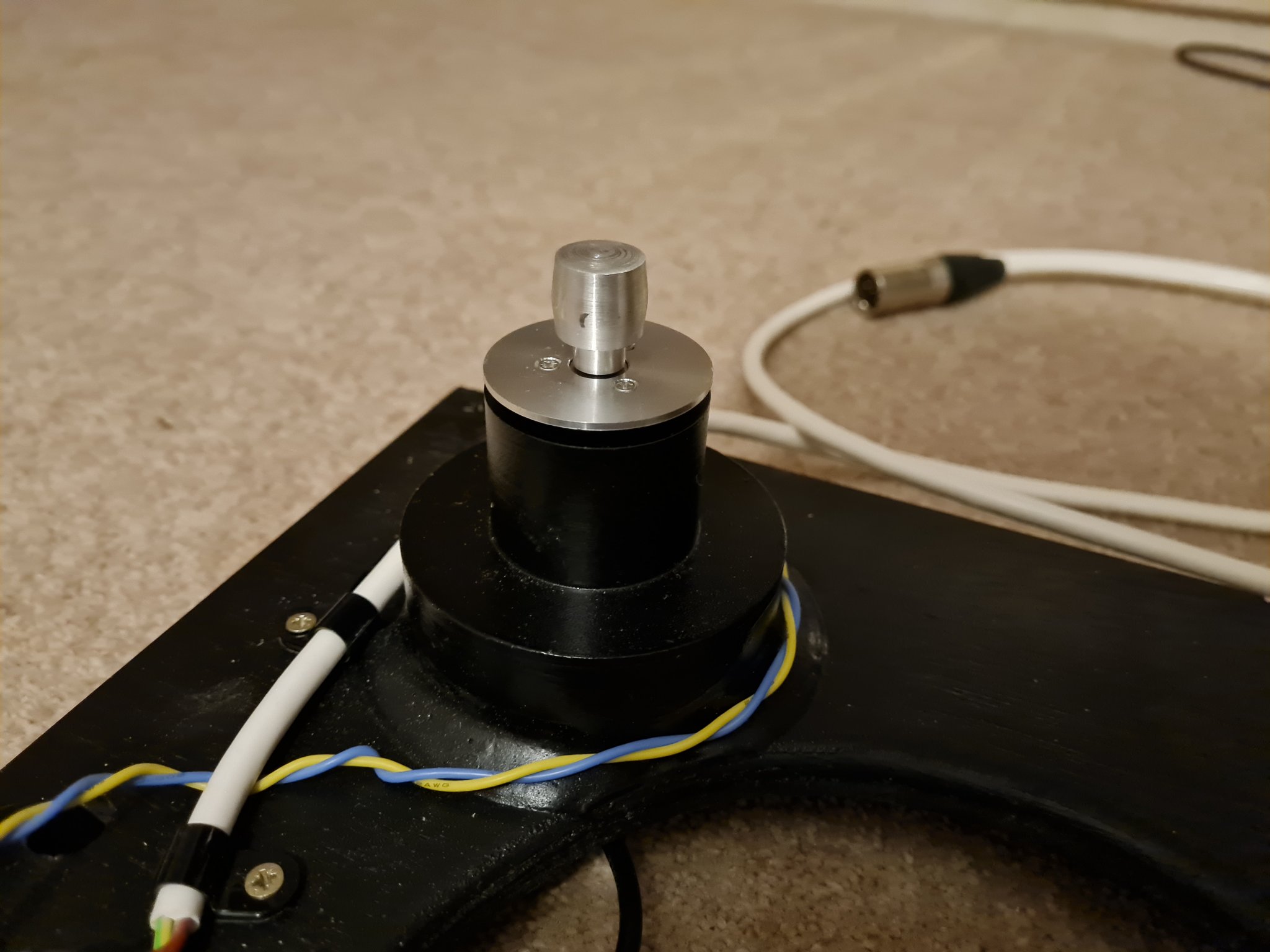

I have just about finished this project now. The turntable is assembled, working and sounding great. Its been a while since the last post but there were a few setbacks and the job was dropped in favour of a house extension project. Setbacks included 3 failed Arduino boards, one of which was self imposed. Im on my 3rd motor too which is more painful since they are over £200 each. I damaged one motor fitting a pulley and then switched to a slighly different motor version. MAXON make a long and short version of the DCX motor. The short version is what I now have which is best IMO since it is easier to integrate and datasheet shows it to be quieter. Im on iteration 3 of the PCB, which is a shield fitted on top of the DUE. Making pulleys has been a regular feature. I must have made 30 different pulleys with differnet diameters, shapes and materials. The final version is dia 16mm in aluminium with a slight barrelled shape. Making the pulley perfectly concentric has been challenging but I now have that perfected.
The mods are built into a 3/4" plywood baseplate that houses the motor and electronics. Power comes from dc out from my preamp so there are no external boxes, which was one of the aims I had. The motor is fitted into a 1kg steel housing in strips of sorbothane. There is a steel post also supporting the free edge of the top plate, and a corresponding hole through the subchassis. The top plate also has a stiffening ring of 2mm stainless added. I made the subchassis by laminating pieces of birch ply and there is a steel housing screwed and glued in the centre with the linn bearing glued and screwed into that.
The motor is quiet with no noticeable vibration. Speed stability is usually within 0.02% once running and stable. Now its built into a functioning turntable I have measured the speed while lowering the tonearm and was surprised to see a momentary dip close to 1% which recovers back after a few revs.

I damaged one motor fitting a pulley and then switched to a slightly different motor version.

I think the speed dip from stylus drag is not the fault of the motor. The circuit shown at #23 has passive speed control and you can tweak the balance resistor (see r1,3,4) value to make it compensate for load better. The next circuit I make will include fine adjustment there so the speed drop could be dialled out. The stability of the motor speed under load is all about the circuit, not the motor. If you drive the motor with a straight dc supply it’s pretty hopeless at spinning the platter up quickly and dealing with variation in load. The best approach is to use an effective passive constant speed circuit with closed loop active speed control on top.

This kind of compensation works fine under static conditions. Once you have the belt compliance with the attached inertia of the platter things get more complicated. Any disturbance in the drag initiates a response. Perhaps not a serious issue with the Linn, but with a much heavier platter and a longer belt some integration becomes essential.
Always thought the main reason for A-max motors dying early was the lateral load from the belt, which is greatly improved in the DCX. Slow speed is also a problem? Something to do with lubrication?

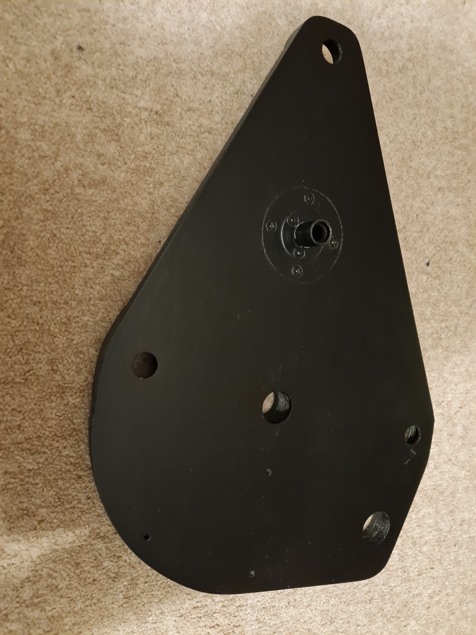

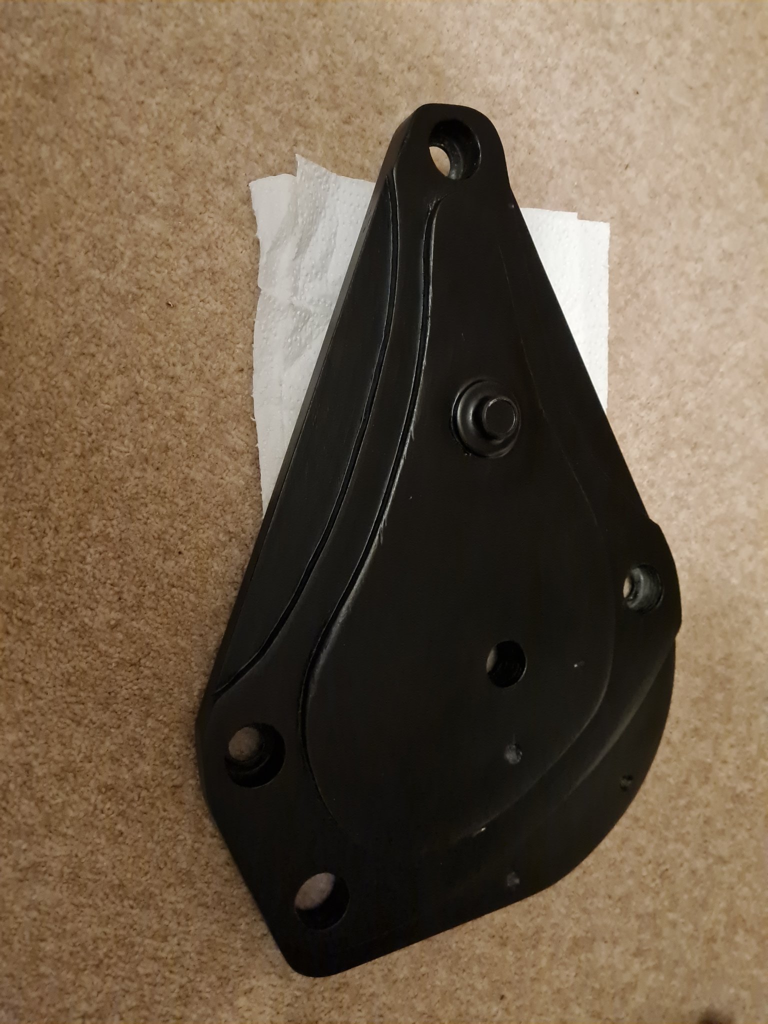

I created a CAD model as close as i could scaling from photographs. I found a website where someone published a measured weight figure so this was key to guide the geometry. My CAD model is 22mm thick overall, 10mm for armboard and 12mm for the main section. Where the aluminium is machined out its 3mm thick. The CAD model massis 1.13kg. I think all LP12 subchassis are around 1.1kg mass. Any higher the springs bottom out, so 1.1 is the limit. I have attached a .stp file.Deano,

I took the Sheet Metal Sub-Chases dimensions on a CMM and wanted to make a drawing with the photos as you did. But you saved all of that. I will see how to go forward with manufacturing.
Kindly suggest if you have any information on which aluminium alloy is better. Does something like 6061-T6 or 2014-T6 works?
