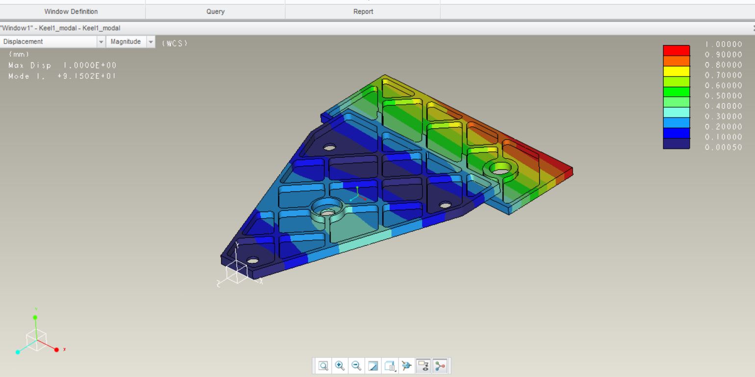

The next round of upgrades have been in design for around 6-months. I stripped and measured the turntable an re-created it in CAD (Creo). I have used this to design new parts and assess them using Creo Simulate FEA. When I looked at the standard LP12 design I was surprised how basic it is and there are several poor features and a lack of stiffness in the structure and sub-chassis. Upgrades from Linn are so very expensive and just fix their own crap design features! My plan has been to match or improve some of those upgrades for a fraction of the cost.
I will put a few more posts on to show details. There are 4 main upgrades; new tonearm, subchassis, fix top plate resonance, and add a decent DC motor with closed loop voltage control. I'm hoping these will give good performance and get me rocking with the old vinyl collection. 🙂

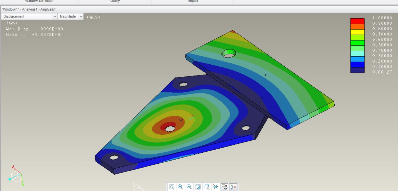

Picture below shows one of the problem areas that I have been looking at and assessing loads of design options - subchassis. The standard pressed steel subchassis looks poor and the analysis confirms this. It weighs around 1.1kgs and there is a further 3.7kgs of weight on it from the platter and tonearm. This weight makes is resonate at a low frequency. There is a first order resonance of just 52Hz. This cant be very good for bass performance!

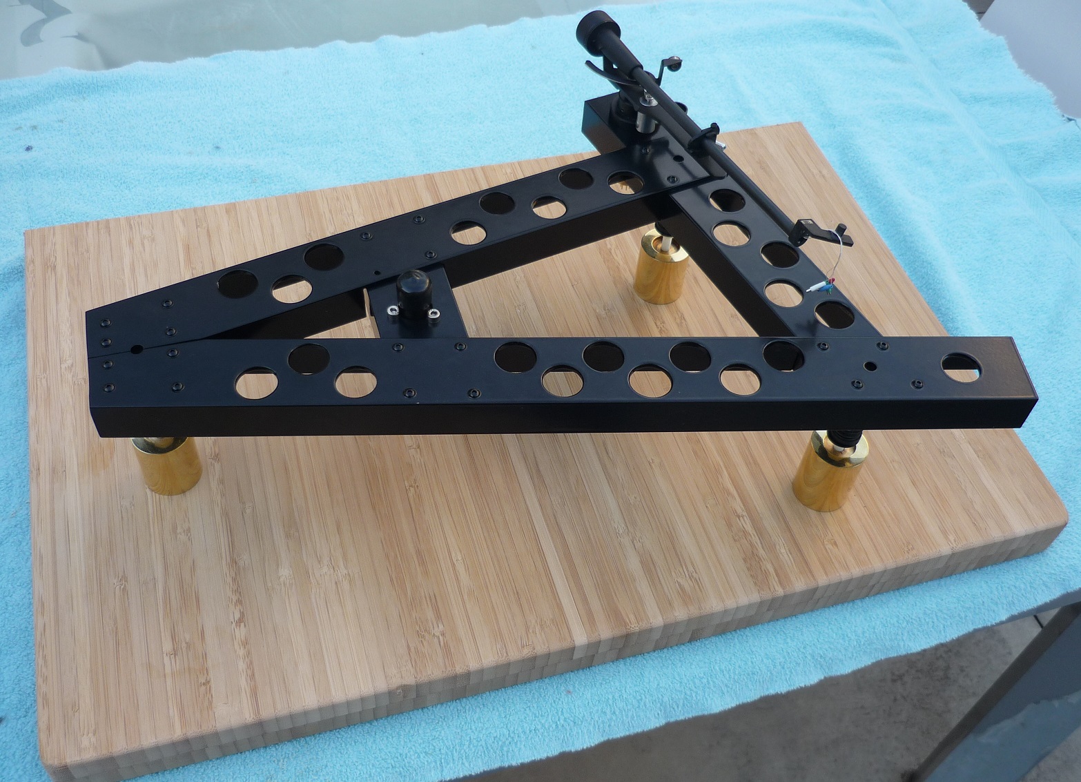

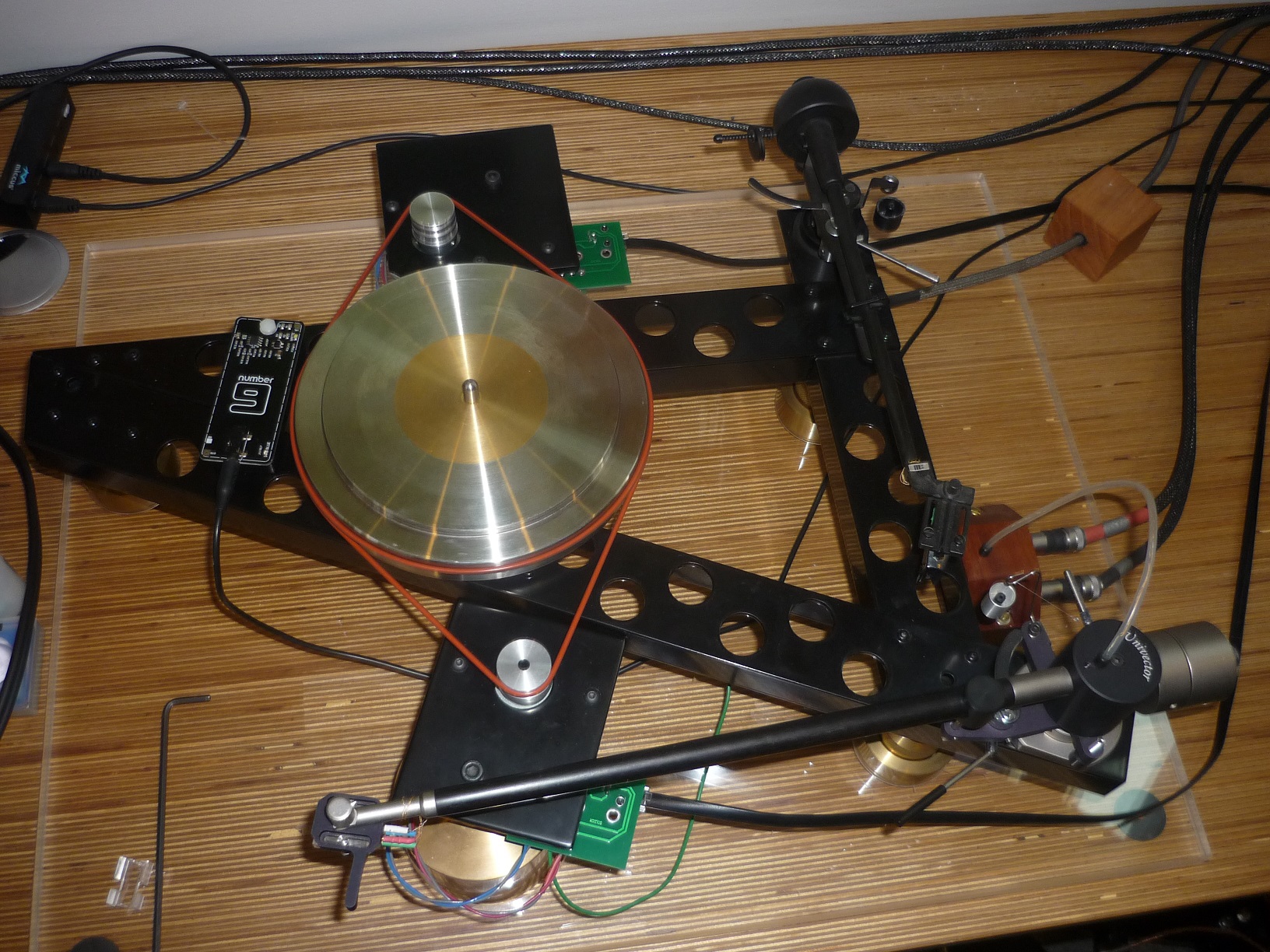

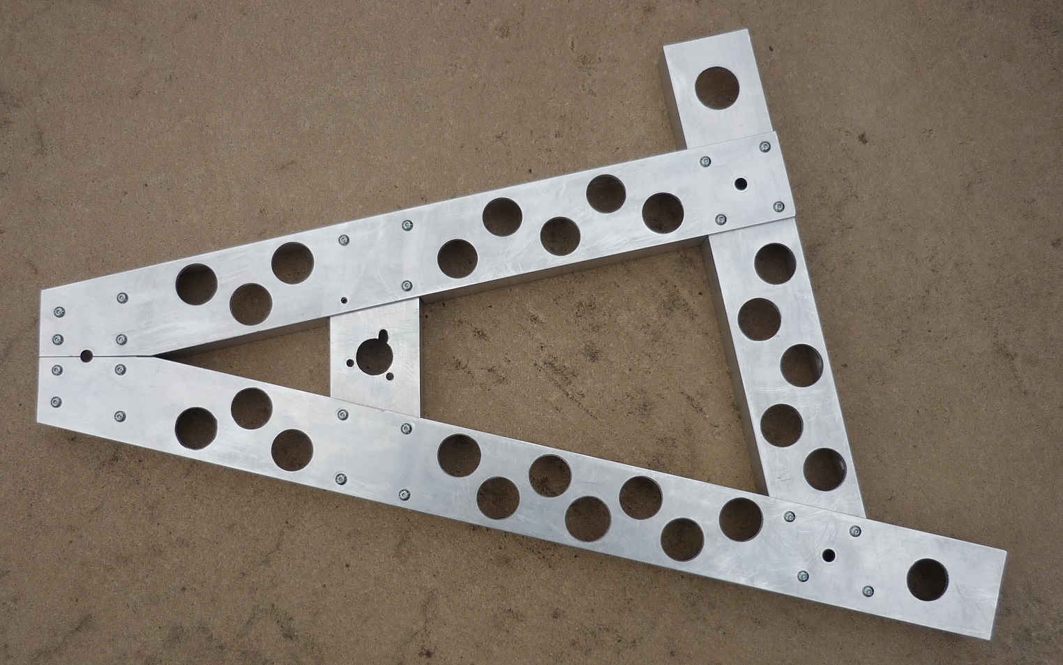

Can I suggest a less expensive and better upgrade path for your "fairly basic spec " LP12 is to use some of its parts to turn it into a 'SkeletaLinn' - as I have done. 🙂
A couple of pics are attached; if this is of interest, by all means PM me.
Several advantageous features of the 'SkeletaLinn' are:
1. the arms are rigidly attached to the bearing/platter - providing the level of detail retrieval given by the Keel.
2. the motors are off-board (no vibration problems).
3. the motor controller I have ('Number9') is able to drive 2 motors - diametrically opposed - and apply a phase difference between their power cycles (so they don't both 'drive' at the same time). Using 2 motors:
* provides double the torque of just one motor - which you can hear delivers improved SQ, and
* removes the LP12 problem of the belt pulling the bearing to one side.
The pics are of v2 of the chassis (which is slightly different to v1); v3 is in the process of being CNC'd - this will be a chassis milled from a slab of Delrin ... rather than using aluminium C-section bolted together.
Andy

Wow that's radical! Love it. Some out of the box thinking has gone into your version.

Thank you, Dean.
There is a problem that I think you can't get away from, using Linn geometry (to fit in with a standard top-plate & plinth) - this is ... that there is not equal weight distribution across the 3 springs. (The 'arm spring' is always wound up tighter than the others.)
My v2 was more even than v1 - but v3 (currently under construction) should have almost equal weight distribution across the 3 springs. 🙂 (It's a matter of moving the bearing (/platter) around, relative to the arm positions; I developed a weight model in Excel and the magic of the CAD program delivered the weight - and the CoG - of the chassis itself.)
Andy

In v1 of my SkeletaLinn chassis, I had the bearing point too close to the LH spring - so I needed to have made up some springs that were about 30% stiffer than the standard Linn springs. So v1 has this stiffer spring on the LH side.
v2 - my current TT - reduced the weight on the LH spring by moving it 50mm away from the bearing, to the left ... so uses standard Linn springs. However (because I didn't get the weight distribution correct), the LH spring is still more compressed than the others.
v3 of the chassis - in construction - should have pretty much equal weight on all 3 springs ... so the extra compression which the LH spring experiences now, should be removed. But I will be moving to "mag-lev" springs, designed by the guy who developed the 'Number9' motor controller - which should improve the spring performance.
Andy

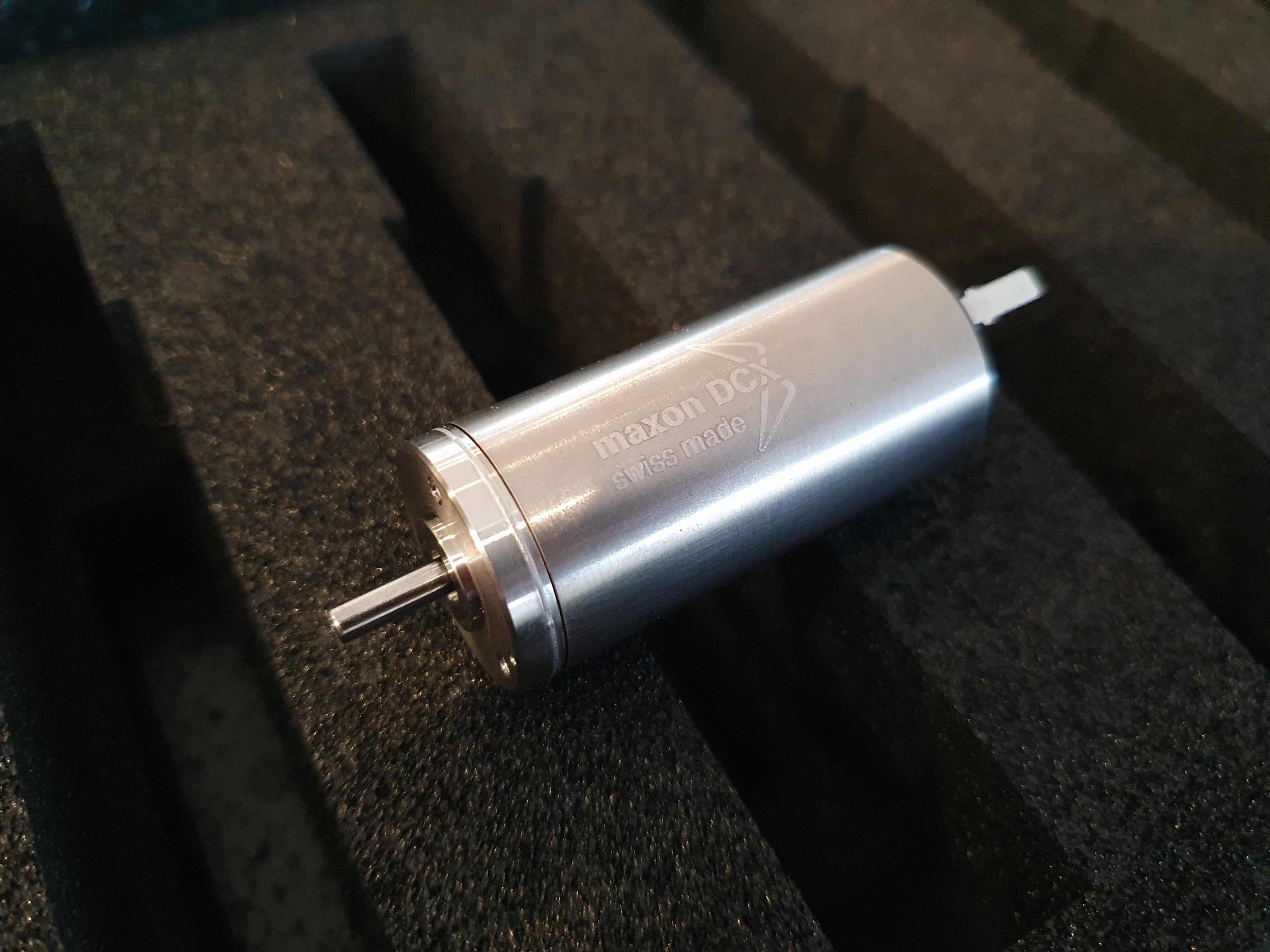

Got a delivery from Maxon today so that's good, a little earlier than they promised, and no VAT to pay thankfully. I went for a DCX 24v. I have made a test rig to get it working and optimise the drive circuit and software. Plan is to control it via an Arduino DUE. This has a pure dc output 12-bit signal @ 3.3v. I don't know yet what the motor is going to need as a nominal voltage for 45 and 33rpm. Probably over 3.3v. Im not great with electronics so if anyone can help with ideas for a drive circuit that would be good. I also need a pulley.

Which Maxon is that?
The motor? Its a DCX. 22mm 24 volt, precious metal bushes, sintered sleeve bearings
maxon - Online Shop | maxon group
Maxon website includes this article where they say its super quiet.
The perfect record player | maxon group

About your maxon-motor.
If you look at the specs of the motor there is a ratio U/min versus voltage. The rotational speed depends on the ratio of the diameter of your pulley and your platter. Now you can calculate either rotational speed of the motor or diameter of the pulley, next step is calculating the voltage you need.
The easy way is using a Linn-pulley and a linn-subplatter, the rotational speed of the premotec motor is 250 per minute, as far as I know.
Good luck with your project !
Regards, Klaus
The test rig I made has a single magnet on the platter with a hall sensor. Im using the Arduino to monitor the speed via interrupt and its adjusts the speed incrementing the volts out proportional to the speed error. I think the switch on the LP12 is momentary action so I have the program checking state of that via a second interrupt routine and it selects 33rpm on one button press, 45 for 2 and the 3rd button press switches it off. I have had this running with a cheap Chinese motor with an UNO outputting PWM and it seems to work ok. The UNO outputs PWM and only to 8-bit resolution. This is giving audible noise so I now have a DUE to try which has a true DC out via a DAC and can be set to 12-bit. I'm hoping this will get good enough speed resolution.
Not sure how your adjustments are made but hopefully not at every revolution. The original Teres design was a pretty good compromise between maintaining an accurate average speed and not being too intrusive. It used a very basic motor compared to what you gave.
So far I have used 3 revs between adjustments. I need to test the Maxon motor to see whats the best setup. I can give it a try after I have a suitable pulley. I think the LP12 pulley could be too big and hence motor speed too slow.

The motor will still be going very slowly circa 300 rpm. The motor spec says it rotates at 211rpm per volt. Driving it at 1 to 2 volts seems low? I want to try a pulley 10mm or less. Still don't see anything I can buy for this. I do have a lathe so may end up making a pulley myself will have to see how well that goes.

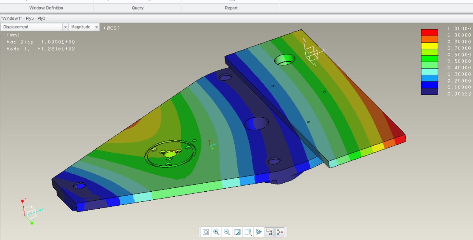

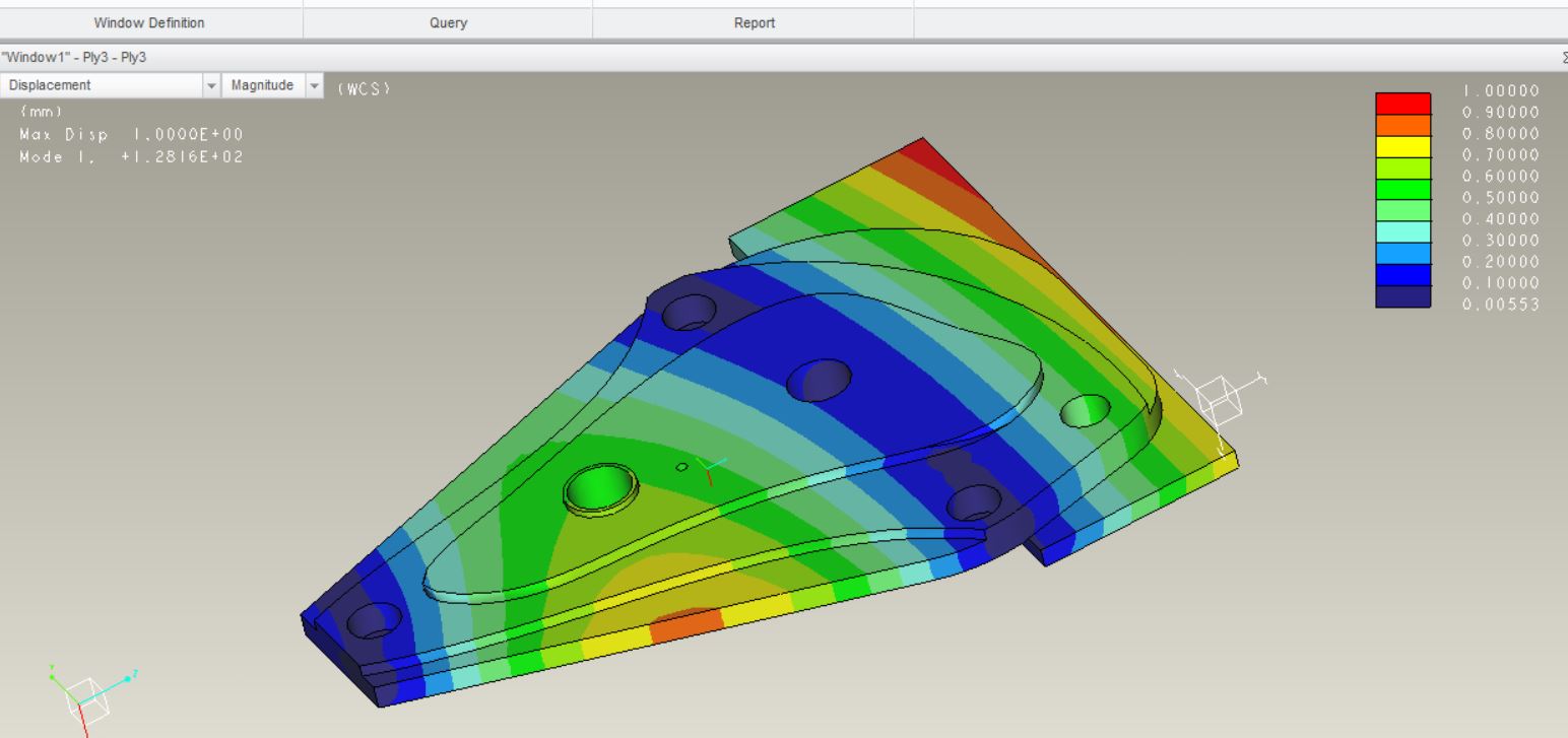

The sub-chassis on the LP12 is a key part of the turntable and I have been giving the design of it a lot of thought and analysis. There are clearly many possible upgrades in the marketplace for this. The Linn Keel seems to have the best reputation so I have used that as benchmark for my design. Its clearly a lot stiffer than the original pressed steel version and there is direct connection between the bearing and tonearm. The Keel costs around 2700GBP to buy which is unbelievable for a piece of aluminium weighing 1.1kgs! I considering buying a milling machine and making my own version of it. That can be done for less than the cost of a buying a Keel from Linn including the machine - how crazy is that?
For my design I aimed to make it as stiff as possible while holding weight to same as the standard item. All aftermarket options seem to be around 1.1kgs. The suspension springs are marginally overloaded as it is, so just adding weight to make the sub chassis stiffer is not possible. It also needs to be something I can make for reasonable effort and cost. What I have ended up with is around twice as stiff as Keel and within 1.1kgs mass. I can make it in the garage with a days work and total cost will be within £30 🙂
I looked at various designs initially using aluminium. My LP12 already has a prototype sub-chassis I made earlier in the year from two sheets of ally spaced apart 8mm. This is quite stiff but can be improved. I looked at birch ply as a material and this immediately seemed far better than any aluminium design. The material is light and comparatively stiff so can be made thicker and hence stiffer. A simple flat 18mm sheet is very stiff and the comparative mode frequency jumps to ~110Hz compared to 91Hz for Keel. The latest version of this I now have takes this as far as I can go within 1.1kgs mass. The first mode frequency is up to 128Hz. Its 24mm thick in the centre area thinning out at the edges. This gives the highest stiffness and I can get in the sub chassis. A standard Linn Rega armboard is used and a steel bush in the centre to allow the bearing to be bolted in. All of the parts will be bolted and bonded together. Images of the FEA simulation are below.
