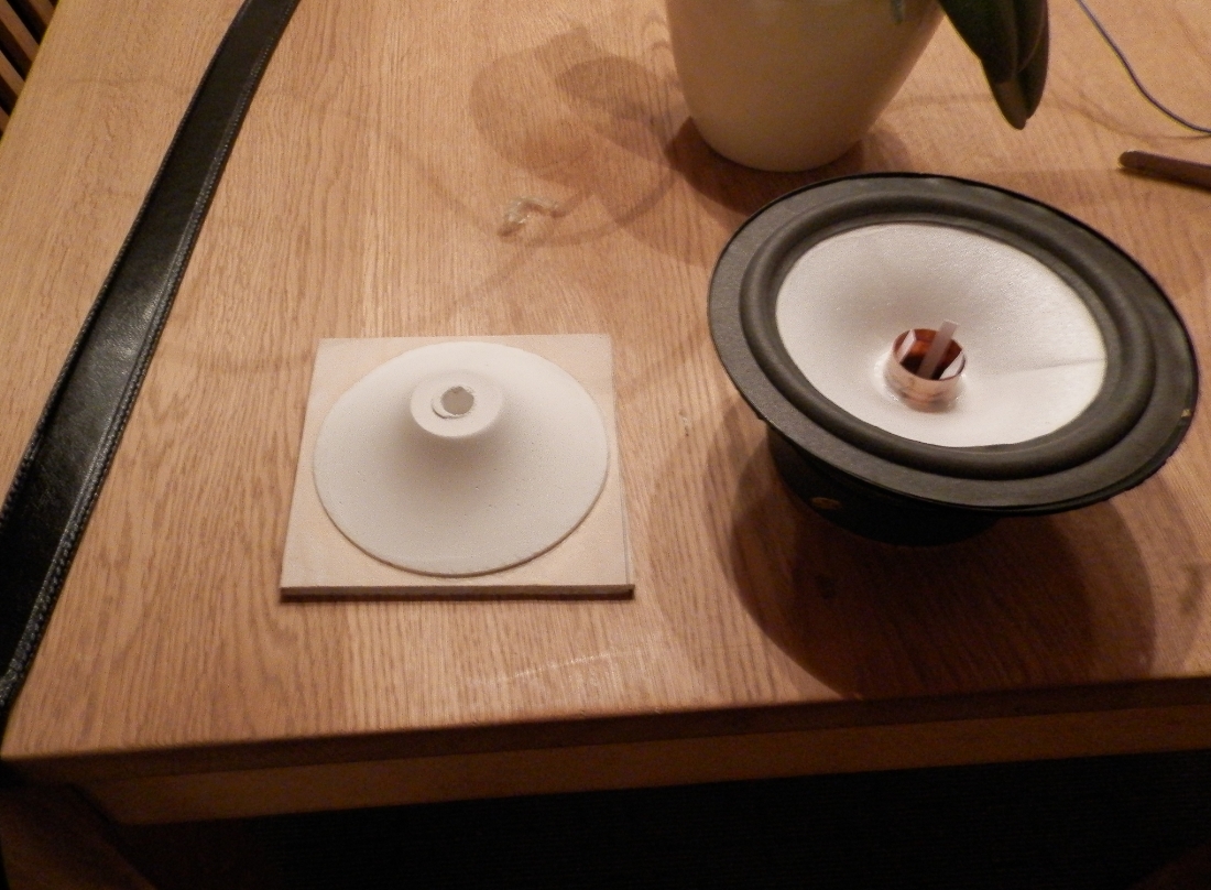

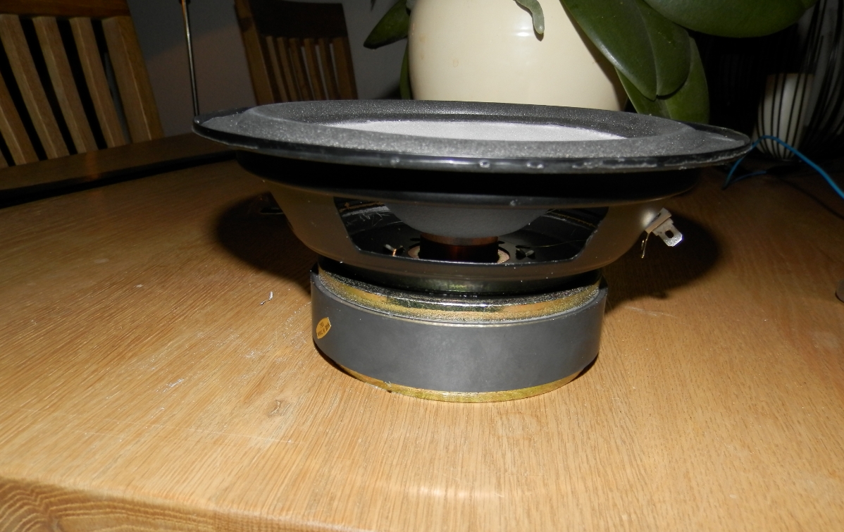

Here is a short update.... Well the systems works but I did not end up with a full range, I would guess it when up to 7-8KHz. I did some research and found that I need a new magnet system and voice coil to expand the frequency response.
Now I am working on a 6,5" full range with a vacuum form Depron membrane. But I have a hard time getting the material for the magnet system, so it will take a while before I any news.
