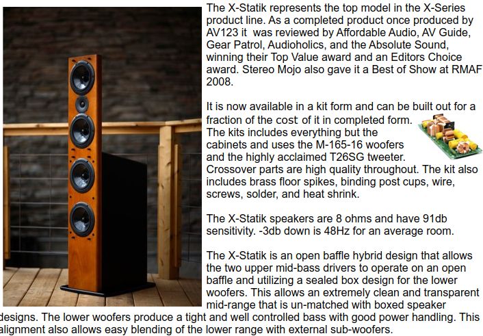

That's a Danny Richie design- meh.

Wolf,
This is a hybrid with an OB MTM on top and a sealed dual woofer on the bottom. It has received excellent reviews, at least on some forums.
Where do you think it comes up short? I'm interested, because it's one of several on my short list to build soon.
Thanks.
Where I think it comes up short is its relationship with Danny Richie, as well as his typical voicing. His stuff tends to not take care of midbass breakup, and therefore the upper mids are a bit shouty. He does not tend to damp or brace the boxes enough either, and therefore the box coloration seeps into the mix.
He's supposedly touted as the 'bee's knees' to audio and 'critically acclaimed/award winning', but I can't see/hear how he is supposed to be that gifted in my experience with his products.
Don't let my bias dissuade you from a purchase if that is what you have your heart set on, as my bias against him likely veils my impressions a bit. His results and voicing are not akin to my MO.

Wolf. Thanks for the input. I’m trying to gather as much information as possible on this speaker in order to decide whether to build it or not.
This particular design apparently was not a product initially offered by Danny Richie at GR Research. There was a company called AV123 that was fairly successful selling this design as a finished product about 10 years ago. There were some issues with the person heading the company and they went out of business. Danny bought up a very large inventory of the components, sans cabinets, and that is what he is selling now as the X-Statik kits.
It seems to be a very good deal. Only $400 for all the drivers and prebuilt crossovers needed to build a pair of these speakers.
I’ve looked at the drawings for the sealed woofer base and it seems well braced, at least to me. The upper MTM is Open Baffle so there is no need for internal bracing of it at all.
Danny appears to have an almost cult like following. It’s hard to determine whether that is good or bad. So, I’m interested in this kit, but still a little wary. Danny also leaves me a little uneasy by pushing his tube connectors and claiming that they improve the sound. There is nothing in electrical engineering theory that can possible support his claim.
Here is link to the review of this speaker from the Absolute Sound in 2009.
AV123 X-Statik Loudspeaker | The Absolute Sound

The M165 and M165X are GR Research drivers, and always have been. I was pretty sure GR and AV123 were connected somehow.

Paul Carmody's Sunflowers hybrid are very similar. OB MTM over an enclosed woofer base that can be either ported or sealed. They also have received very good reviews.
Sunflower [Redux] - undefinition
The X-Statik kit includes prebuilt crossovers, whereas you have to build them yourself for the Sunflowers. Adding the XO parts to the Sunflower drivers looks like it will cost about $100 more than the X-Statik. That's just a guess. Not a detailed pricing exercise.
I have been trying to decide between these two, but still haven't made up my mind. Let me know if you can find a good reason for one over the other.
