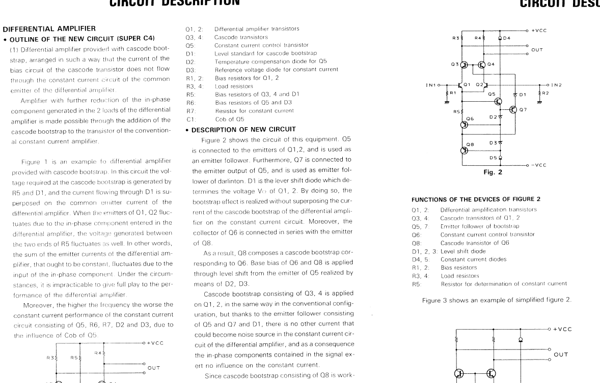

How does a bootstrapped cascode work? I thought that the whole idea of it was that the emitter of the common-base transistor held the collector of the common-emitter transistor at a constant voltage. Do you place a zener diode between one of the emitters at the bases of the cascode transistors? Maybe I should get rid of the cascode, as it doesn't seem to increase the open-loop gain much or the input impedance.

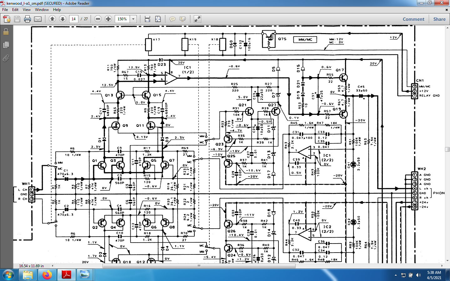

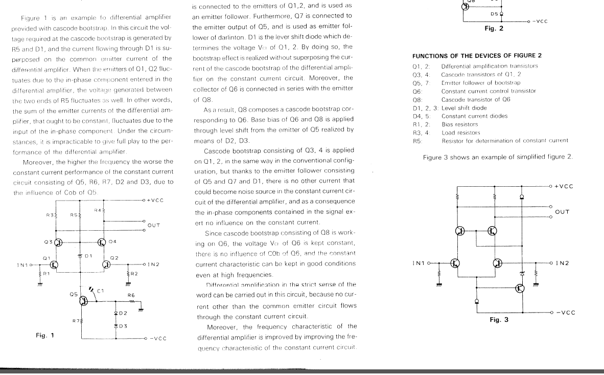

@profdc9
you get all the explanations and even a much more advanced version of biasing a bootstraped cascoded circuit in kenwood l-a1 service manuals.
KENWOOD L-A1 SM Service Manual download, schematics, eeprom, repair info for electronics experts
