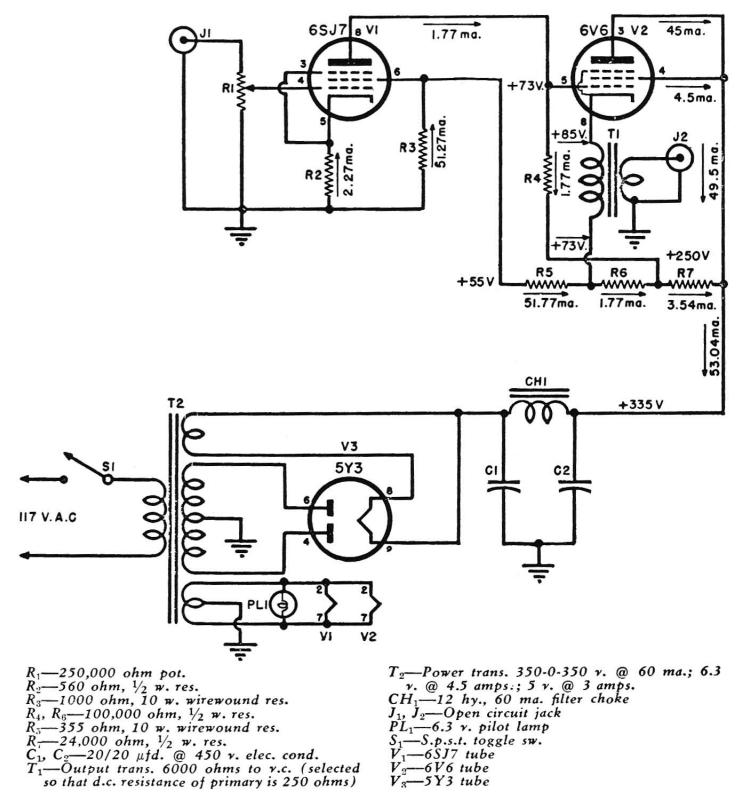

A Direct-Coupled Amplifier with Cathode Follower 6V6
I found this circuit interesting, and thought it may be of interest to some of you. Have any of you built the same or similar?
Thank you Merlinb, the link you provided was helpful. I recieved the schematic from a friend of mine that has since moved away. I had always wanted to build it, but preoccupied with other projects. I will be trying the circuit in the next couple days and will post results:).
