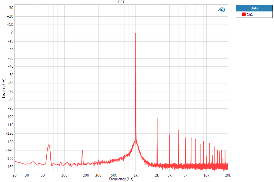

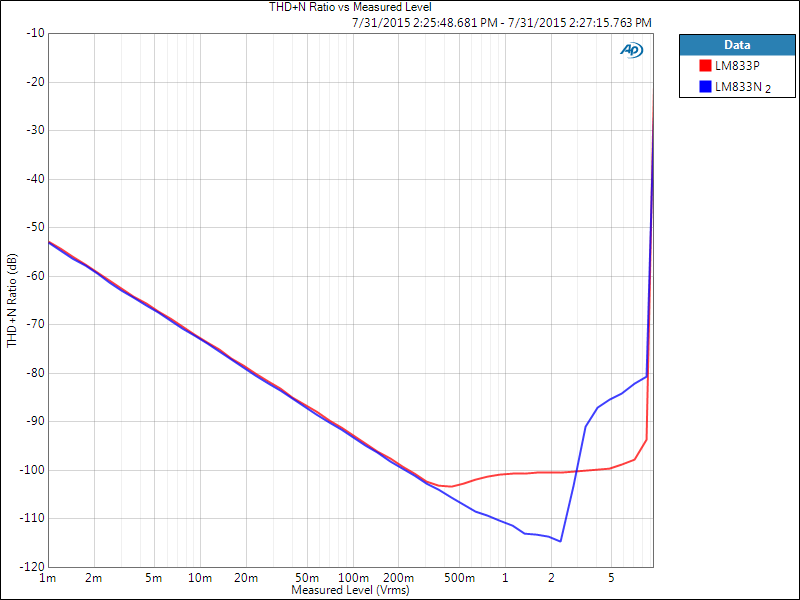

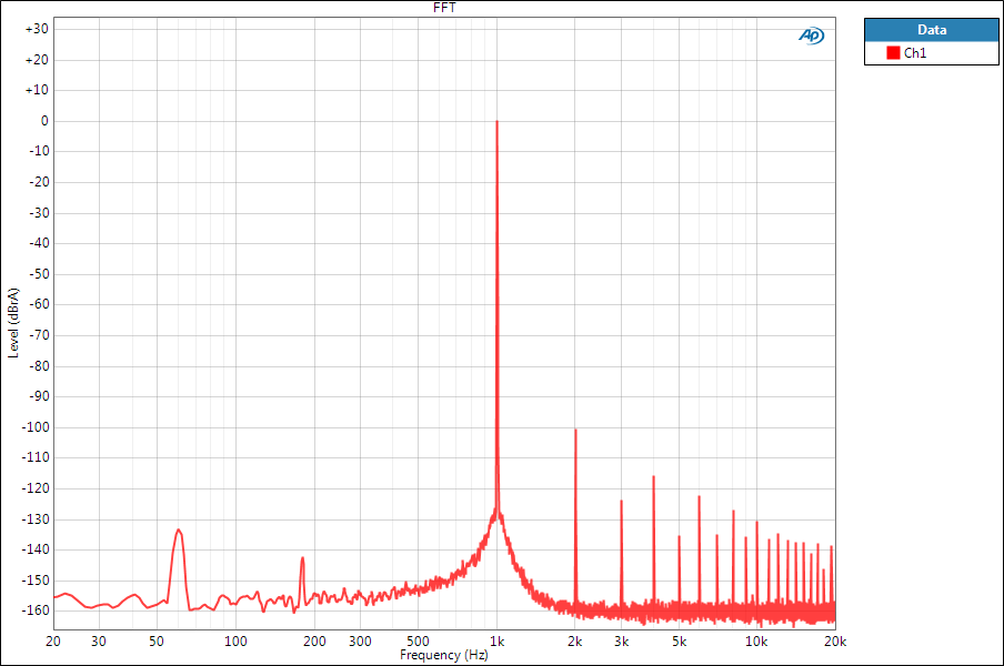

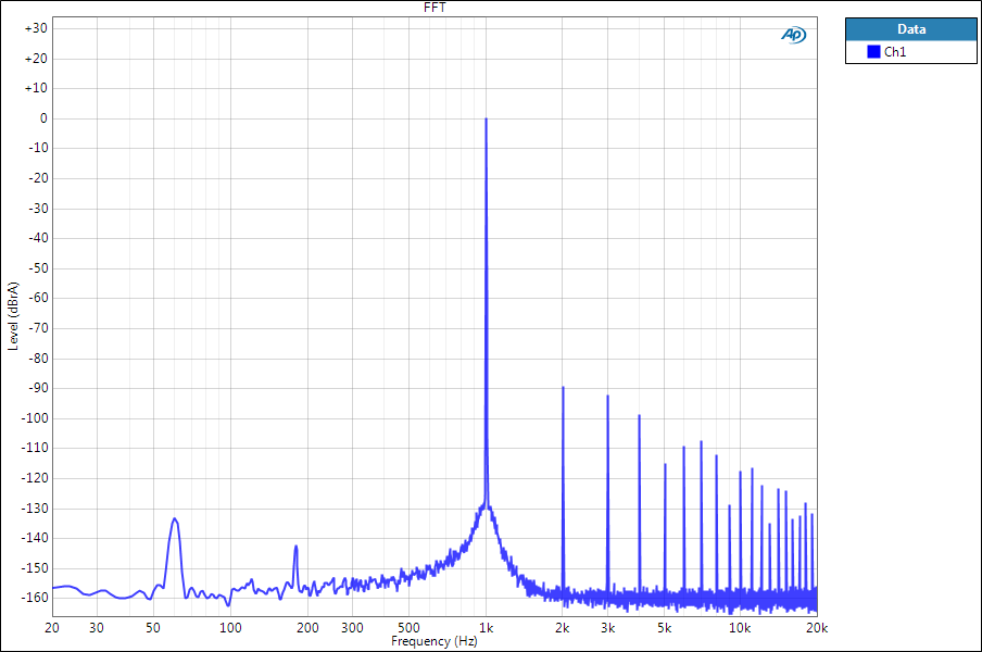

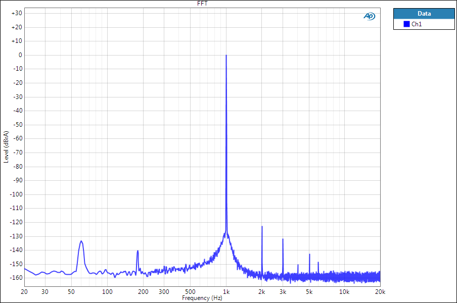

I measured the distortion of both types of LM833 today. The "TI" version will be referred to as LM833P and the "National" version will be LM833N. For testing the parts were configured for unity gain, +/-15V power supplies, and an Audio Precision APx555 was used for testing (measurement bandwidth was 90kHz). To determine differences in the output current capabilities of the parts, a 60o ohm load was placed on the output.
Below about 2Vrms, into a 600 ohm load, the LM833N has the advantage. Looking at the FFT at 1kHz, 2Vrms, the LM833P shows a large amount of higher harmonics which are not present in the LM833N. However, this picture totally changes at higher amplitudes where the LM833N begins to show greater distortion (refer to FFTs at 4Vrms).
In all images:
Blue curve: LM833N
Red curve: LM833P
Edit: The test conditions are given in the image title, so hover your mouse over the image for test conditions.

That's terrific John, thanks very much. The 'P' version certainly seems to have the classic quasi trait of even harmonics predominating in a more obvious manner than the 'N', and particularly I'm looking at the 7th harmonic at 4vrms (isn't the 7th reputed to be the audio nasty one ?)
At lower levels though, which is where most opamps live, the old 'N' does actually seem pretty stellar in comparison. Does the 'P' have the sonic edge though. All very interesting.

re post66, distortion comparisons:
The Ti 833P seems to have a distortion floor at around -100dB irrespective of the output voltage/current. That is until noise obscures the data.
The Nat 833N has a lower distortion when output current is <5.5mApk. Going down to -114dB @ 2.3Vac/5.5mApk, before noise hides relevant data.
Is it correct to assume that the Ti833P is useful when one knows that higher current is the predominant output and in this region of >5.5mApk the distortion results show better performance?
The corollary being that if one knows that output current rarely, or never exceeds 5.5mApk, then the Nat 833N gives the lower distortion.

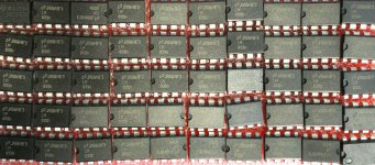

The odd harmonics actually seem to fall relative to the even the harder the LM833P is pushed. These would have made for interesting comparisons in our latest 'listening test' had I had five of the old National versions.
Thanks for offer 🙂, but I don't think I'd use all those in a month of Sundays 😉
