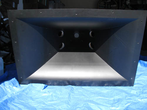

Very nice work and great fit of the woofers into the relatively flat sides...
The band pass injection holes you have a quite large and within close proximity to throat. Do you have data showing effect of the holes relative to factory polars on pristine horn?
You can call me Chris...it's okay. The horn sidewalls are flat at the throat end of this horn--not "relatively flat"...put a steel rule on the throat area and you can see how flat they are.
See the referenced thread linked at post #1. I detected no real issues with directivity/polars, harmonics, phase, or anything else that I have measured relative to the Klipsch anechoic chamber data, posted above, back to the unmodified K-402 horn with compression drivers only--from whence the anechoic data was measured.
I only see a very mild increase in second and third harmonics around the crossover point. It's pretty difficult to hear the 3rd harmonic when it's -43 dB (peak at 462 Hz)...and lower than -50 dB everywhere else, relative to -50 dB for the unmodified horn--corner loaded.

Thanks for the photos and polars.
In other words, it is a conical expansion from the mouth up to the secondary horn break, which transitions to a tractrix curve for the last few inches of the horn.
Polars indicate it works quite well, but the Horizontal and Vertical coverage charts are bizarre, low frequency response exceeding a Saturn V rocket launch, perhaps that should be "phase angle", not "dB" on the vertical axis ;^).
I can take credit for screwing up my own measurements, but not in the two coverage plots above, which I believe was mislabeled as "dB" when it's pretty clear that it's really degrees--but neither is my plot nor my data. I don't see any reason to belittle the plots for that oversight: I'd put the quality of that data up against any that I've seen on this site to date.
The guy that designed the horn says that it isn't conical anywhere, only straight-sided (...he's right...). Check your Beranek or Olson. I try to respect the wishes of the man who did it--Roy D. He knows a lot about the subject. It's not conical. But I'll not argue any further.

I had an issue on mine with 2in dia holes which were subsequently replaced with smaller equivalent of 36mm holes with seven smaller holes.
This is the only posting that I see that's relevant to this topic. I'm still wondering which performance parameters that you've seen that actually suffer. I'd assume that it will be diffraction effects--FR dips/irregularities on-axis, and harmonics at the relevant frequencies on and off axis--and perhaps, in extreme cases and extreme SPLs...directivity issues.
I've measured nothing like that, except the mild increases in 2nd and 3rd harmonics, which was nothing to talk about.
One of the issues that I have with such small ports is port dynamics (sometimes called "chuffing") at very low frequencies, and perhaps under impulsive conditions--like a kick drum or bass drum--close miked. I haven't detected any of those issues.
One of the things that I've found is that you probably need to low pass your crossover settings at the acoustic low pass point of the woofer ports. In my case, that was right where I designed the crossover - 475 Hz. I found that the high pass of the compression driver needed to be extended downward a bit below 475 Hz to cover the center crossover frequency (not unusual in my experience for even non-multiple entry horns), but I attribute that anomaly to port shaping/rounding on the woofer side of the ports, which I didn't optimize: basically I eyeballed the roundover at each port.

528427d1454257369-bookshelf-multi-way-point-source-horn-hole-repiar-success-photo.png
More in the Bookshelf multiway single point source horn thread. Basically, the rather large holes relative to the horn wall surface area caused a 2.5dB reduction in the sound and added dips. I fixed it by installing a 3D printed cover over the compound curved wall shape fitted with seven smaller holes. The fix was measurable and almost restored it to pristine horn wall performance.
Here is data at 30deg off axis - basically beyond the nominal 25deg of this 50deg horn (used in vertical orientation). Red is big holes, blue is the fix, green is holes taped over to simulate pristine horn:
528425d1454257077-bookshelf-multi-way-point-source-horn-sb65-lth142-eq-6thfdw-polar-vertical-big-holes-repair-compare-30deg.png
http://www.diyaudio.com/forums/multi-way/285030-bookshelf-multi-way-point-source-horn-74.html
...Basically, the rather large holes relative to the horn wall surface area caused a 2.5dB reduction in the sound and added dips. I fixed it by installing a 3D printed cover over the compound curved wall shape fitted with seven smaller holes. The fix was measurable and almost restored it to pristine horn wall performance.
Thanks for that. I certainly see your point for your MEH design in your thread. I didn't notice that effect at all in this design although I did do a complete EQ of the assembly after attaching the woofers with their off-axis ports, almost entirely associated with the LF bi-amping channel, since the HF compression driver channel significantly rolls off below 400 Hz. I didn't change the EQ on the HF channel except near the crossover point (475 Hz).
This modification basically was like opening a window for LF production to come through for the current horn since the compression driver was the limiting factor in the benign (axial driver only) case.
