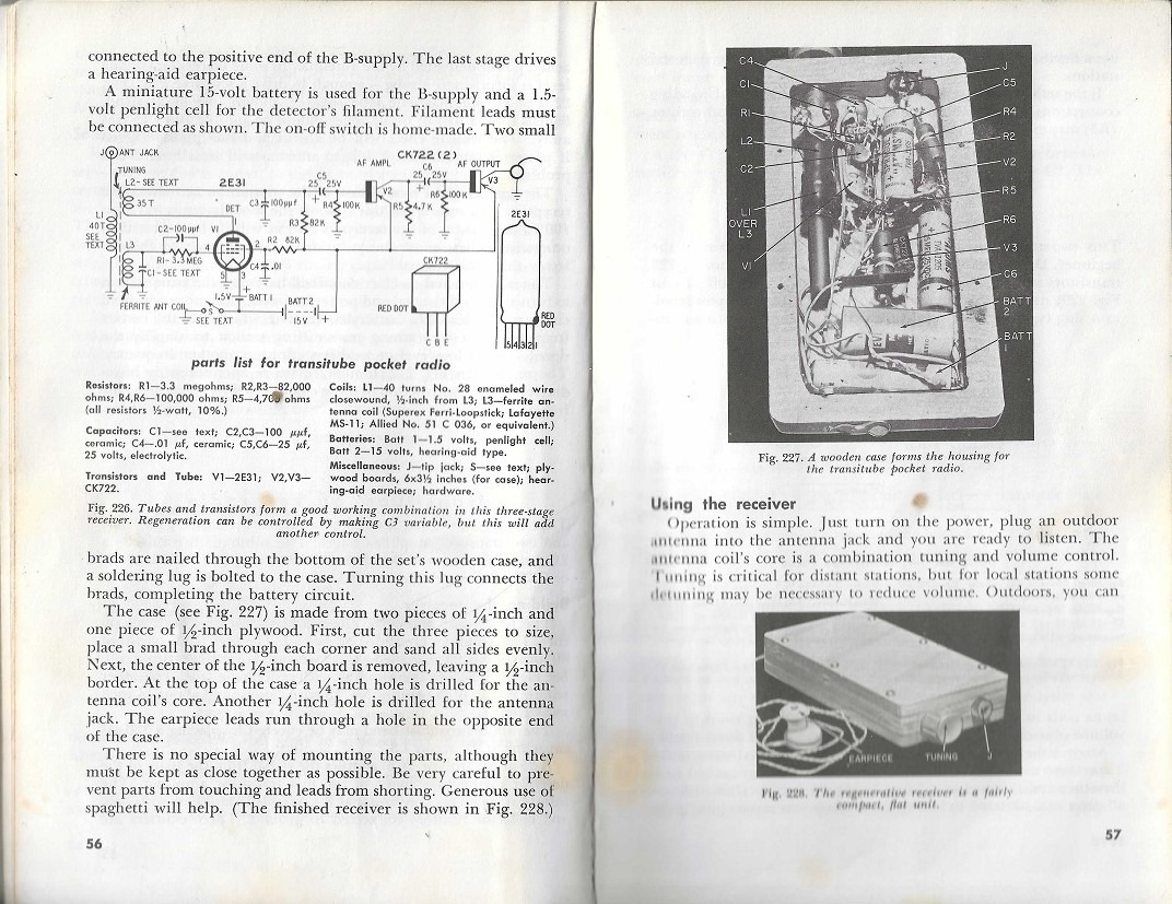

Was into electricity 5-6 yrs old w/ batteries and light bulbs, then tearing apart old radio/tv chassis & learning about different components (& tubes)
Actually started building stuff from book below- probly 12ish yrs old. Of particular interest this forum was the transistor/ tube hybrid project.
Interesting the 2E31 is listed as a 'hearing aid' tube.
